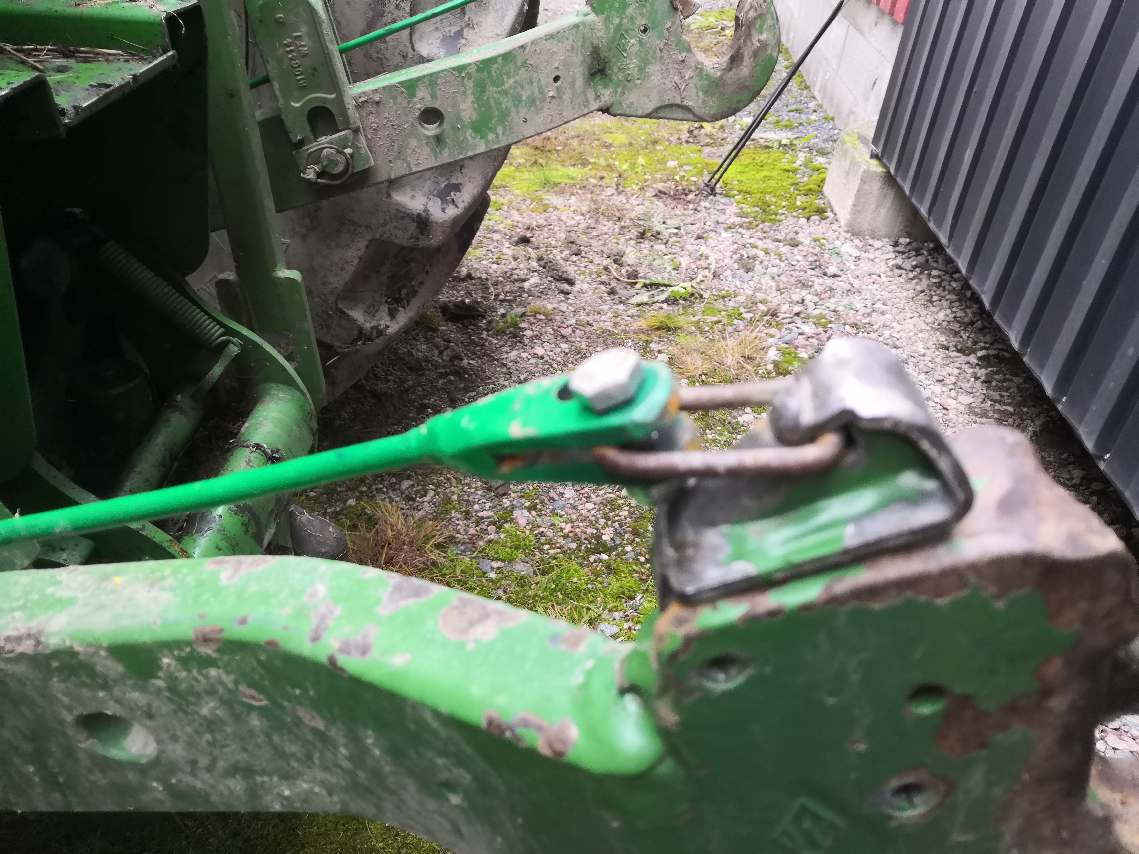

Your Walterscheid hooks should work easy like this.
It is Walterscheid hook. No lifting only pulling
So no small levers needed with them.

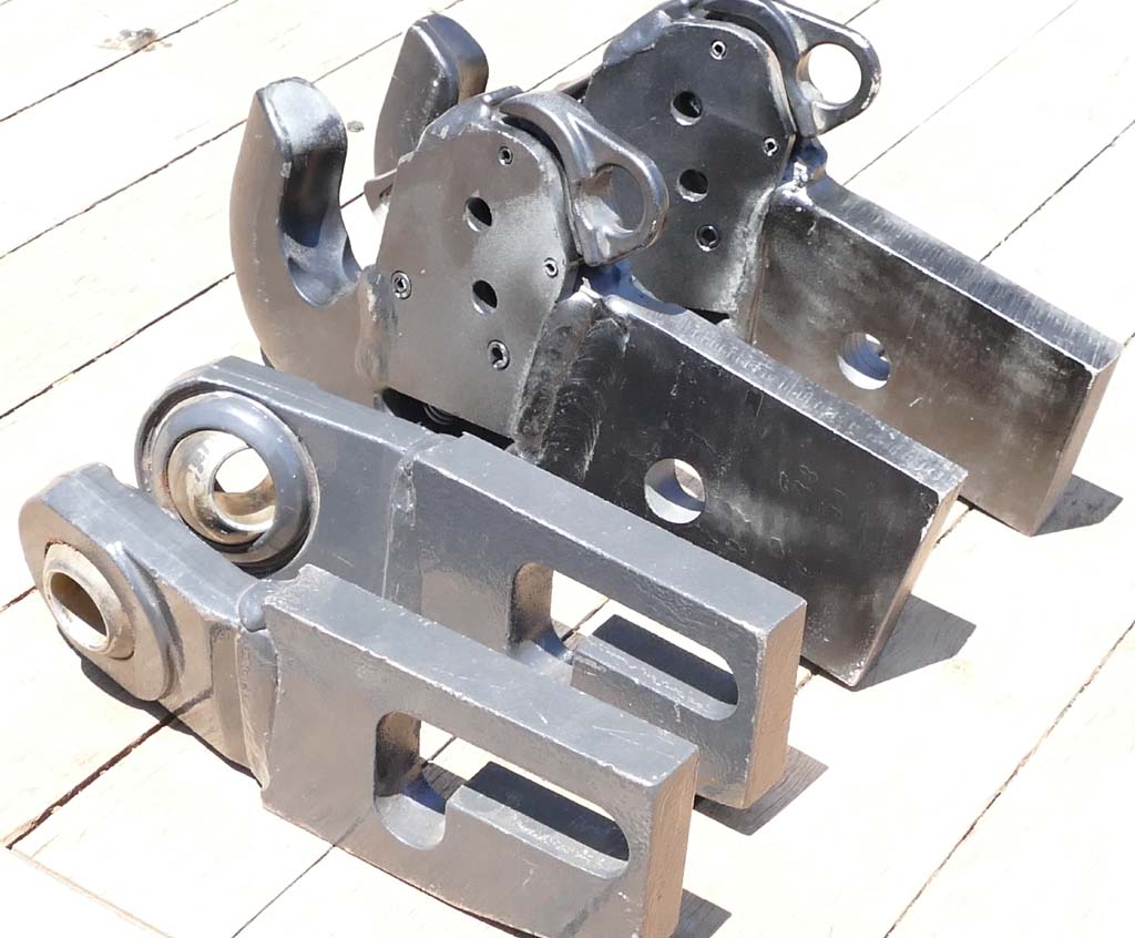

With thanks to MtnViewRanch, I now have a pair of hooks, while retaining the original eye-ball ends, should they be needed down the track. The "light-bulb" moment for me was that with hooks, I didn't need the telescopic action.
It took some care to get the angles correct prior to welding, but now, all good!
   / Kioti RX8030 lower link ends #13
Great job! Look very nice.
If you really want the telescopic action, you could find someone with a milling machine to machine some slots on in.
But then again, not needed with the hooks. My tractor also came with the Cat 1 hooks and never had the need for telescopic ones.
