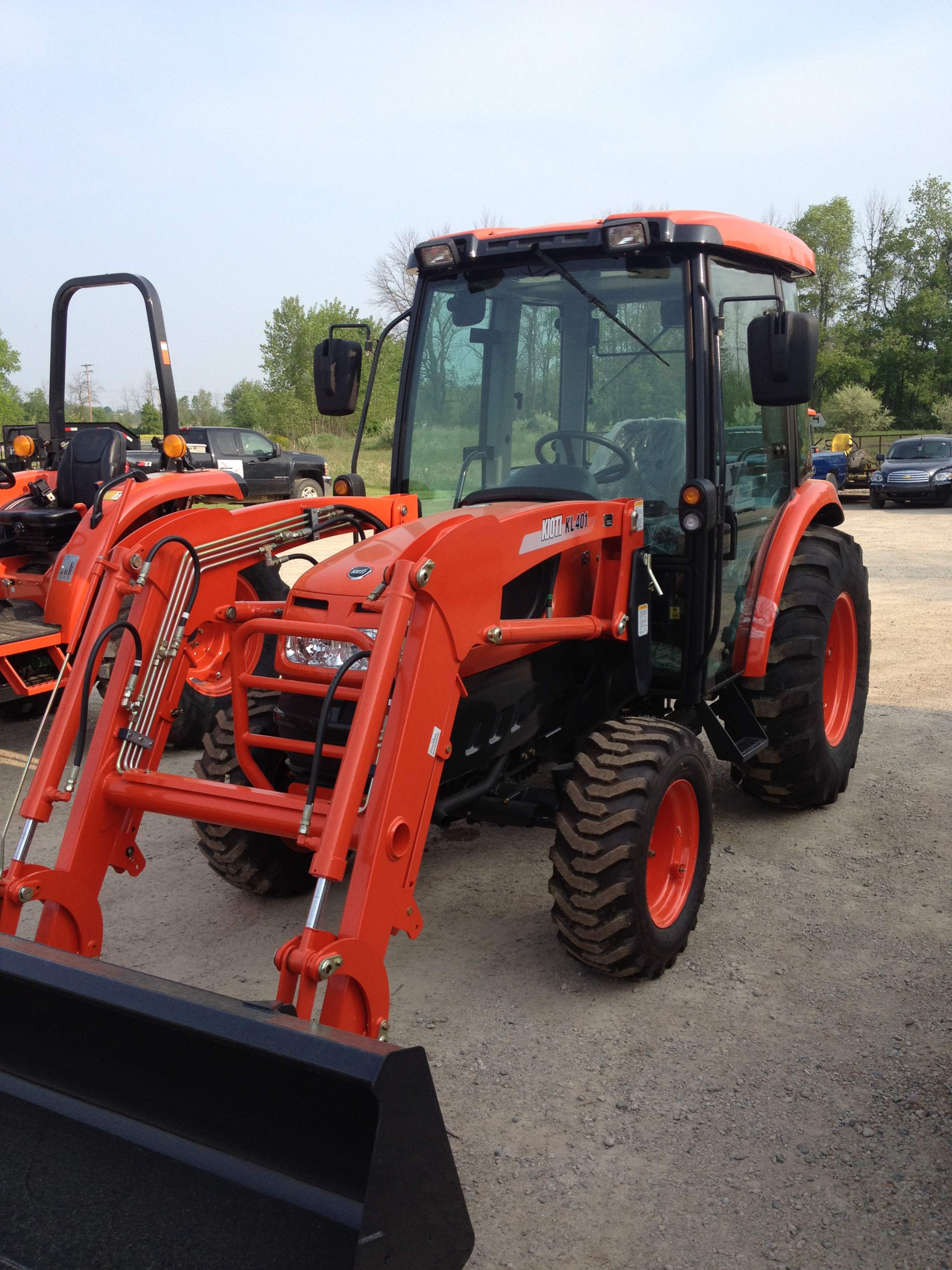

The only issue I'm having with the kioti is the dealer. It's not that I don't like him or he didn't spend any time with me. I just don't know how long he will stay as a kioti dealer. The only other one close to me is 40 miles. And also parts. Will they be available for me 10 years down the road.
I guess you answered your own question.If you are not very comfortable with Kioti as a product or your local Kioti dealer being in business 10 years from now walk away.One has to remember that a good local dealer is very important for sales,service and parts.With saying that I have a great Local Kioti dealer and have owned 2 Kioti DK 40 series tractors since 2007 needless to say both have been flawless tractors.
