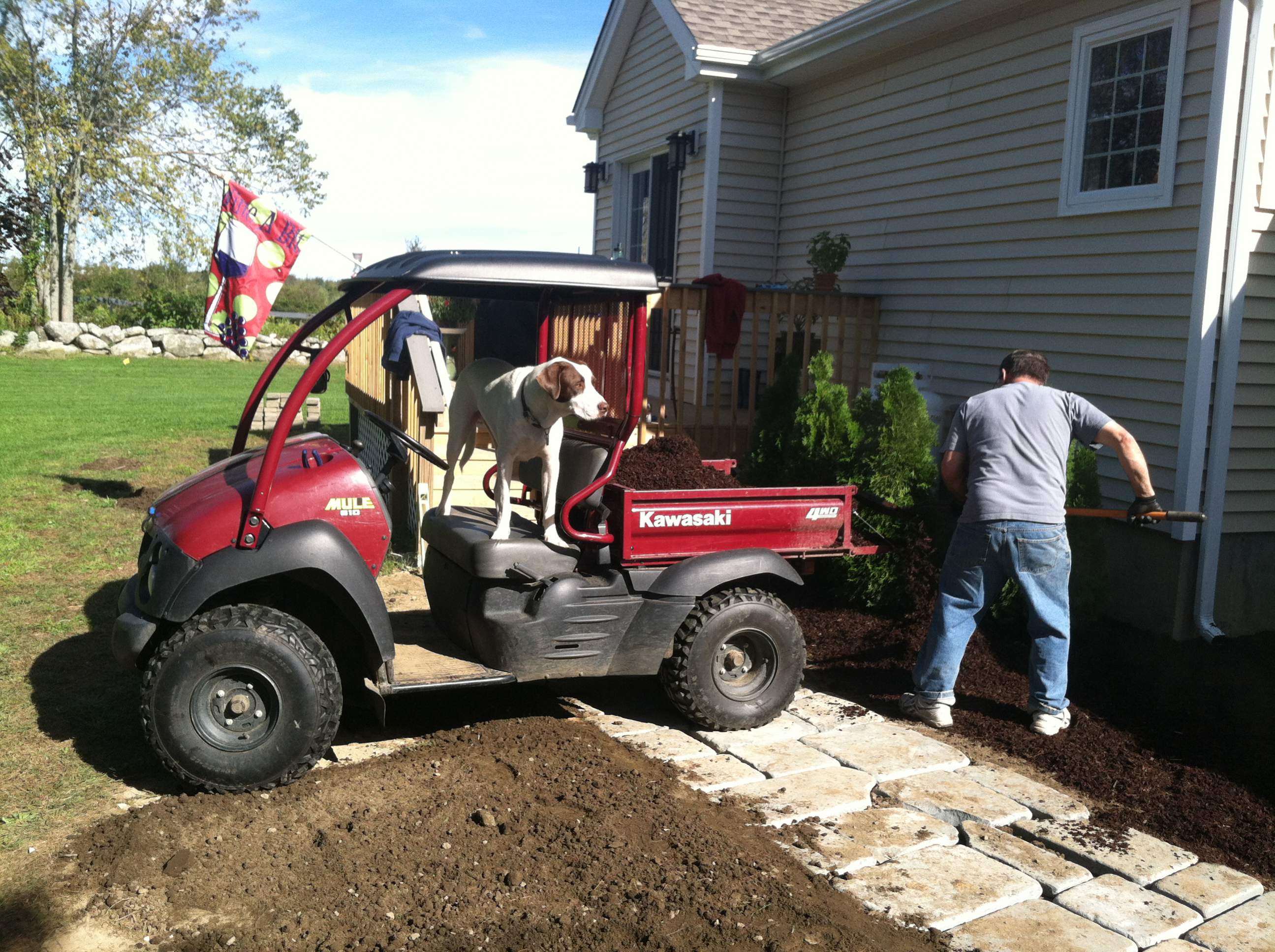

Yeah, we did some big pushes with it. Got it stuck a bunch of times (high up on the snow banks) but just pulled it out and got back to it. Do you remember when you last serviced it? I am thinking we should do an oil change and replace all the filters. I also have to rewire the winch cause our goats chewed the power wire up good, they love to climb on it.
The dog likes it too!

HeY Taco, How did you do that side walk, looks nice . I need to do one.
That was actually my Father-in-Laws project, and he is the one in the pic.
The ground was prepped to a smooth surface. The stones were placed, which took a little while to get them to fit nice. And some sort of sand, maybe dead sand, was poured into the joins and swept around. I am a little worried about frost heave, but the guy who supplied the materials said it wouldn't be an issue. We will see. The material cost was starting to get up there and we have been doing a lot of projects, so my FIL decided to roll the dice. If we have to pull it up next year and place gravel and crushed stone, so be it! The stone is about 2" thick with nice rounded corners. He chipped some pieces away with a stone hammer. He used exactly one pallet, not one stone left over!
