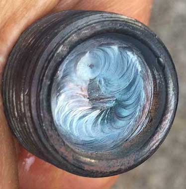

This is great stuff! Why did I wait so long to get the TIG running? Probably because the only other time I tried it was Aluminum, and I had terrible trouble with contamination, and nobody to help me thru it. Was NOT very satisfying. This was a long time ago (before YouTube :D ).
Here's a 1/2" extension bolt welded into a bung. Some fellers can probably tell what caused 'bobble' in the weld.

Well, if it is any consolation, I would have invited you over to try your hand with my little rig, but you are on the other side of the country!

You shouldn't be so stingy with the filler rod. That under cut is going to bite you in the butt one day!:D

Filler rod takes more hands. I was using all I had to hold the torch. Plus there's no inspectors :D

You didn't say what caused that bobble (and the undercut too). It's all there, like an open book, right?
