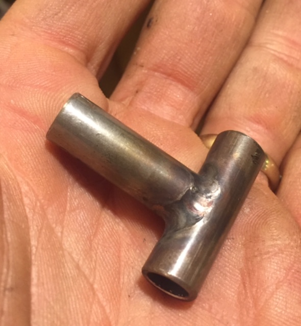

Sodo as SA mentioned, have you tried lift arc? I think your machine has it.
Terry
   / Just got first TIG rig!
#55
Terry you're right MultiMatic200 does have Lift start.
In fact I'm thinking of changing my screen name to "Lift Arc" :D :laughing: :laughing: :laughing: :laughing: :laughing: Wait let me Google that first it kinda sounds like some stage of a deviant reproductive maneuver,,,,
Tried lift start tonite and it is MUCH better! This was pretty darn easy. Its 3/8" stainless steel hydraulic tube, about 18ga. No filler rod. Another problem I'm finding with TIG, I can't see. Need some kind of cheater lens. I haven't yet learned to extinguish the arc by letting up on the footpedal just pull back. Will try to add that in too. This is too much fun. James and Terry, ( & SA ! :thumbsup:) thanks for getting me going on this!

That looks pretty good!:cool: See you're getting the hang of it. Now onto open root pipe welding.:D
   / Just got first TIG rig! #57
That's looking pretty good! +1 on the cheater lens. I can't weld without them.
   / Just got first TIG rig! #58
Wow. Lookin real good, Lift Ar.. Er Sodo!
Cheater lenses are cheap. Buy one of each strength. Try them all at different situations.
( trying to think of some Shield/ Lift witticism but too early so I won't bother :))
Terry
   / Just got first TIG rig! #60
Piece of advise about the cheater lens, dont bother, just go buy some of those cheap reading glasses. I have the cheaters in my hood which means nobody else can weld with it. That sounds good, but whenever I use it, I have to take off my bifocals and set them up out of the way and when I get thru welding, I cant ever find where I laid them.
