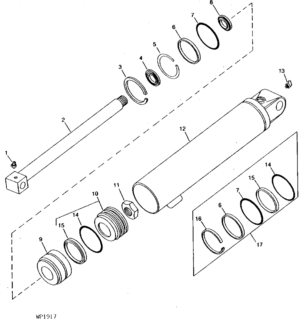

Tonight I will be taking off one of the lift cylinders for my John Deere 148 front end loader. I am putting in a new seal kit tomorrow.
Was wondering if anyone had or knew where I could find an expanded view of the cylinder.

I can't get it now, but you can from www.jdparts.com , it's free to register.there is a quick tutorial linked in my signature if you need help with it. If you can't get it I can held later.

Here:
Lift Cylinder, 148 Loader (044101 - )
Cart key PART NO. PART NAME QTY SERIAL NO. 148 158 168 REMARKS
1 JD7799 Lubrication Fitting 1 X 90°
2 RE26493 Rod 1 X (SUB AH137177 AND AH141141)
3 R90265 Snap Ring 1 X
4 RE24534 Seal 1 X (ALSO ORD AH149194)
5 R86387 Snap Ring 1 X
6 U13461 Back-Up Ring 1 X (SUB FOR R87628)
7 R93633 O-Ring 1 X
8 R81857 Seal 1 X (ALSO ORD AH149194)
9 H157173 Hydr. Cylinder Rod Guide 1 X (SUB FOR R90278)
10 RE29383 Piston 1 X (A)
11 H170536 Nut 1 X (SUB FOR R86386)
12 AH174800 Barrel 1 X (SUB FOR RE26491) (INCL JD7799)
13 JD7799 Lubrication Fitting 1 X 90°
14 U40708 O-Ring 1 X
15 R90237 Ring 1 X
16 R91727 Ring 1 X (B)
17 RE33412 Kit 1 X (ALSO ORD R81857 AND RE24534)
.. AH150040 Hydraulic Cylinder 2 X (SUB AH174797) (SUB FOR RE26490)
(A) Wear rings not for service. Replace complete piston
(B) Used for disassembly and assembly to fill snap ring groove
/ John Deere Cylinder repair
Thanks for the help guys!
As soon as I got my cylinder to the bench this morning I noticed the new seals seamed to be a little small inside diameter. Sure enough, part #16 (A) that Kenny mentioned, was too small which made it extremely hard to get piston out of housing. Once piston was off the rod there was no way the new parts were going to fit on the rod. Called Deere, there is two size lift cylinders. One the same size as bucket cylinder and one bigger. Found a misc seal in bucket at work that fit inside the gland and she is good to go now! Also noticed what May have caused the seal to fail, other than being old hard and brittle, two small burrs few inches from end of rod, will check clearances tonight.
