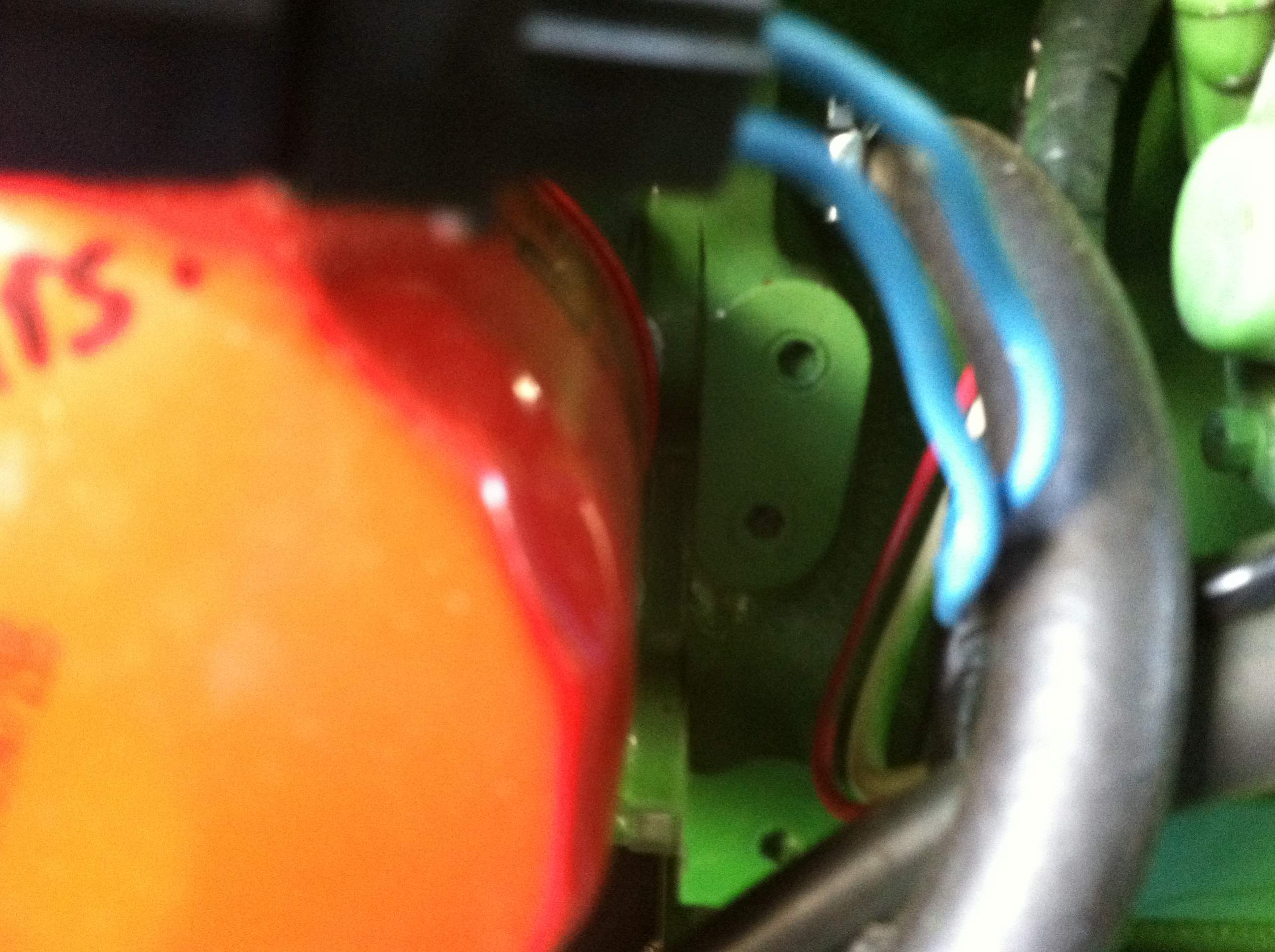

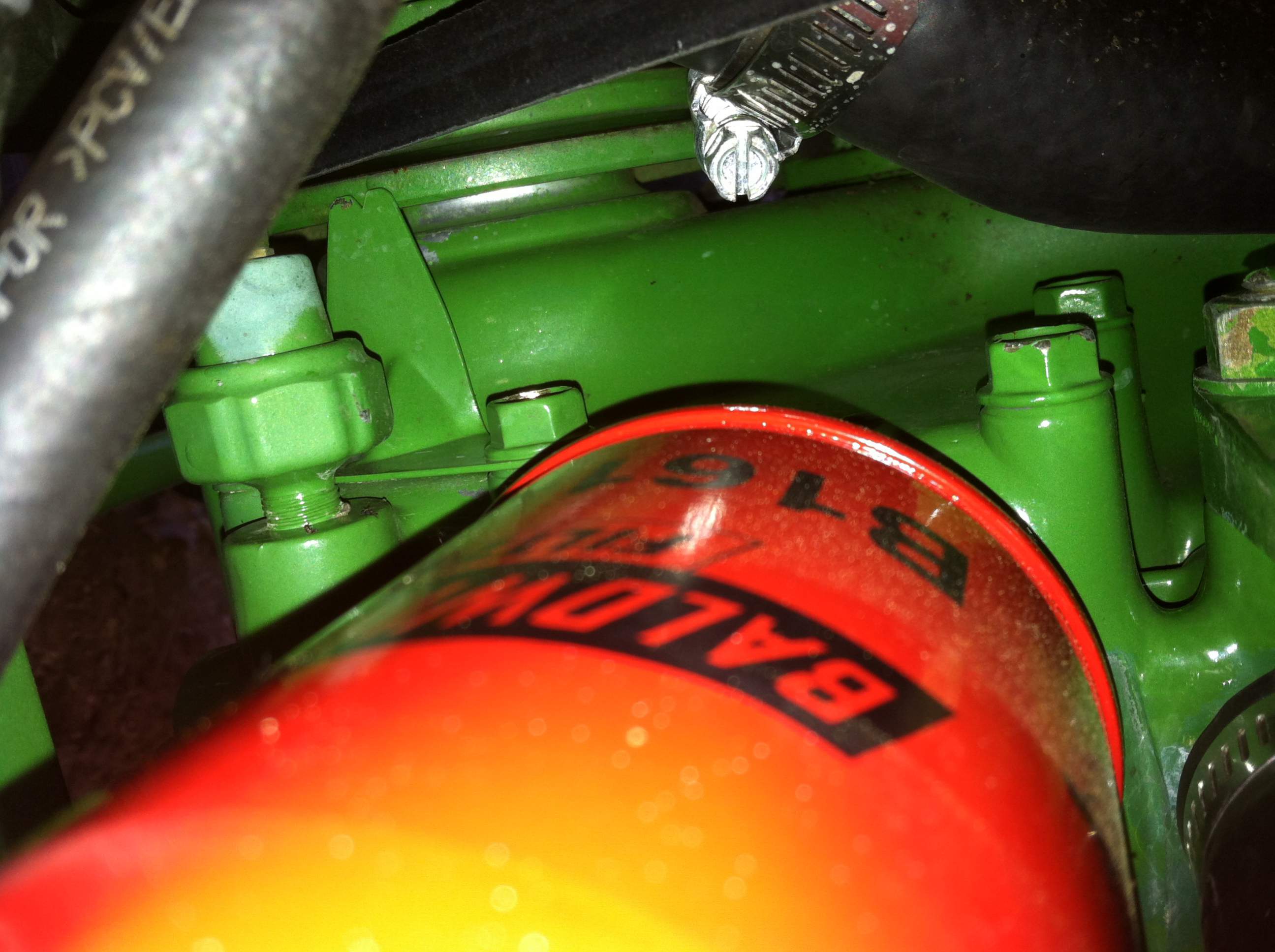

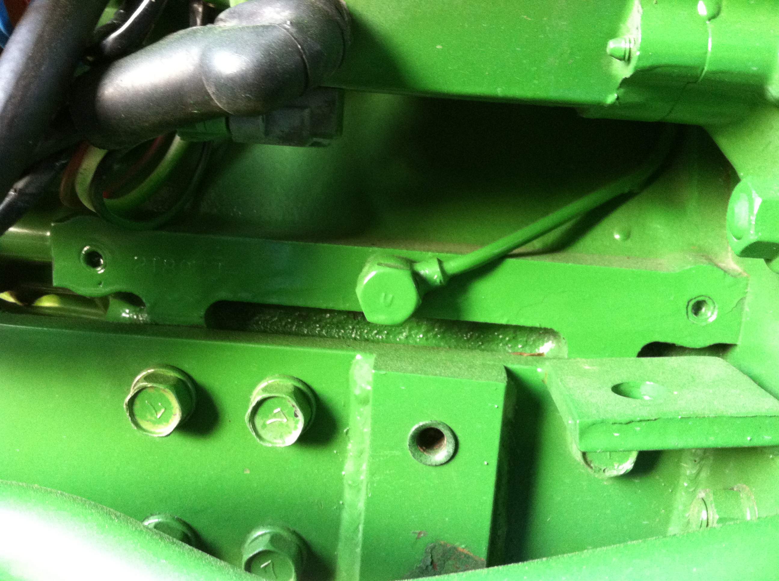

Hello All.I am interested in a manual oil pressure and temp gauge for my 650 CUT.Liquid filled direct engine mount gauges are of peculiar interest to me.Is a t-fitting on the oil pressure switch the best way to go?The tech manual indicates that any of the allen plugs on the left side of the engine could be used.However,they have been in there for 28 years so i can only imagine the horror of trying to remove one of them.The temp sensor location seems to be the only place to locate a gauge sensor.Is there a t-fitting for that?Perhaps someone with a 650 or 750 has tackled this before.Any suggestions would be greatly appreciated.Thanks again!

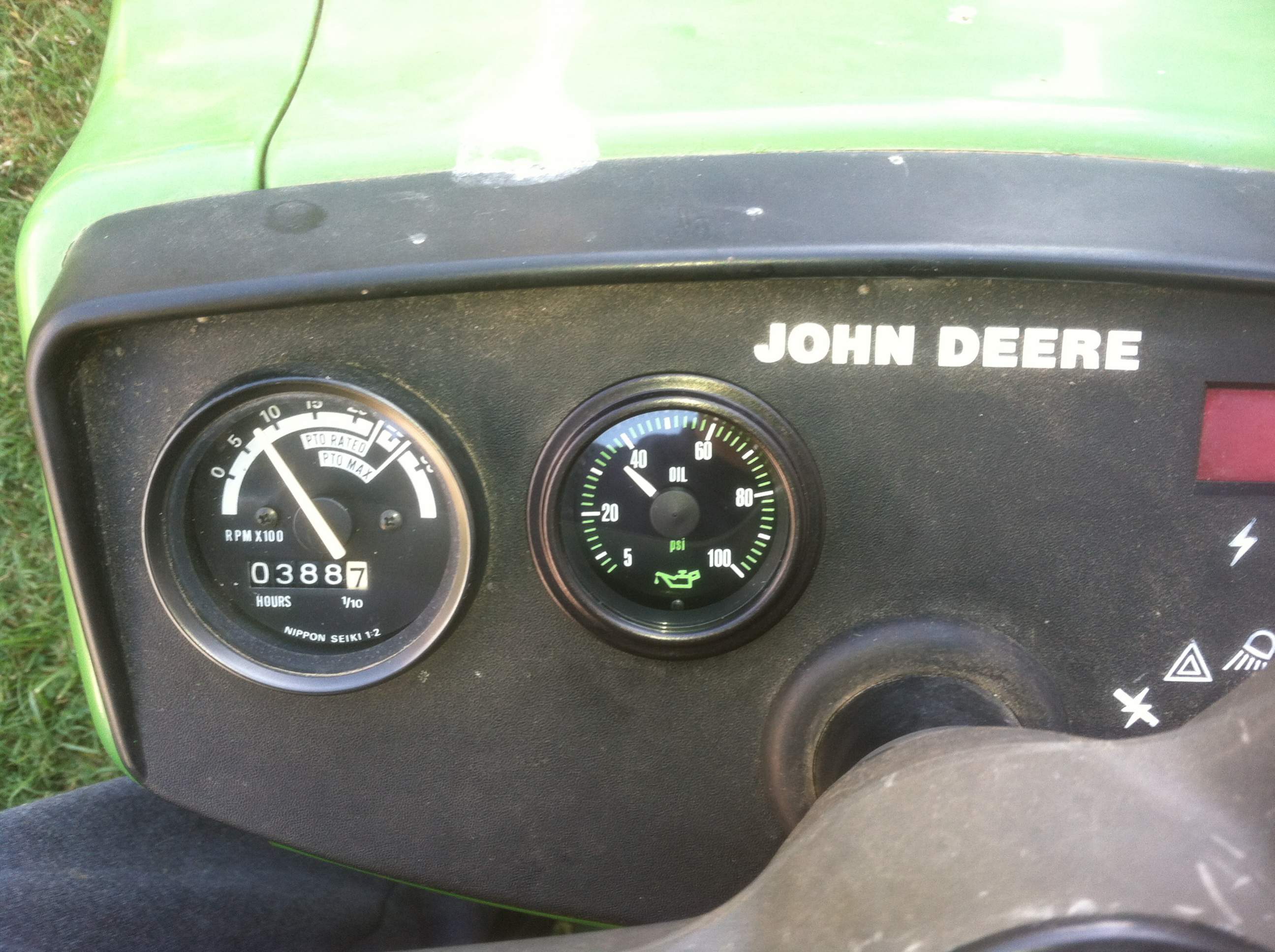

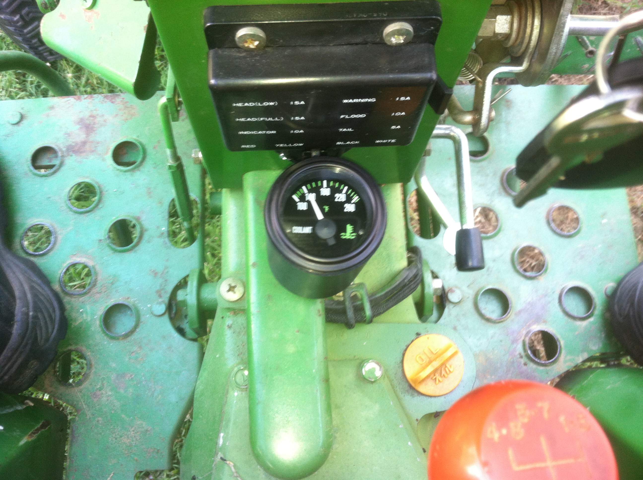

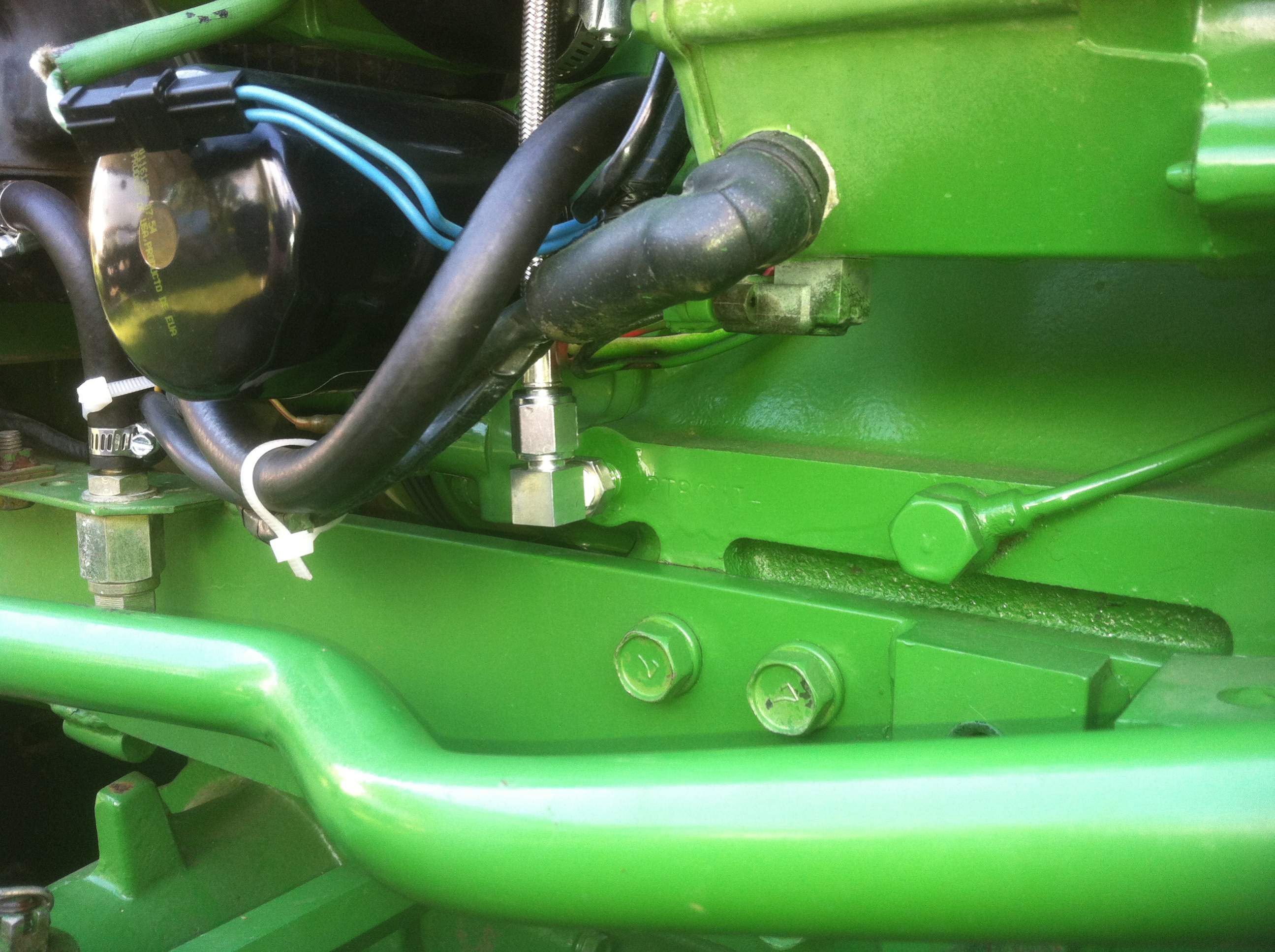

I can't believe i've had these gauges for a year and installed them today.Lol.I'll answer my own post so that it may help someone in the future.The pictures and part numbers tell the story.
Stewart Warner HD+ Temperature Gauge 82355
Stewart Warner sending unit 280ED-F
Pro Pod Gauge Cup 81107
28mm radiator hose sending unit adapter
Stewart Warner HD+ 82372 Oil Pressure Gauge
Pegasus Auto Racing Supplies 3230-2-2NPT (1/8BSP to 1/8NPT adapter)
Jeg's Stainless Braided Hose 41058
