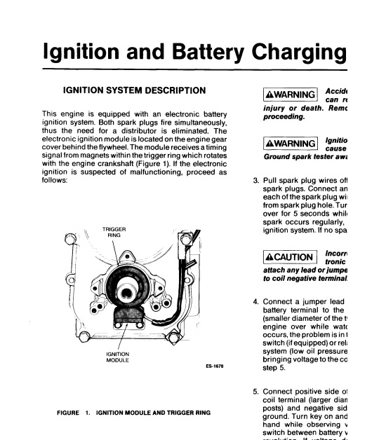

I have no spark. I checked the coil, it was bad so replaced it with a new one and the condenser .
Coil wires, plugs are good. Does not have points.
She is the P220G model
Any suggestions?
   / John Deere 420 no spark #2
Do you have the TM for the tractor? It is most likely the electronic ignition module/trigger ring buried down under the flywheel. There is a way to test the module in the manual.

here it is as an attachment. this way, it won't get lost from a bad link.
  • Onan Service Manual 965-0762_watermarked.pdf
   / John Deere 420 no spark #5
Follow the instructions on this page. See if you can find the problem.
