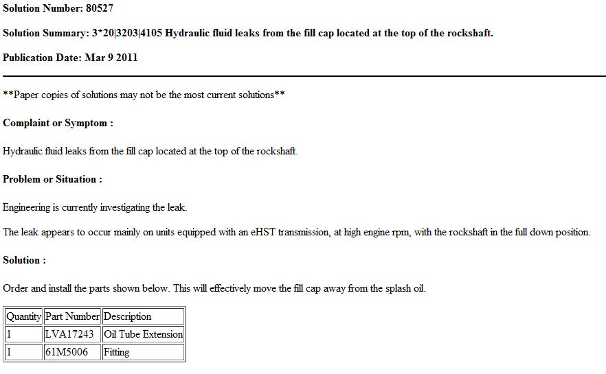

Got to put a few hrs on the 4105 ! WOW !! I LOVE IT !!! its great ! I pused down about 20 ft wide and 50 foot long , tree filled sandy area . Bushes , trees , the 4105 dug it out ! I also learned how to scoop and fill up holes !! My wife got to drive it alot , I would pick up the small roots and throw them in the bucket , then she would go dump it ! Fun day . I am off all week , so working JD HARD !!! The only problem is the yellow " fill knob' above center link , is leaking :confused:. I took it out and flipped O ring around and that made it worse. Buying new O ring Tues . Called dealer , he said its a vent and filler knob . So its ok to vent some ?????? I hope its not going to be a problem . I did cjeck fluids , 3 Xs with 3 being full , its on 2 x . I did work the FEL HARD for HRS !!! maybe I over worked it , and it pushed out some fuild out the VENT in the knob?

I replaced the O ring , and its leaking worse :(. Going to read book and learn how to check fluid on dip stick . Its leaking down both sides and drips on floor :(. I hope I do not have a problem , I hope its just over full ? I did work FEL VERY hard for hrs , I hope I did not mess something up ? Any thoughts ?

Is it leaking around the dipstick or the fill cap? Keep in mind that hyd oil expands when it gets hot.
I found this service bulletin.

coming out of VENT that is made into cap . I just read on some other site , " If you LOWER FEL withOUT engine running it will force fluid out the vent " I have lowered the FEL and 3 pt hitch a few times with engine NOT running . I will never do that again . Going to check fluids on Wed , and clean up mess , then drive it , and see if it still leaks . Also going to call dealer that sold it to me , to see if he can give me in help . I am out of town , so can not just drop by dealer ( 5 mins from house ) . I also read that a air leak could force it to leak ? I have some work to do , so I have to use it !!!! I guess I'll keep using it and keep it full of fluid , and let it leak :(

You may have been composing your reply while I was searching for service bulletins. Please see my previous post. It may give you some peace of mind.
   / John Deere 4105 #8
Good job!!!
Goochy, print out a copy of that bulletin...good possibility your dealer won't know a thing about it!
