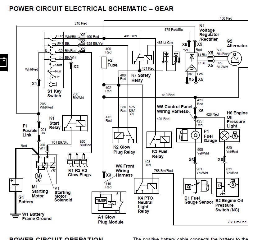

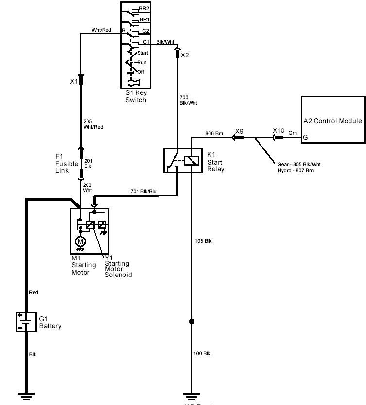

rdmmo
No schematic to follow?
You do not have the service tech manual then?
Maybe I missed something, but think you should run down the schematics for the electrics for your 4100.
I'd like to think I could follow along with what is (and is not) happening, but not clicking well in my mind.
A couple schematics that I can offer, but don't know if they are of any help. If more, then I would be glad to look for more in the service tech manual that covers the 4100.

As part of your trouble shooting, consider examine both A1 and A2 (control, modules A1 listed as glow plug timer and A2 as generic control module); they are basically circuit boards which integrate various safety/ switch inputs. Is possible to over temp and short out traces/ leads. Use the sniff test first, sometimes can pick up the smell of something like burning brake linings. Also possible to remove covers and inspect A1 board on the 4110 series. (Looks like Deere combined the A1 and A2 functions into one board on the 4110/4115 series). Good luck.
