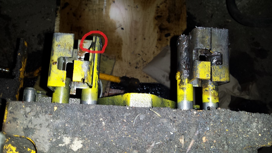

Ok I had a chance to split my backhoe and I'm going to take a look at the clutch packs but after I split it I notice the end of the gear shifter shaft has a peace broke off the notch where the shifter goes in would this stop the backhoe from moving forward or do you still think it's the forward clutch pack.
Here is a couple pictures so you can see what I'm talking about.
   / john deere 410 backhoe barely moves forward but moves in reverse ok #17
Broken tab on shift rail might keep trans from shifting into high range but tractor should still move fwd in low range if fwd clutch pack is operating correctly. I've seen several of those tabs broken off. Some have been welded back in place.

Thanks for your reply Jim
That is what I was thinking that it should still move forward in high or low at least one of them but it hardly move in forward with throttle wide open but it will move in reverse I think it's still the forward clutch pack but I thought I would put this up here just to make sure before take the clutch packs out and spend my money on new clutch packs.

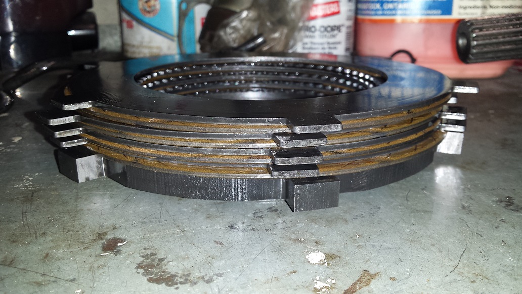

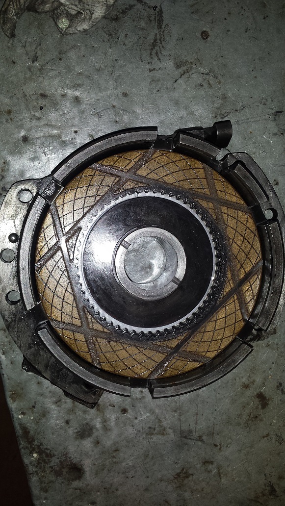

Well I got the clutch packs out today and the reverse pack isn't to bad but I will still probable change them because I have them out.
I took the Forward clutch pack out and it is bad' 2 clutch pad are burnt up and the 3 one is all most gone and the plates & big washers are burnt and warped.
