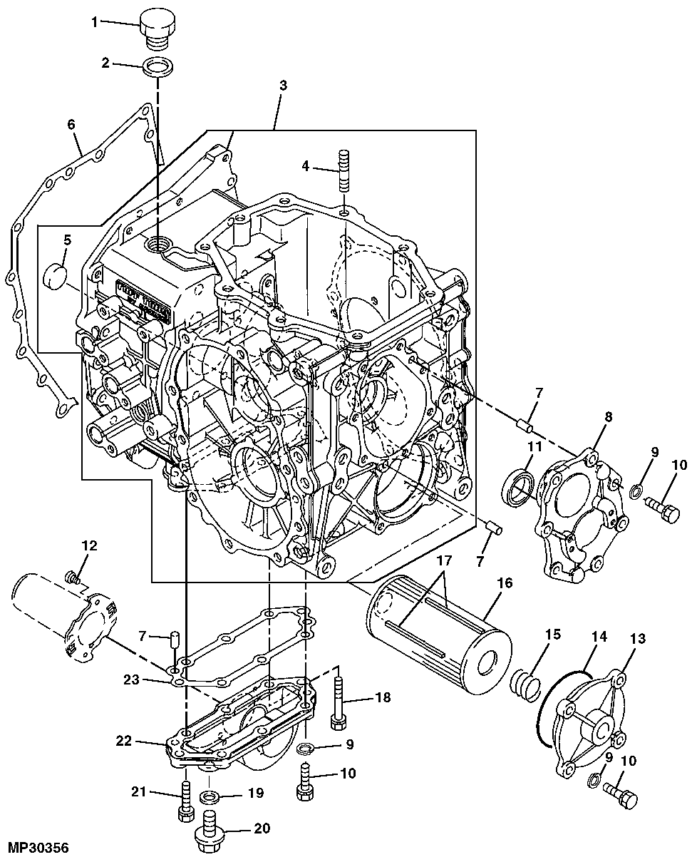

My front loader and my 3 point hitch will not lift as heavy a load as it used to; I hear a strain like a clutch slipping, etc. Any ideas as what to check? This
is my first tractor and this one has really saved my back, as I am older than dirt. Thanks.

On my CUT, front loader won't life a load as high as it used to and my boom on the rear won't lift the same weight that it used to. thanks

If your hearing a "whine" it could be that your hydraulic system is restricted. This could be caused by ;
A clogged or restricted hydraulic filter
Worn fluid
Worn hydraulic pump
A loader control valve is not opening all the way
Or other causes. This is my personal opinion but how do you know your loader won't lift the amount of weight it used to? What do you normally lift? Hay bales, dirt? Engines ?
How long since hyd filter was changed?? I would also suggest to take a hyd pressure reading.
