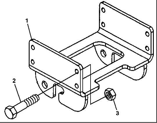

I wondered if you have the part number for the front hanger on your tractor?
Does your front hanger have one set of slots and two sets of holes or one set of slots and one set of holes?
I think my problem is in the front hanger. The reasons for the two previous questions are that my front hanger works perfect for my mid-mount mower but does not work for the quick hitch bracket for the blade. My dealer and Deere keep telling me these are the correct parts. A dealer has even been to my house and he couldn't install the blade either.
Do you by any chance have a picture of your front hanger?
Thanks again
KAPowell

Hi, KAPowell.
I have attached a diagram of the part you need. It is part number AM134116, "Bracket" for the independent front hitch for the 4010/4110/4115. I assume your dealer can order the part separately from the kit. If your dealer need a reference to the kit number for the independent front hitch, the whole kit-and-kaboodle is listed as part BM18644.
I will also post a diagram to follow of what I think you and your dealer are looking at.

If your dealer is trying to make the front hitch work with the 4010's "Front Hanger" it will never work. I beleive this is the part that is used properly with your mower deck. It is part number LVA12164 and was probably ordered as a component of your mower deck attaching parts. The deck hanger is compatible with the loader. The independent hitch bracket is not compatible with mower or loader. Here's the hanger:
