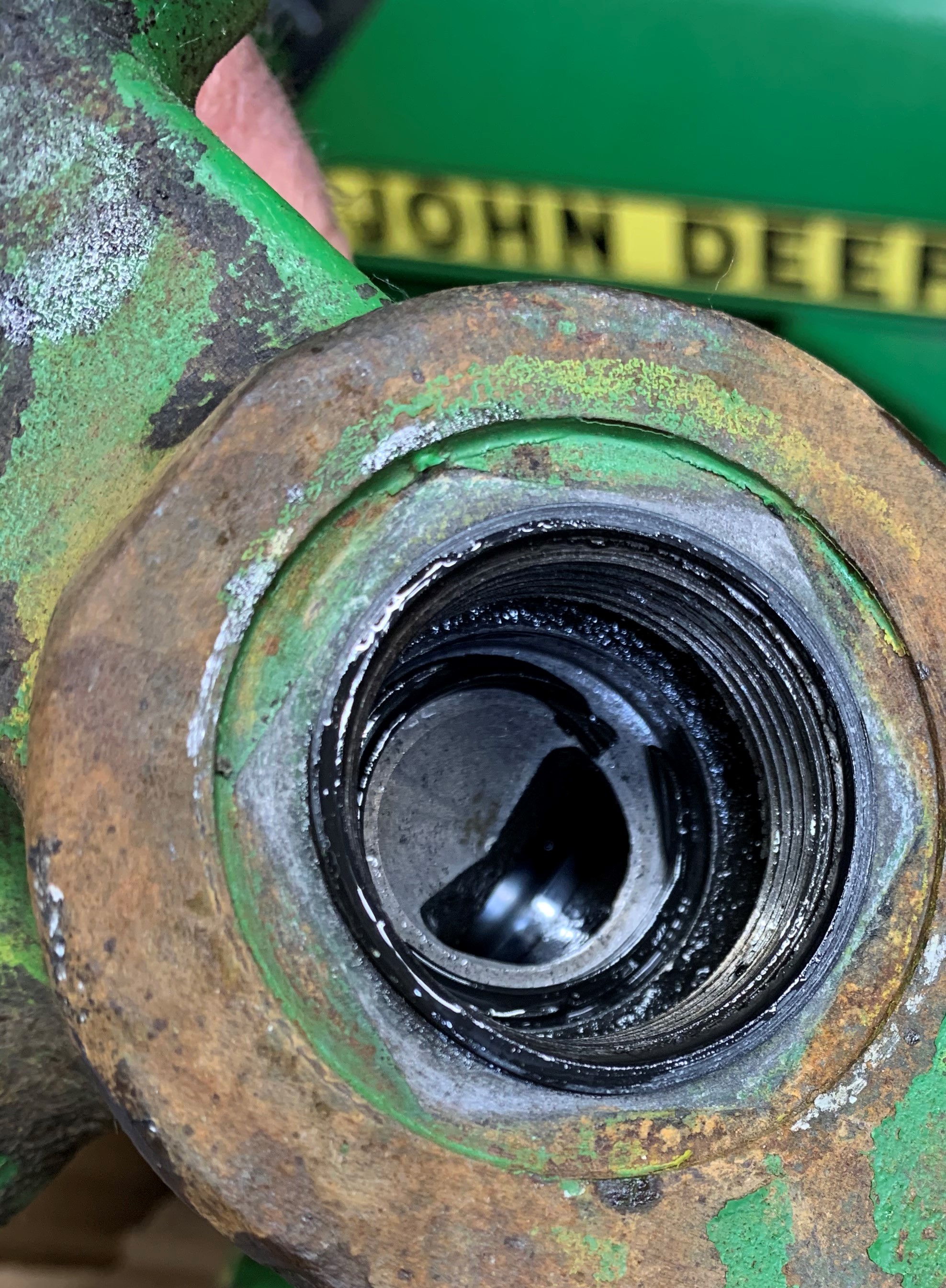

Due to the fact that the contents of the parts under the plugs don't appear to be adjustable relief valves or Closed-center plug my guess is spool to housing clearance is too great & spools & valve housing will require replacing to stop oil from exiting open control valve return hose.
What is your opinion Zebrafive???""
I agree. Only other idea is a spool(s) is/are not centered

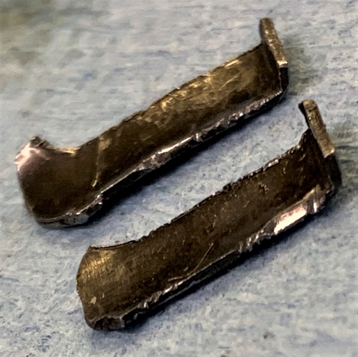

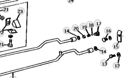

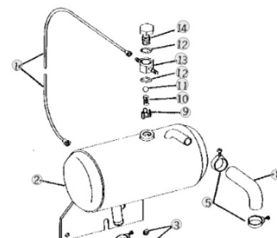

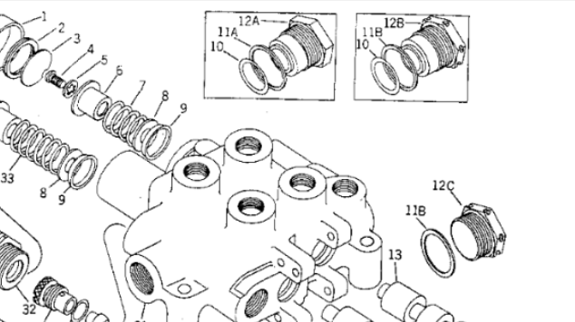

Ohio, Just wanted to add a couple of things. First, at cranking speed you won't see a gallon or gallon and a half flow from filter housing. Should be close to that at 1000 rpm running. Second, have you looked at the filter relief valve? That is behind the 1 1/4" plug just above the filter cup. Make sure the spool in there is not stuck open. On you loader valve, there is another large plug in the side of the valve body that has a oring inside that is known to blow out on occasion. It is the plug that converts the valve from open to closed center. If you are getting a lot of flow from return, I am suspecting that oring is blown. See #10 in diagram. Lastly, in TxJim's diagram of the main pump, I believe your debris is from a broken #52. There is also a similar part in top plug of hydraulic reservoir #9 in front of radiator and in oil line #20 that plugs in front of clutch housing that leads up front towards the hydraulic pump. 48 loader valve.PNG

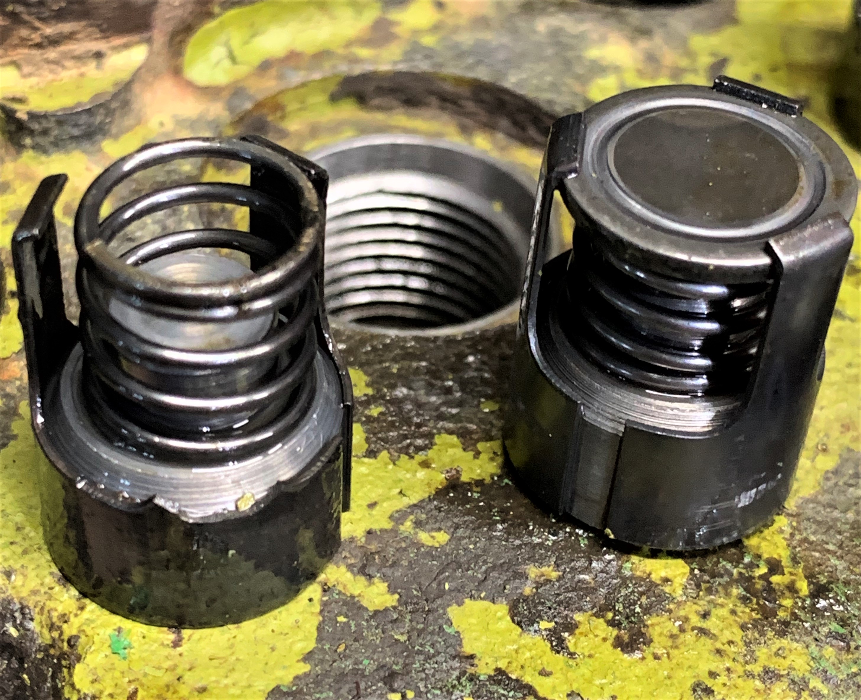

JD110, thank you for the information. I hope to get some time today and look further. Those fragments sure look to be that part. Greasen loader 2712 valve AO 6.jpg

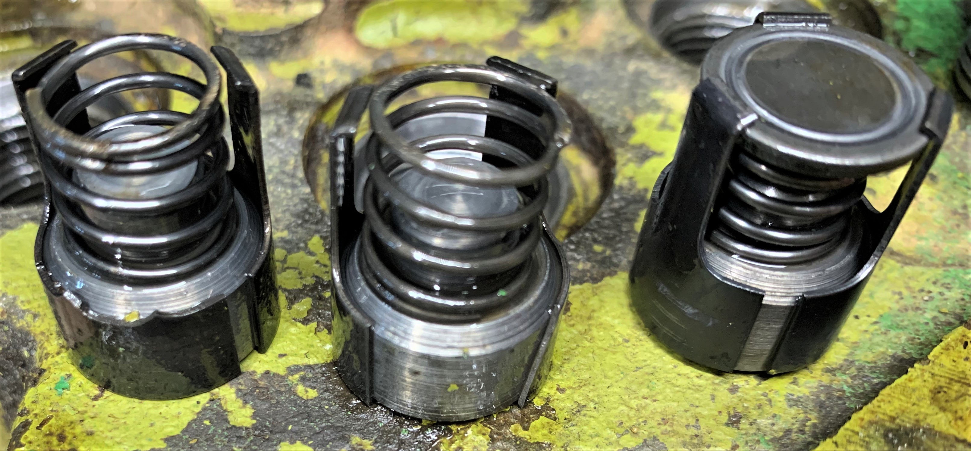

Update- Work has kept me from getting much done. As suspected I discover the hydraulic pump became a cannibal and digested a lot of parts. I have a local shop that can reasonably rebuild and bench test. I'll keep you posted. This is also a good time to have the radiator flushed and rebuild the water pump. My grandson enjoys watching YouTube video's of John Deere tractors. pump valves 3.jpgpump valves 1.jpgpump valves.jpg

Have you checked parts; key 9 in the first drawing, and key 20, in the second drawing, of post #25?
   / John Deere 2020 hydraulic problems
#30
Zebra, I sure did late yesterday. The oil reservoir check was ok. The FEL control had a blown O-Ring as you suspected. Thanks for the tip. FEL o ring.jpg
