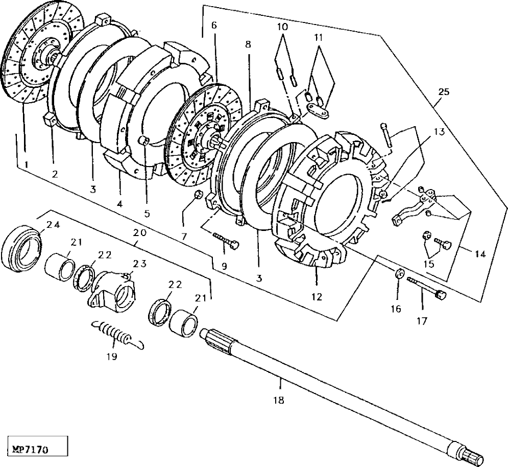

has anyone replace a clutch on a Deere 1070. its a daul stage clutch. i have never replaced a daul clutch before. looking at the parts diagram on the deere web site, looks pretty complex. should i have to replace the whole assembely or can i just replace the pressure plates and bearings. or do i have to split the tractor before i order anything.
also who make the best aftermarket clutches and where can i get them.
thanks in advance.

Since you have an illustration, I'm assuming you have the manual.
It's not a happy thing, but you will be better off splitting the tractor to determine what you need to replace.
Once you have it split, you can determine if salvaging any parts is worth splitting the tractor again if they should fail.

A job like this depends on your temperment if you do it yourself. I did it once. I used to build engines and granted, they were mostlly out of cars but still, I am no stranger to wrenches.
I'd rather stick my head in a badger den than to have to split a tractor but that's just me as I have been known to throw a wrench or two.
There are people on this forum (DKrug for one) that can do a job like this as easily as they can take a nap. So with advice as to starting a job like this, get a handle on the type of person giving it.
