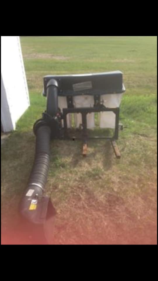

I am in need of a material bagger for my 1025r. I found a used JD bagger that has 3PH mounting as well as a couple bars for a different mounting setup. For this bagger to work for me I've got to keep the 3PH up but drop my mower deck to mow. Below are some pictures of the bagger. Any ideas on how to do this? Looks like I could put a bar of some sort through the top link mount so the arms hit it when the drop and it stays up? Anyone done this? Any better ideas?

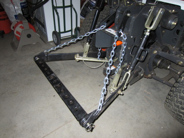

Use a system like these chains going to the top link mount like you mentioned.

Here is where I bought my stay chains:
Mower Deck Stabilizer Kit
Ranchex also sells stay chains.
The nice thing about these chains, it triangulates the 3pt so you have no swinging of the load.

Will check chains allow the mower deck to lower as well as keeping the 3pt up?
I don’t think so, but the independent lift will.

Thanks for all the replies. I've learned an independent lift will be required or get something fab'd for the other mounts that it has. For anyone else that may be looking to keep the 3PH up and mower deck down if you stop the 3PH from dropping its attached to the mower lift so it stops that as well.
