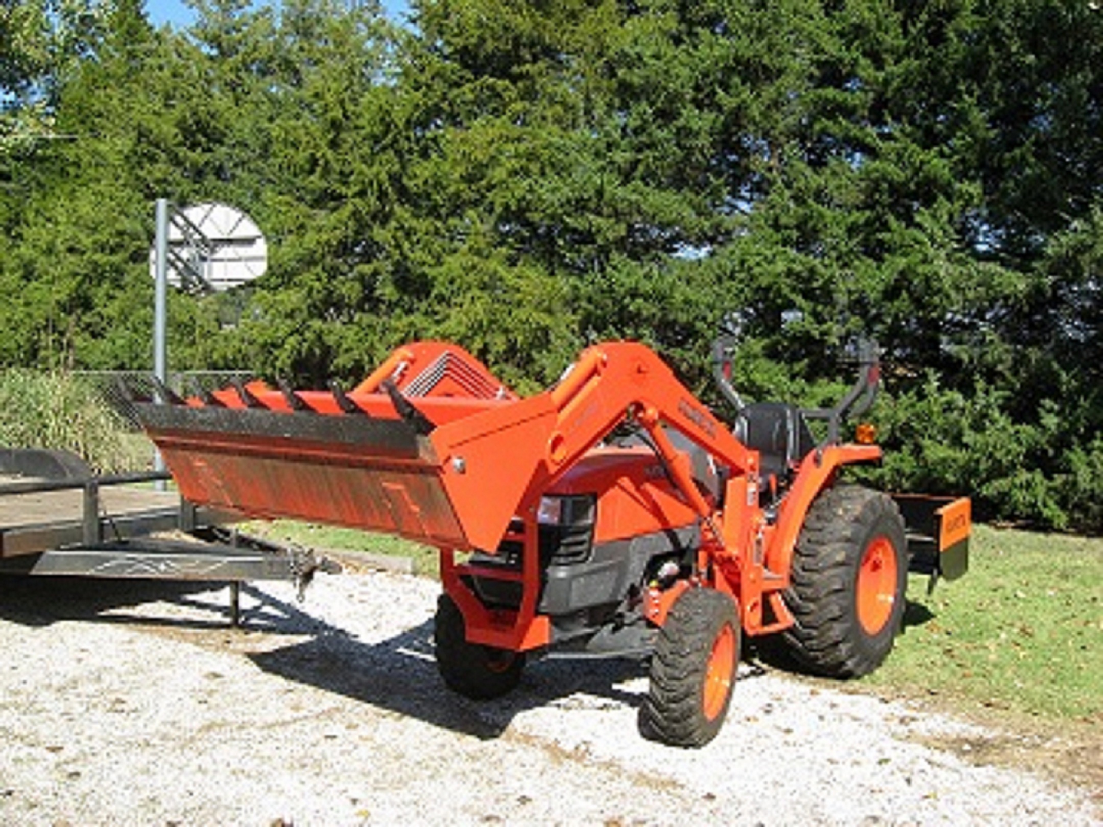

I agree with LD1 step up to the L3700SUHST. Right now 0% financing. Your going to love it. I do mine. If your going to do some clearing work you might what to add a tooth bar to the FEL on any tractor you buy.
