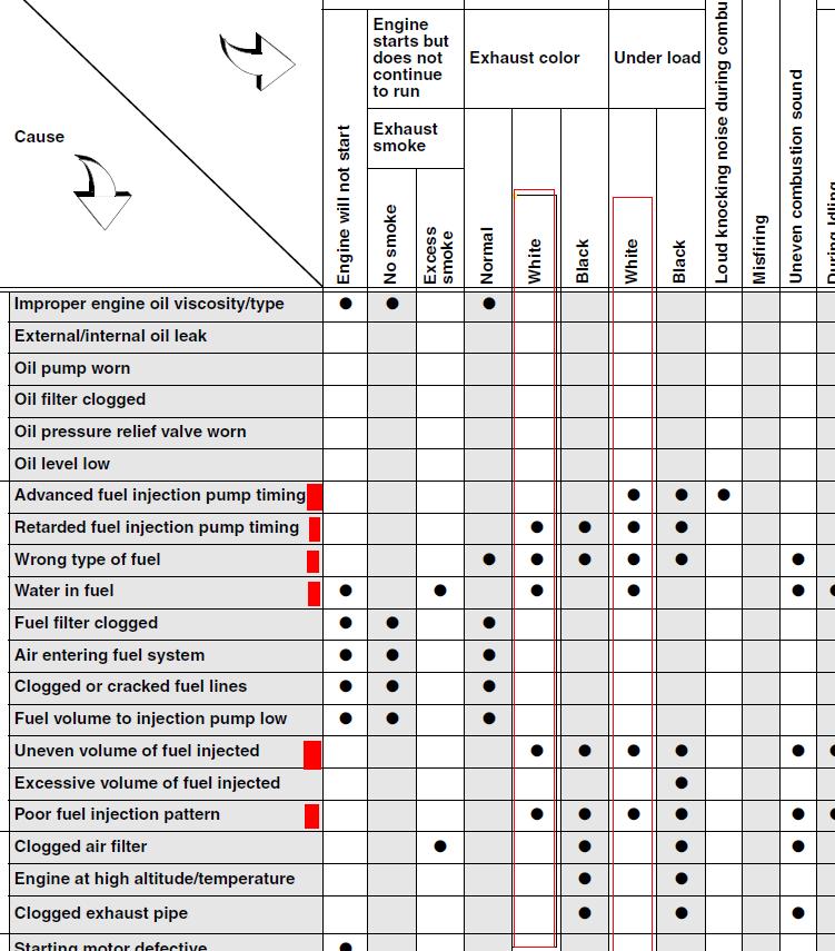

Ran out of fuel last week (did not know fuel gauge was not operating) and replaced with clean fresh fule. Changed the fuel filter twice. Now our JD X495 diesel starts in a snap and runs great under load conditions for 15 to 25 minutes and then starts to run very rough, white smoke, imitating a fuel problem, as if one cylinder is not getting fuel. Will not start again until cool; then starts right up and runs just fine again until 20 minutes or so have passed, repeat problem. All fluids OK, changed fuel filter two times and outer air filter. Can find nothing in the repair manual that addresses this. Anyone have an idea? Thermostat?? Tractor does not seem to be overheating.

Looked at my tech manual for the 455 diesel, and the following chart came up. Might give a clue for things to check out in addition to what DieselMonk suggested. Crude outline of trouble signs with red mark of possible causes.
