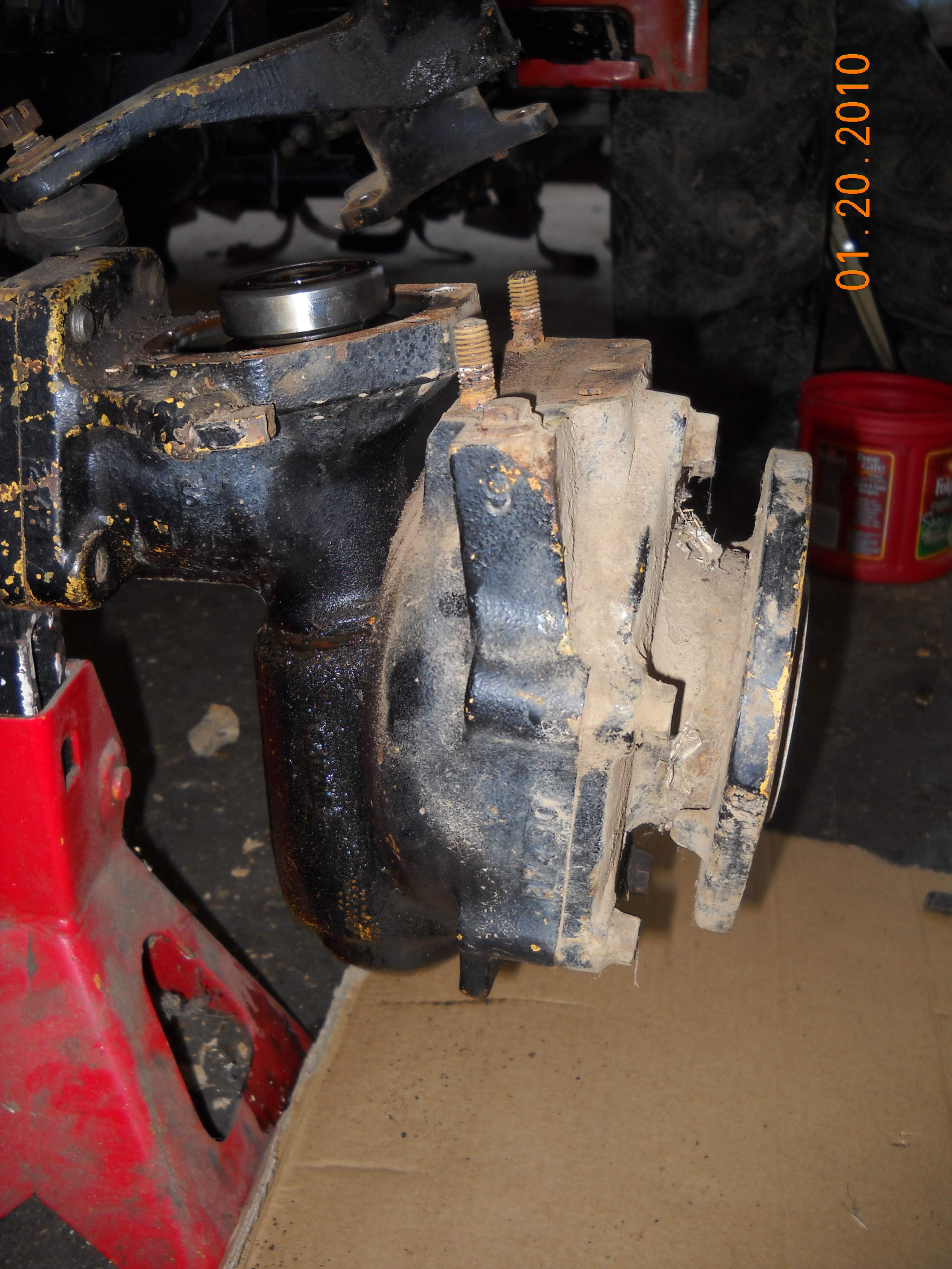

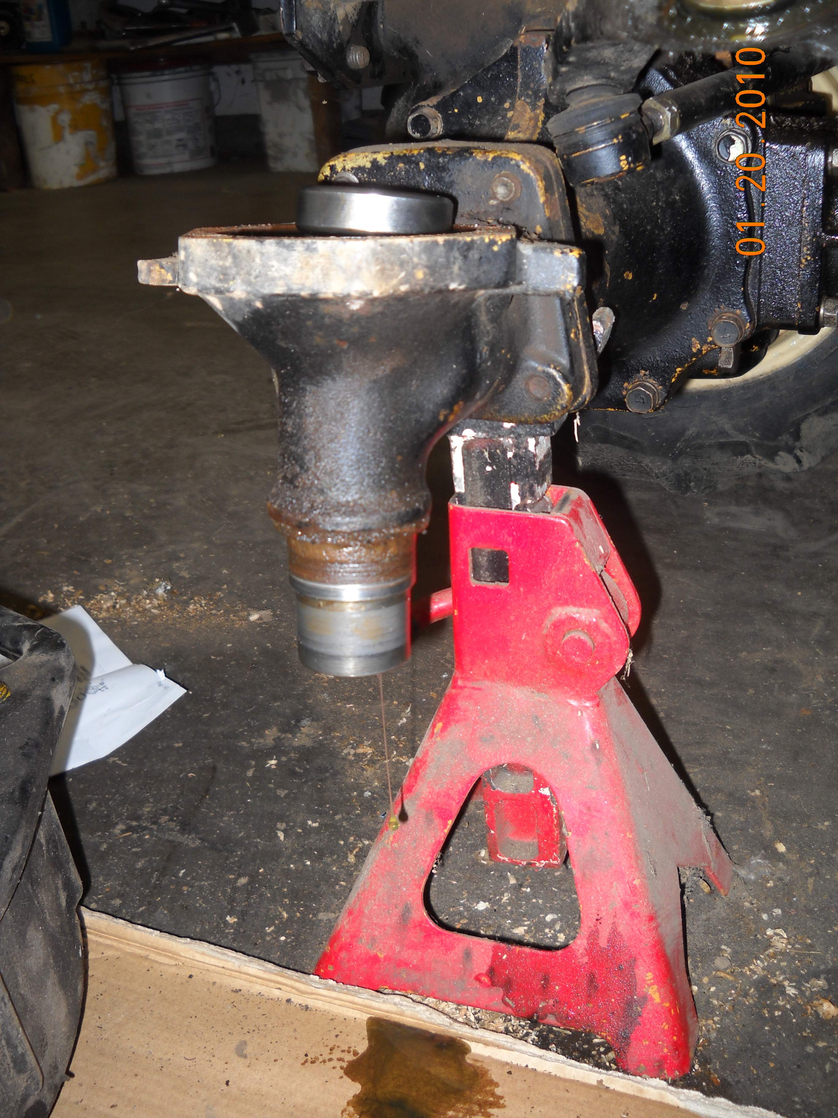

:welcome: to TBN! I have the 650's cousin, the Yanmar 169d. Some of the parts are interchangeable between the two and they share the same engine. I love my yanmar, it sure is worth what i payed for it. I got my tractor for $2800, no FEL or backhoe, and the 650s with FELs around here run from $4500-$6000 depending on the condition. Is the FEL and backhoe on this tractor factory from Deere or aftermarket? Does it run well? Try the 4wd, try the differential lock, and check for any leaks. My tractor had a bad leak in the front axle and I had the completly take it apart to replace the seal. It wasnt to hard, but it was a learning experience for sure. Try the fel and backhoe, use every function they possibly can. With the FEL, try using the joystick in a diagonal pattern to operate both tilt and lift at the same time, same with the hoe. Check the fluid levels; oil, coolant,hydraulic fluid, etc. Does it smoke? Operate at a higher RPM to see. My tractor only smokes when It is going up a steep grade or starting on cold days, other than that, its fine. It is a great tractor, mine has served me very well, i hope this one works out for you. :thumbsup:
