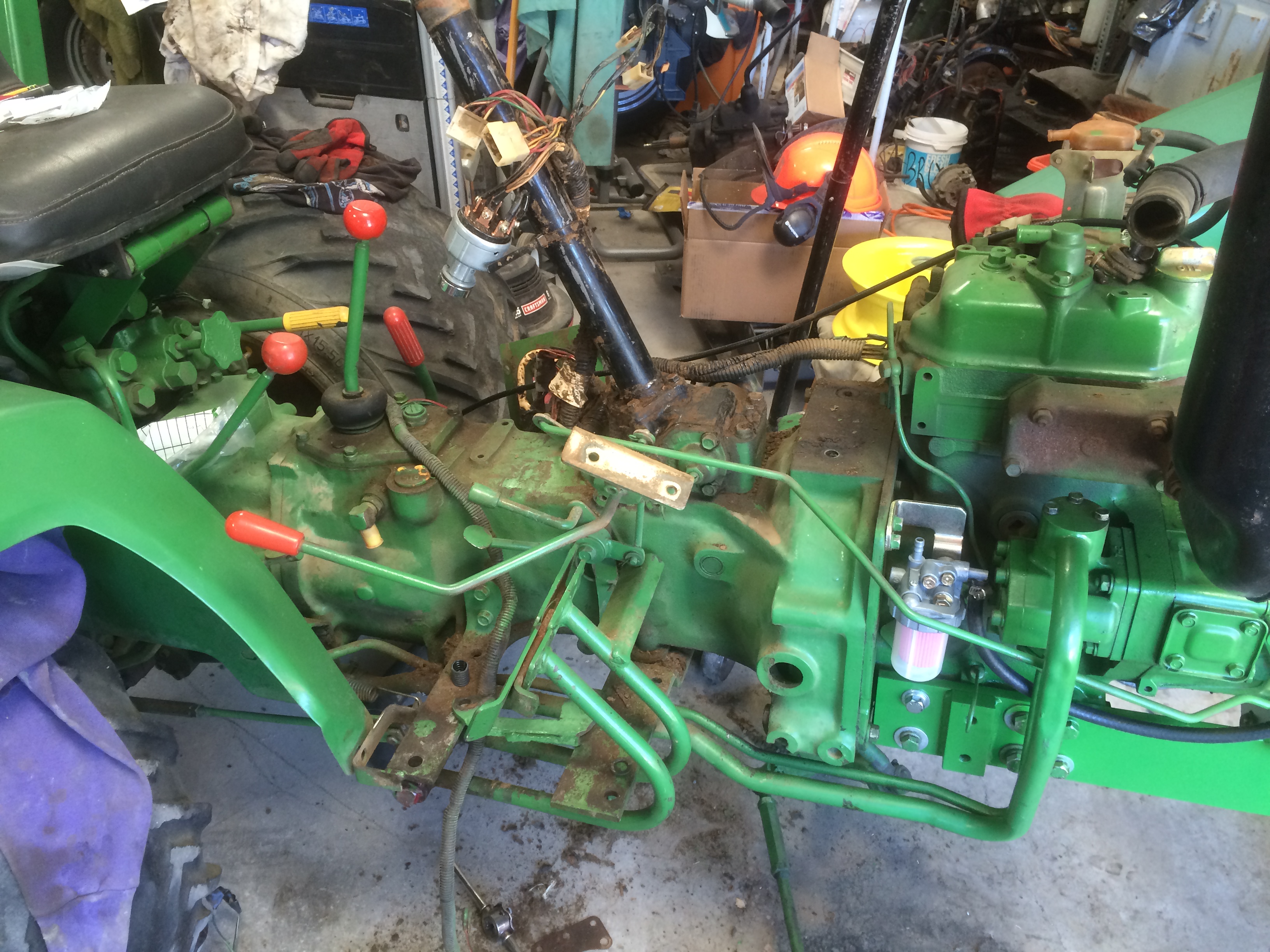

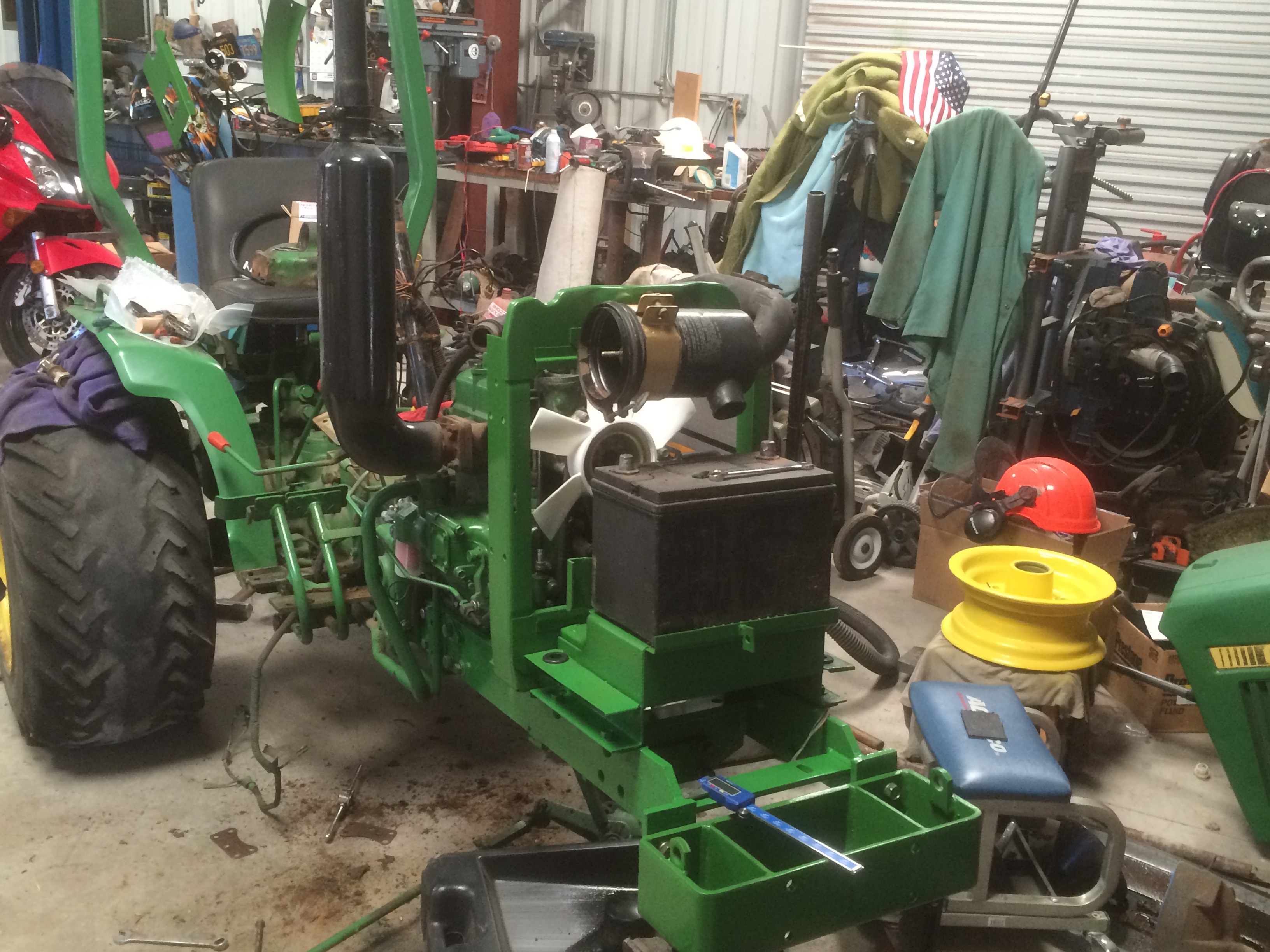

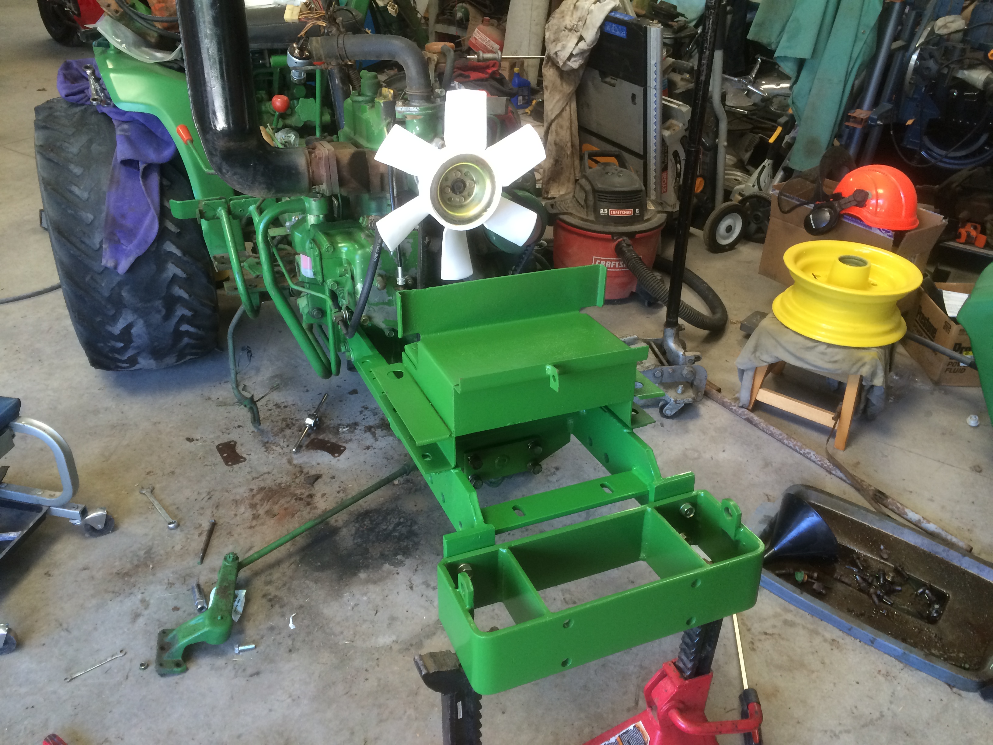

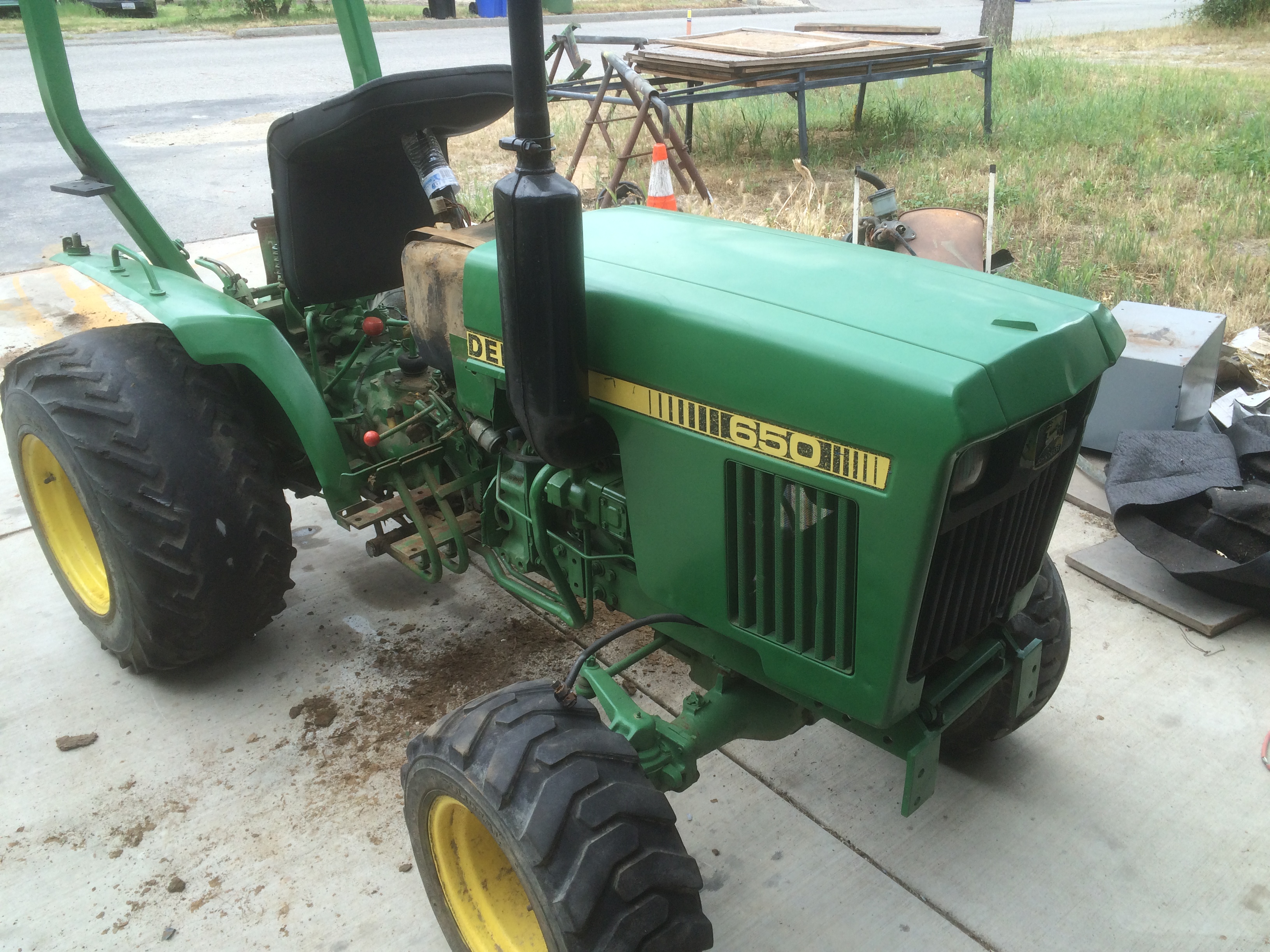

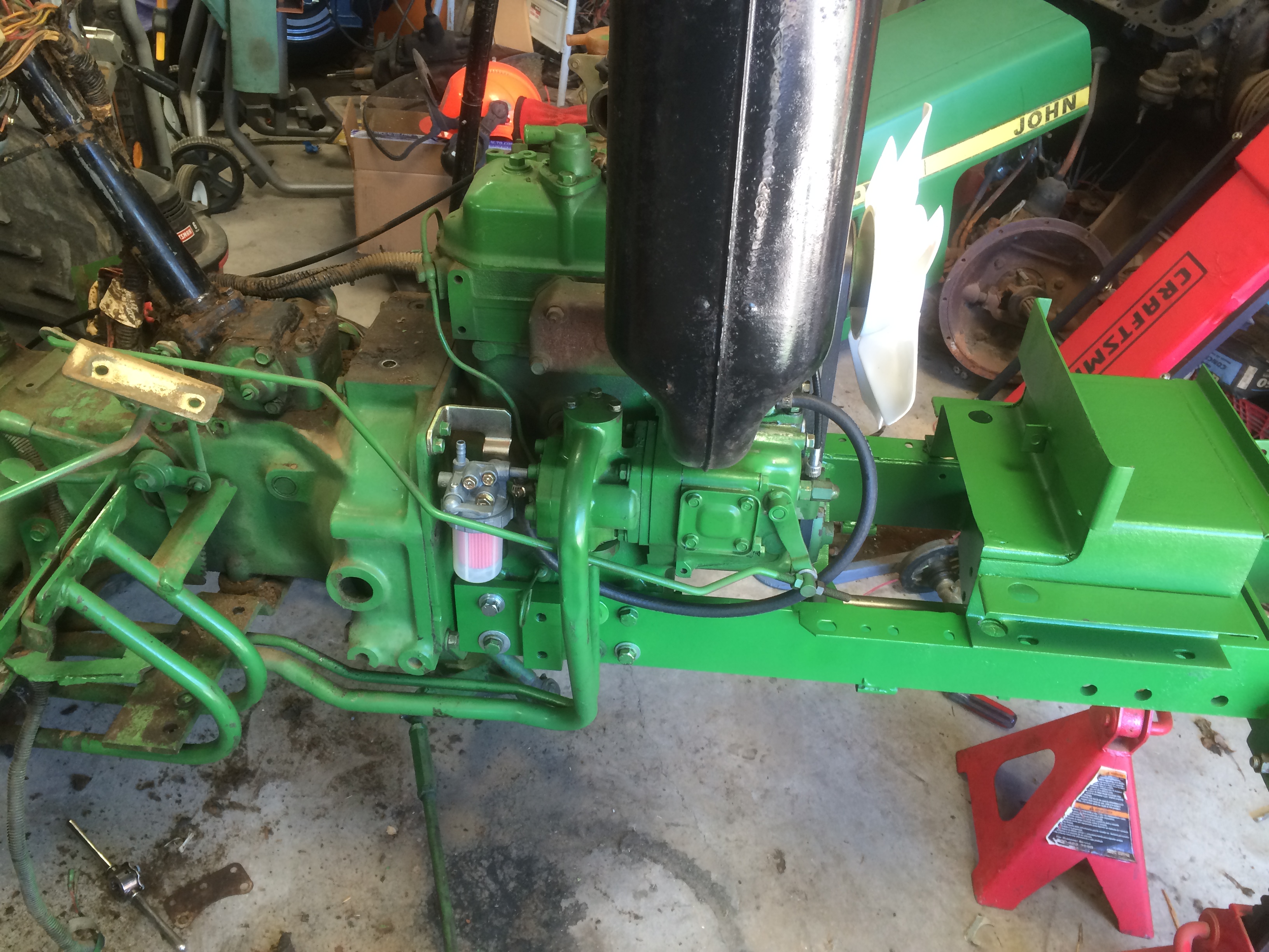

I have been working on a 1985 JD 650 compact that had been pretty abused most of it's life. It being a close relative of the Yanmar YM187D most parts will interchange, at least seals & bearings on the mfwd front ends. (Mine is mfwd) Hoye tractor parts, in Iowa Park, Tx. Has been a reliable and reasonably priced solution to my parts dilemma. I had to rebuild the front axle, most of the drive towers' bearings were destroyed! Seals were bad, too. What has been somewhat lacking is a working data base of crossover parts reference materials and info. Sam at Hoye tractor was extremely helpful, but has since retired, so I want to pass on what info I have in case others who these John Deere Orphans might have a better chance of reclaiming these small jewels!
P.S. She is up & running, ready for fall ground prep!

Great looking re-do!! :thumbsup:
I got my 650 about 14 months ago,,,
Luckily,,, the only things I have needed are oil, filters, grease,,,, and a seat!!

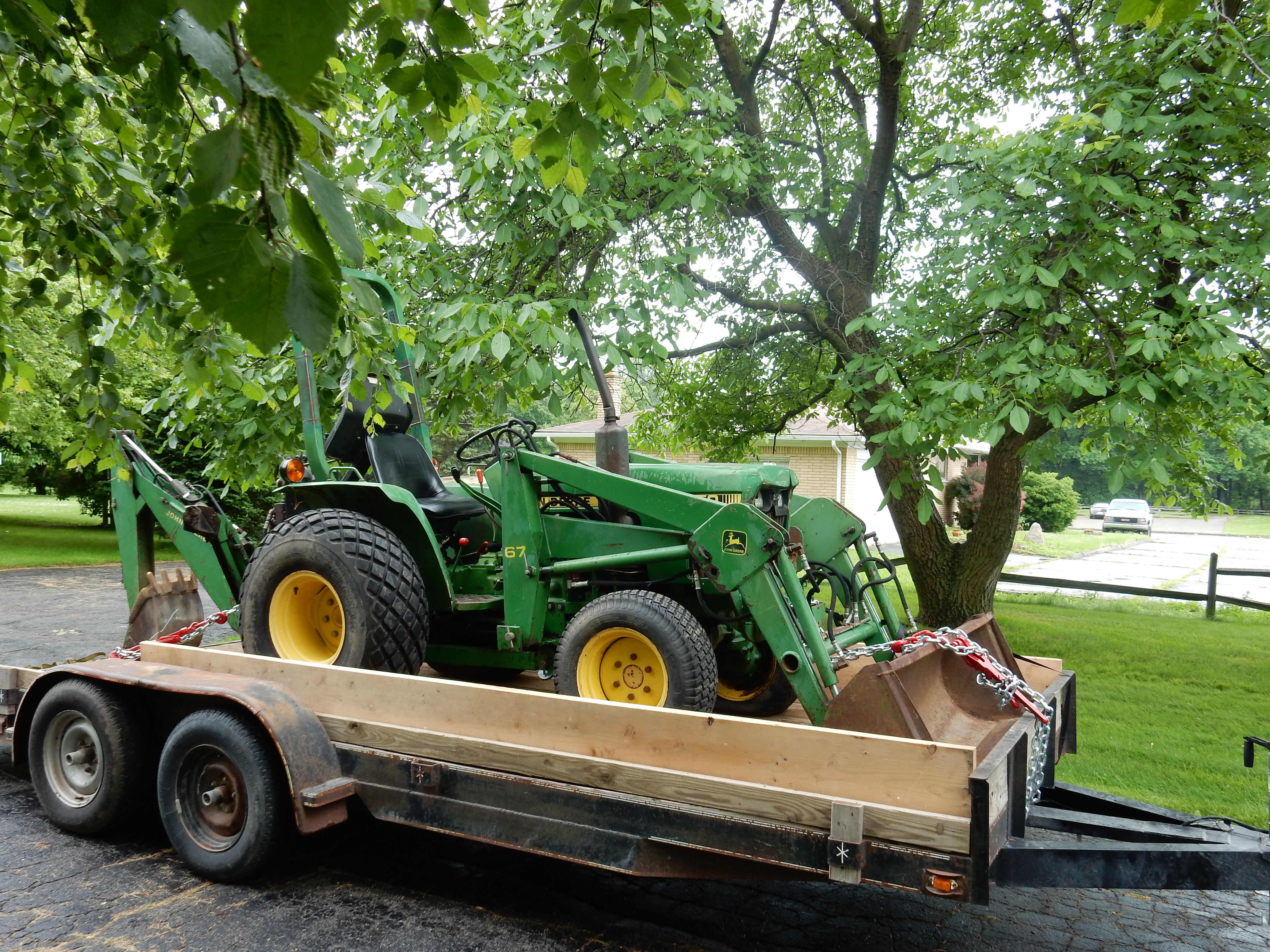

Backhoe and New Carpet 001.JPGBackhoe and New Carpet 014.JPGBackhoe and New Carpet 016.JPGDay I brought my 750 home.

Nice setup! I wish mine had come with all those toys!

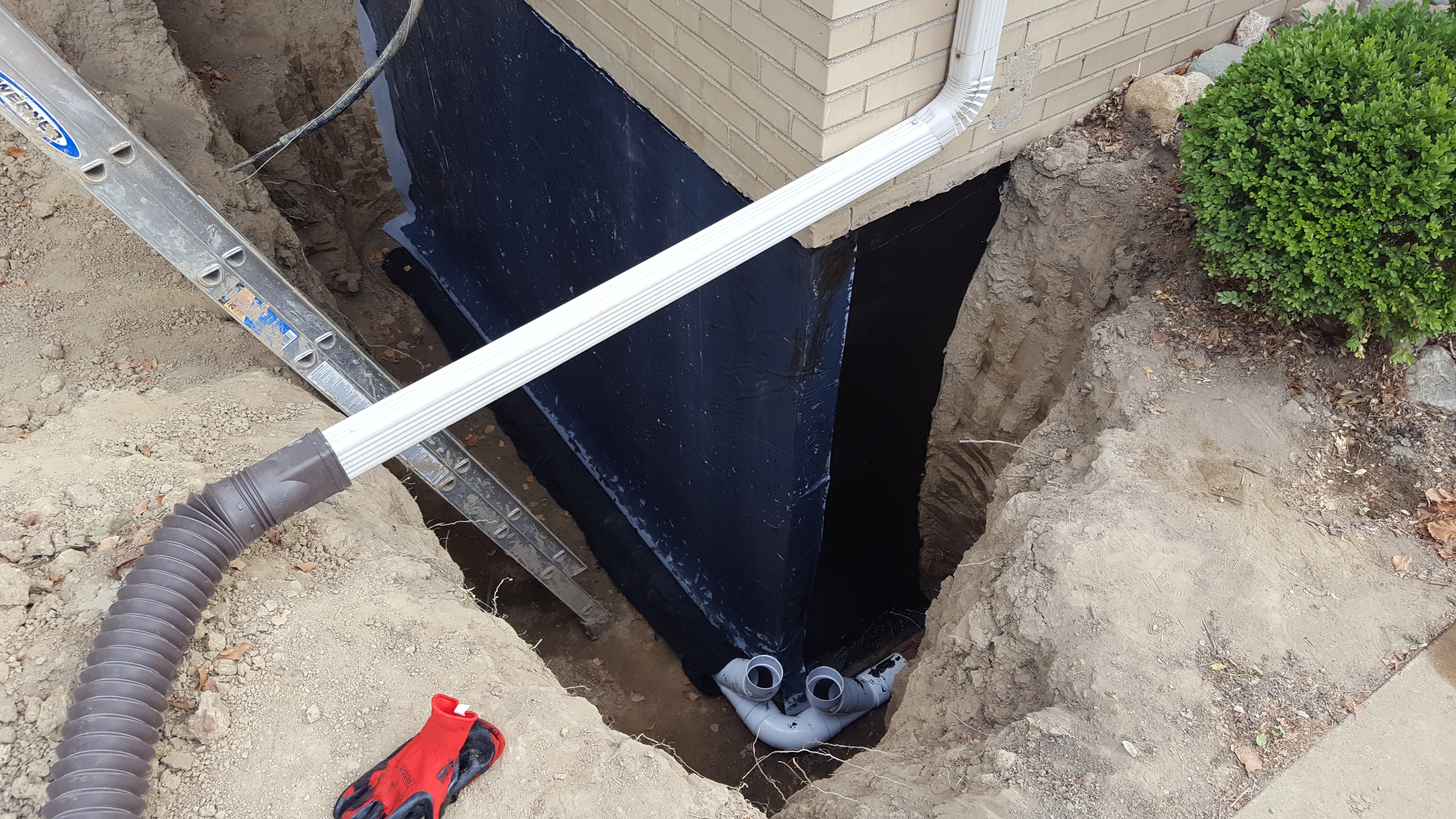

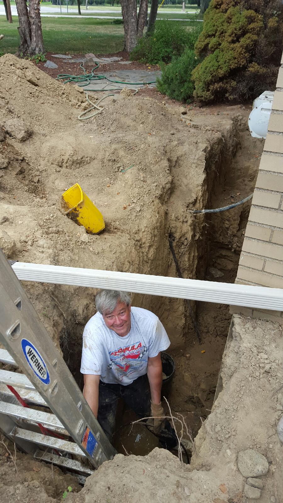

I could never have tackled this project without it. May not look like too much but the ground is really hard clay and next to impossible to dig by hand. There is a gas meter and gas line that was in the way so in that area I had to dig by hand and it wasn't easy. The wall was leaking in the basement after it would rain so I figured I would dig down to the clay tile and pulled out the ones that were full of dirt and blocked. Never found any that weren't full of dirt so I kept digging and then came to the clean out that was buried 4 feet down that I didn't know was there. Ran a hose down it to see if water would come out into the trench I dug or would go the other way. Figured if it didn't come out into the trench I could stop digging. When I saw that the water was going down the drain away from the trench I rented a hydro-jet and then spent the weekend hydro-jetting out the dirt in the drain tiles. Replaced the clay tile with PVC and put sock over it to keep the dirt out. Filled the trench back up with P-Gravel all the way to the top, 6 yards of it. Wall doesn't leak anymore and we got a lot of rain after I finished this.
