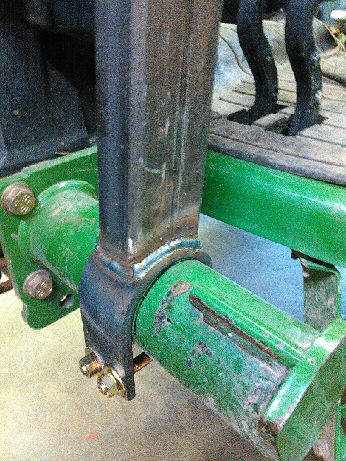

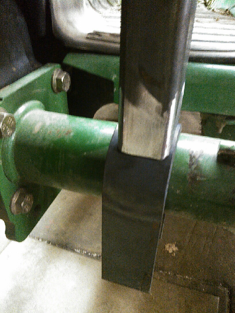

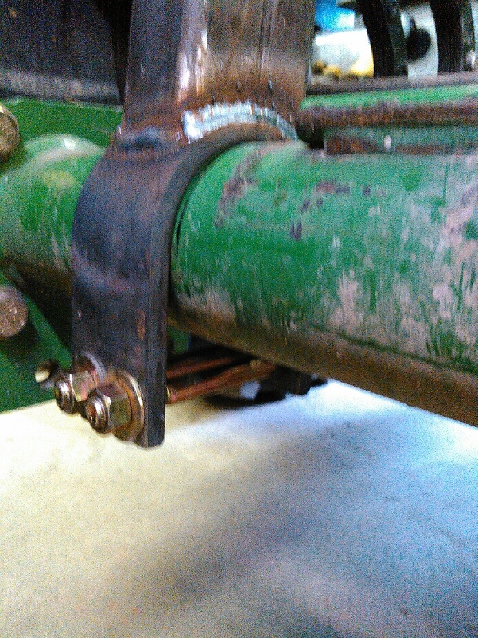

It clamps around th bracket that the loader mounts to

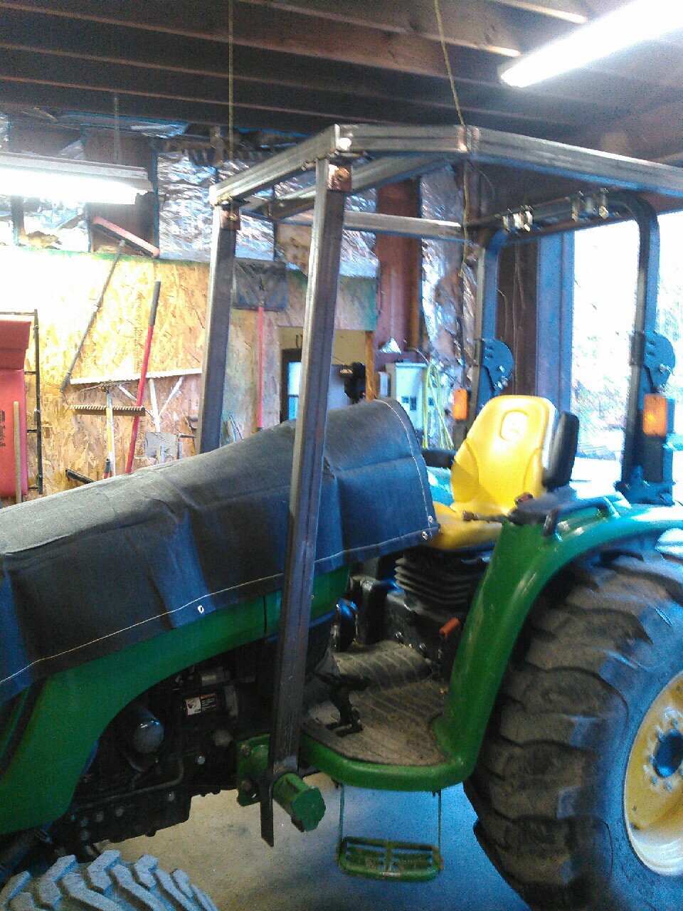

When I built mine I first fastened the roof metal-to-metal to the framework. The vibration noise was horrible!!!! Took it apart and cut pieces of rubber belting to fit contact points. Much better.

I probably have about 40 hrs of shop time in it, and about 10 of it was looking at it and thinking how I'm going to do everything, I f I built another one for my other tractor I could do it in about 20 hrs. I probably have another 20hrs of lost sleep laying in bed at night thinking about building it also

I tested mine without and with the rubber strips, it probably cut the noise and vibration about 75% by adding rubber

I would like to build a log trailer if I do that then I might build a another canopy for the other tractor. I would probably build it out of 1/8" wall vs 3/16" wall steel , I think after I get some more hrs of use I might have a few more little things I would change.
