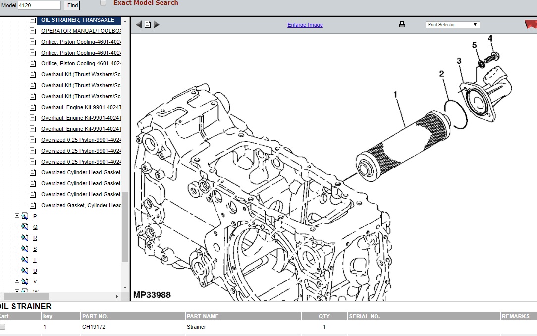

A friend has a JD 4120 and he me asking me if he had a screen in the rear end for the hyd oil. I couldn't tell him if it did or not. Can someone please help us out? Thanks, Lee

There is a strainer (some might call a screen) in the "rear end" as shown in this schematic from jdparts.
It is unlike the screen on my 4300 that is located on the forward end of the transmission.. of which something similar doesn't show up for the 4120. The red arrow shows forward orientation, so looks to be rearward and over the right rear axle..

That is the screen I was referring to and the opening is at lowest portion of transmission. follow the line from hydraulic filter to the shown 2 bolt on fitting.

Maybe he meant "pinched" packing, key 2, in the drawing you posted, post #5
