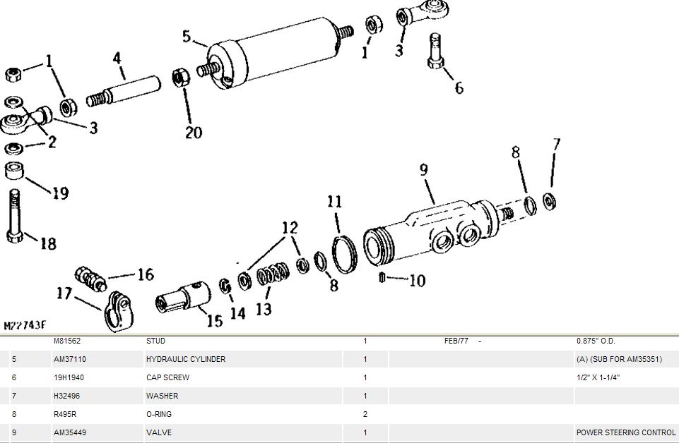

You can see the parts of the power steering on the 400 by going to jdparts.com and signing in (it is free registration). Gives you a chance to see the various parts and their part numbers if needed.
Sample of what shows for the 400. See a cylinder and a control valve.

The steering is a power assist, not power steering. The 400 had a system all to itself. A friend of mine has one and said it is not too bad to do. There is a rebuild kit for the control valve from deere. I think he said it was like $75. You will get sticker shock if you ask to buy a rebuilt control valve. He said that was like $700. It is a very common problem with the 400's.
   / jd 400 power steering #6
I've done a rebuild kit on a 445 (I know it's not the same exact set up) and it still didn't work, as it turned out the cylinder was broke, so had to buy a new one of those at about $150
