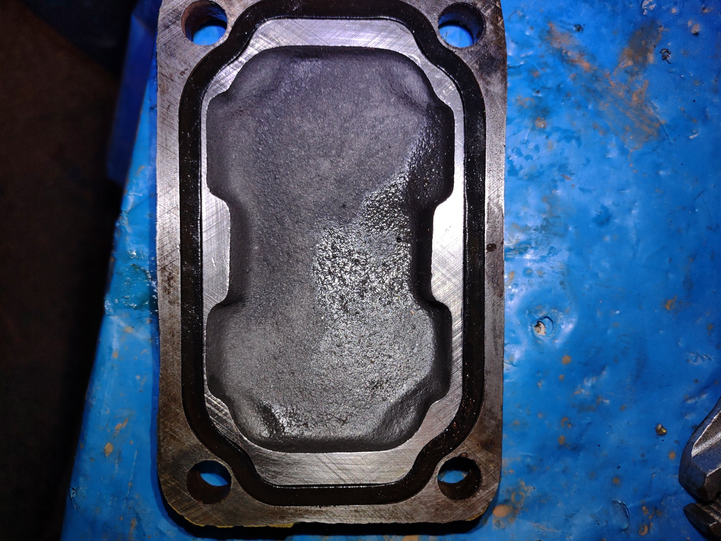

So I have a 2440 and the Top cover is leaking on one of the SCV's for a dual remote system. I bought a new packing and replaced it and it is still leaking..
The packing I purchased was for a single SCV.. Could that be it?
I feel stupid asking this, but am I am missing something? I feel this shouldnt be that hard... Yet here I am ..LOL
   / JD 2440 Leaking from Cover of Old Style Dual Remote SCV #2
R49187 should be correct part # for utility tractor SCV top cover seal. Seal is same for both of your tractor's scv's. That part # fits 79 different tractor models. Check for crack in cover or scv housing. How does return oil from scv get back to tractor hyd system(RS housing or ported filter cover)?

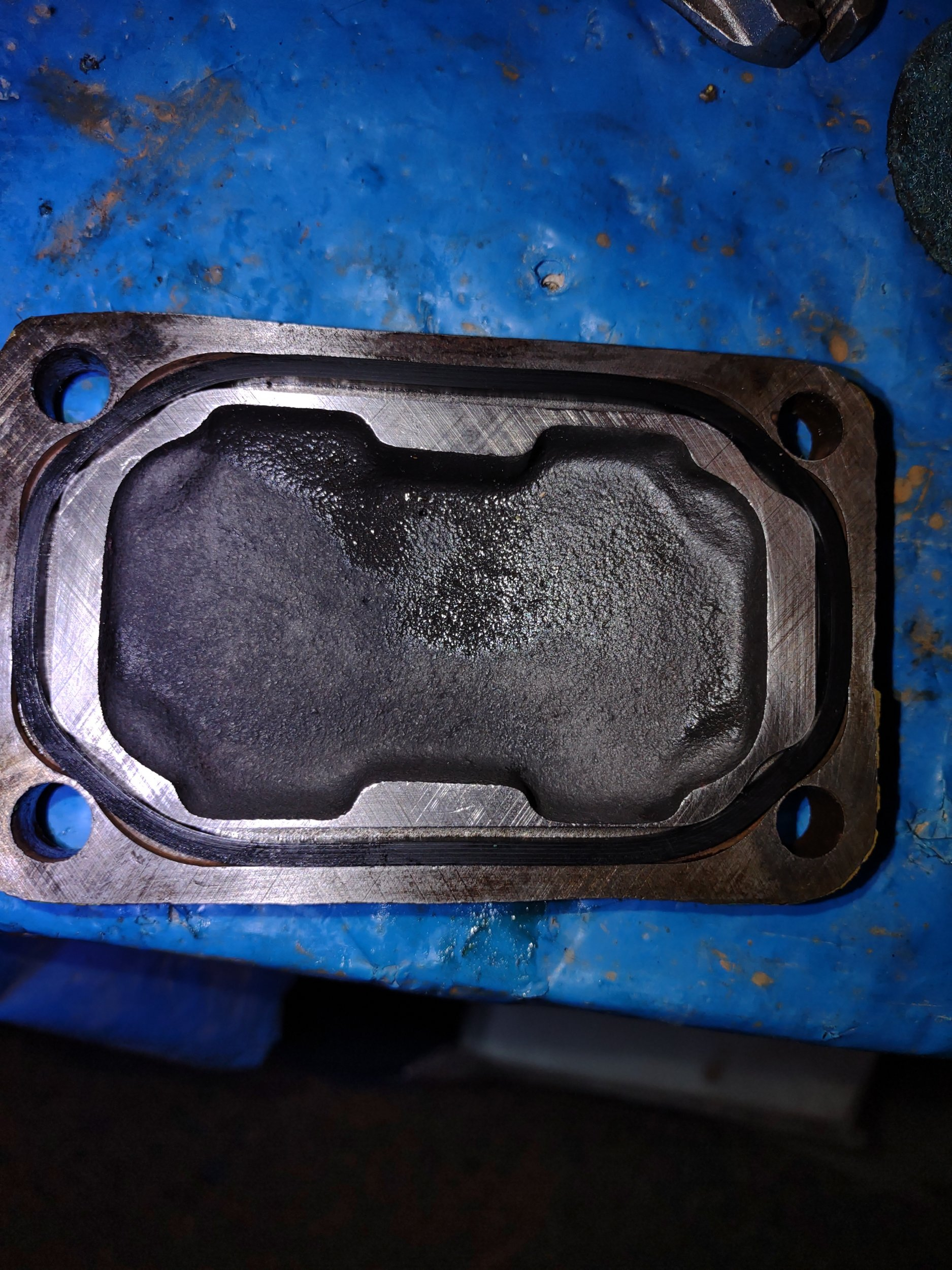

Did you check scv cover to be sure it's flat/level?
@Tx Jim @Zebrafive
Yes I put a straight edge on it and it looks good, also verified part numbers they are good.
Here are pictures of the two gaskets, old vs new... Does this look right.. Definite size differences... top / left is new, bottom / right is old.
