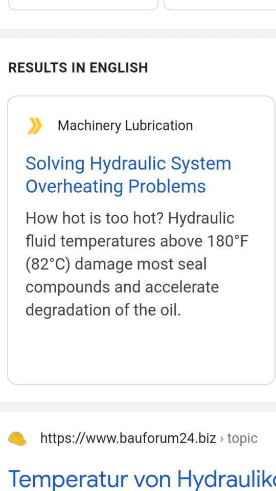

I did a google search for you.
Yes, your system seems to overheat.
