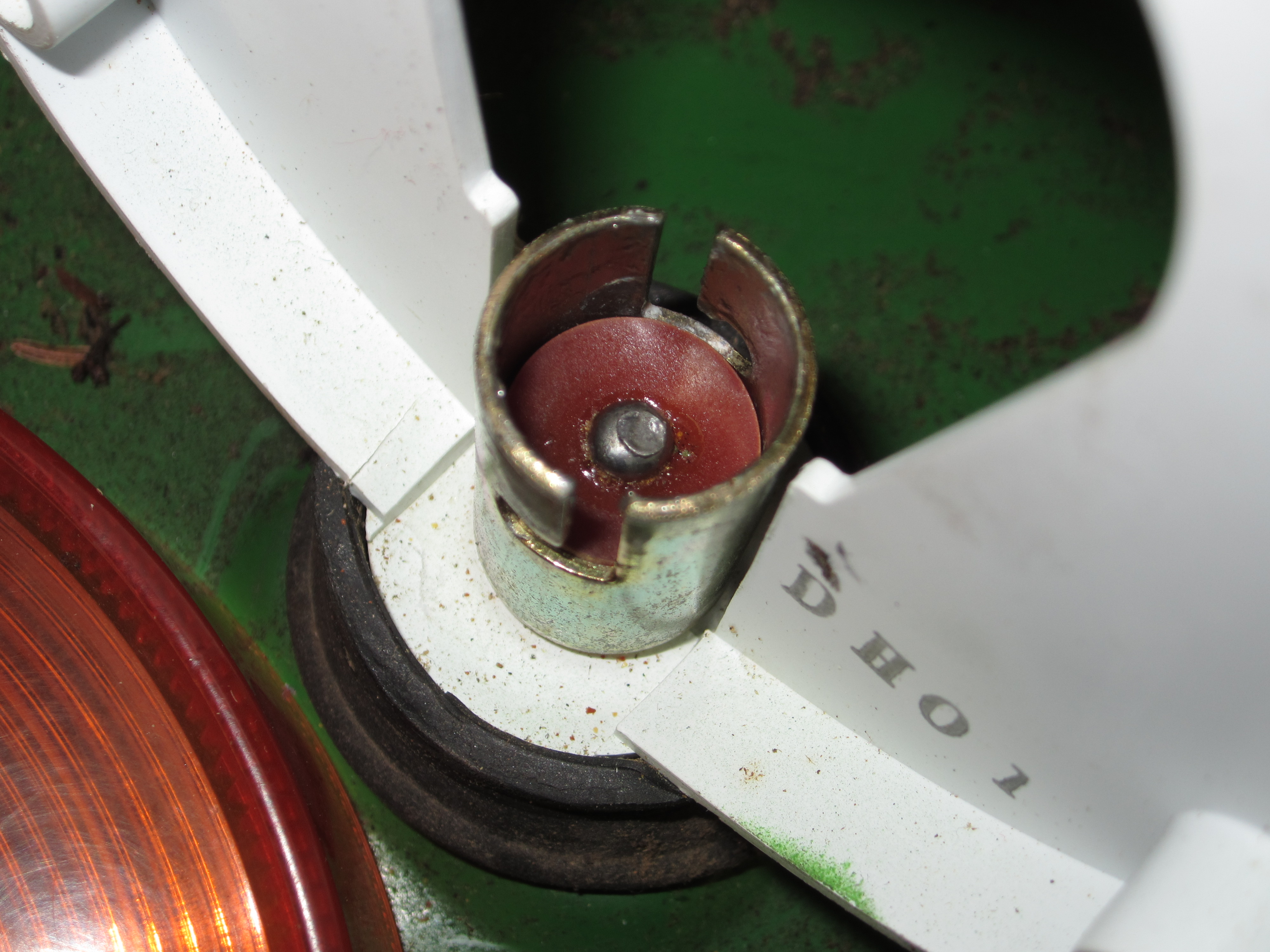

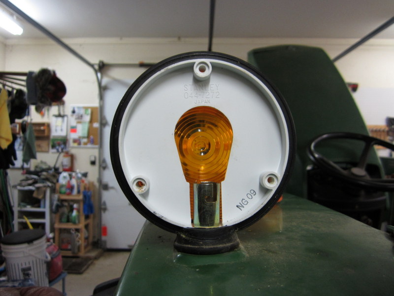

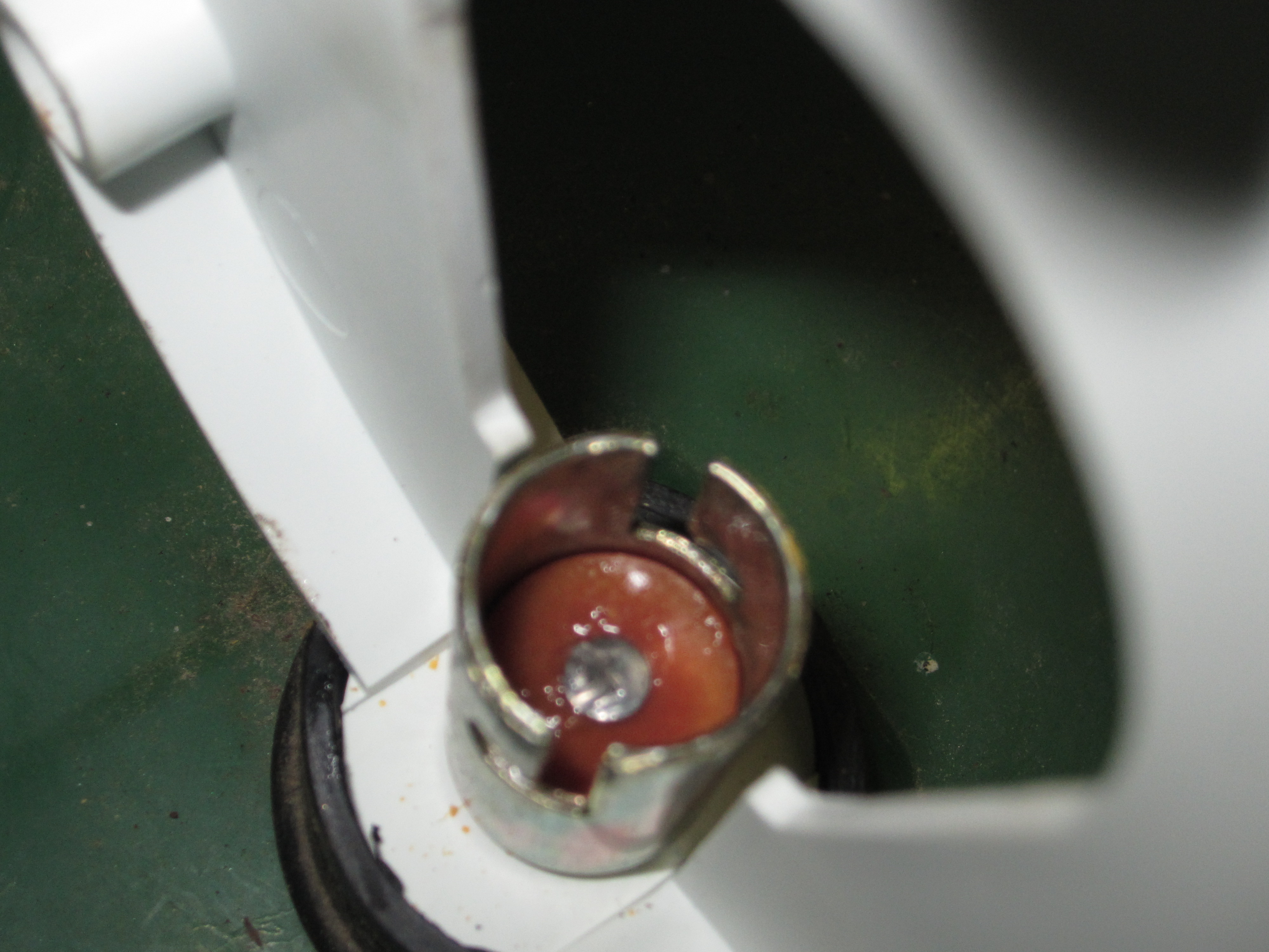

#53
"Can you see where the two black ground wires go from each warning lights?"
Yes, I have two blacks coming out of each warning lamp. They go directly into a plugin harness.
Took pics of both bulb "sockets".
One has an 1156 and the other a T 1156 Assume they're the same?
