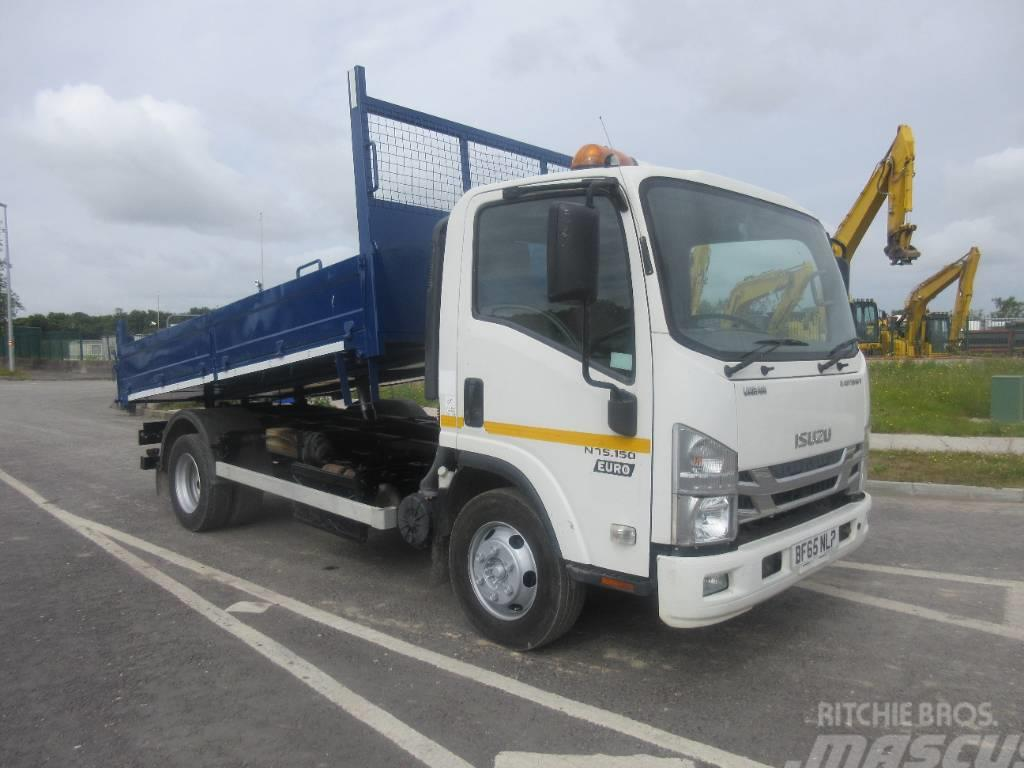

   / Isuzu NPR Diesel Towing and Hauling thoughts #3
Most of them are setup with a 3 Way dump bed, just like this one:

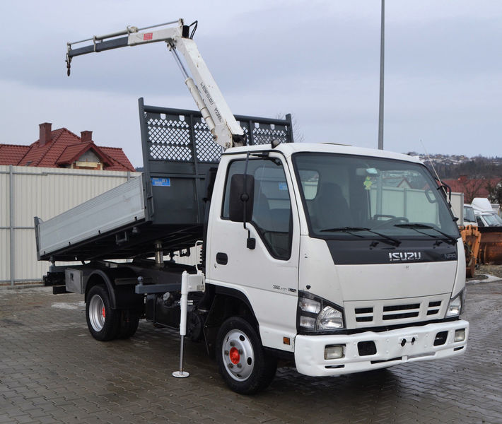

Other have just a simple bed or are also setup with a crane.
