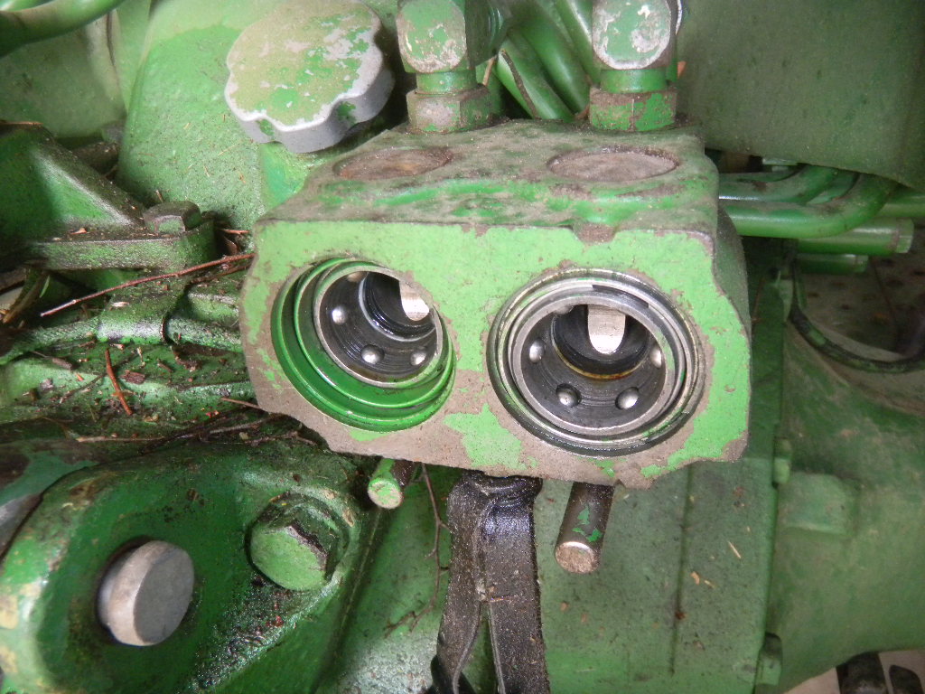

I cant believe it took me this long to figure this out. I learned that i could reach behind the mounting block that the remote hydraulic ports sit in and push them back out to me from the back side. This allowed the correct fitting to just push right in. Thats fixed!
Ill post pics better illustrating what im talking about when i get them.
What we were saying, the female socket slides to rear. Easier to show someone than tell them.
   / Is this the right fitting for my remote hydraulics? #32
Here a picture, left side is forward, right back. Notice the difference in the lever on the bottom, it moves with the female socket.
