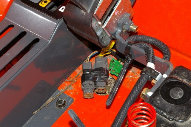

I was wondering if there was a 12 volt outlet on a L3130 or if anyone has added one. Thanks
   / Is there a electrical outlet on L3130 #2
There's a wire under the seat that ends in a connector terminal, hot and ground. Turns off with the ignition switch, has it's own fuse.
   / Is there a electrical outlet on L3130 #3
It's the one with the green end. I ran my lights off of there..Hope this helps...

   / Is there a electrical outlet on L3130 #4
Is it me or your two pictures are "nearly the same"? ;)
   / Is there a electrical outlet on L3130 #5
Good Eyes. They were basically the same. I deleted one of them. :)

Man I love this site. I have seen that plug several times...never knew it was just a dead plug with hot and ground. Awesome, now I know where to hook up my ROPS lights (when I get some). I thought it was a diagnostic connection cannon plug or something like that.

   / Is there a electrical outlet on L3130 #9
JohnK
Did you cut off the green plug when you used the wire or did you find a matching connector?
NorthGA
   / Is there a electrical outlet on L3130 #10
I used the inline connectors with the metal plate you squeeze when you put the 2 wires in there. I forget what you call them . The new wire goes against the plastic butt end and the other wire goes in the groove parallel to it and you squeeze the metal tab that makes a connection between the 2 wires. Hope this helps.
