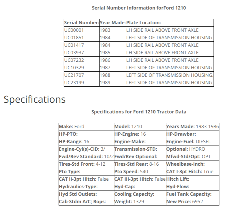

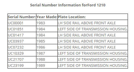

I don't understand why it is "hard to say".
1986 models began with UC 07232
1987 models began with UC 10320
Your tractor is UC 10118, meaning it was built just prior to the first 1987 number, but well after the first 1986 number.
Thus it must be a 1986 model, built at nearly the end of the 1986 model year.
After re-reviewing the data base, I'd agree. Thanks for pointing that out.

Well, according to the column marked Years Made, it should be an 86 model.
But, I agree, it's not clearly stated.
Rams
That's what I said earlier.
I'm not sure about the accuracy of the tractordata info, but that site says that production of the 1210 ended in 1986. New Holland (121) - 3 CYL COMPACT TRACTOR (1/83-12/86) Parts Diagrams also shows production ending in 1986.
According to the tractordata site, 1986 production began with UC07232 and 3295 units were produced in 1985 (7232 - 3937 = 3295). Your serial number is consistent with production in 1986, probably near the end of the model cycle.
Steve
