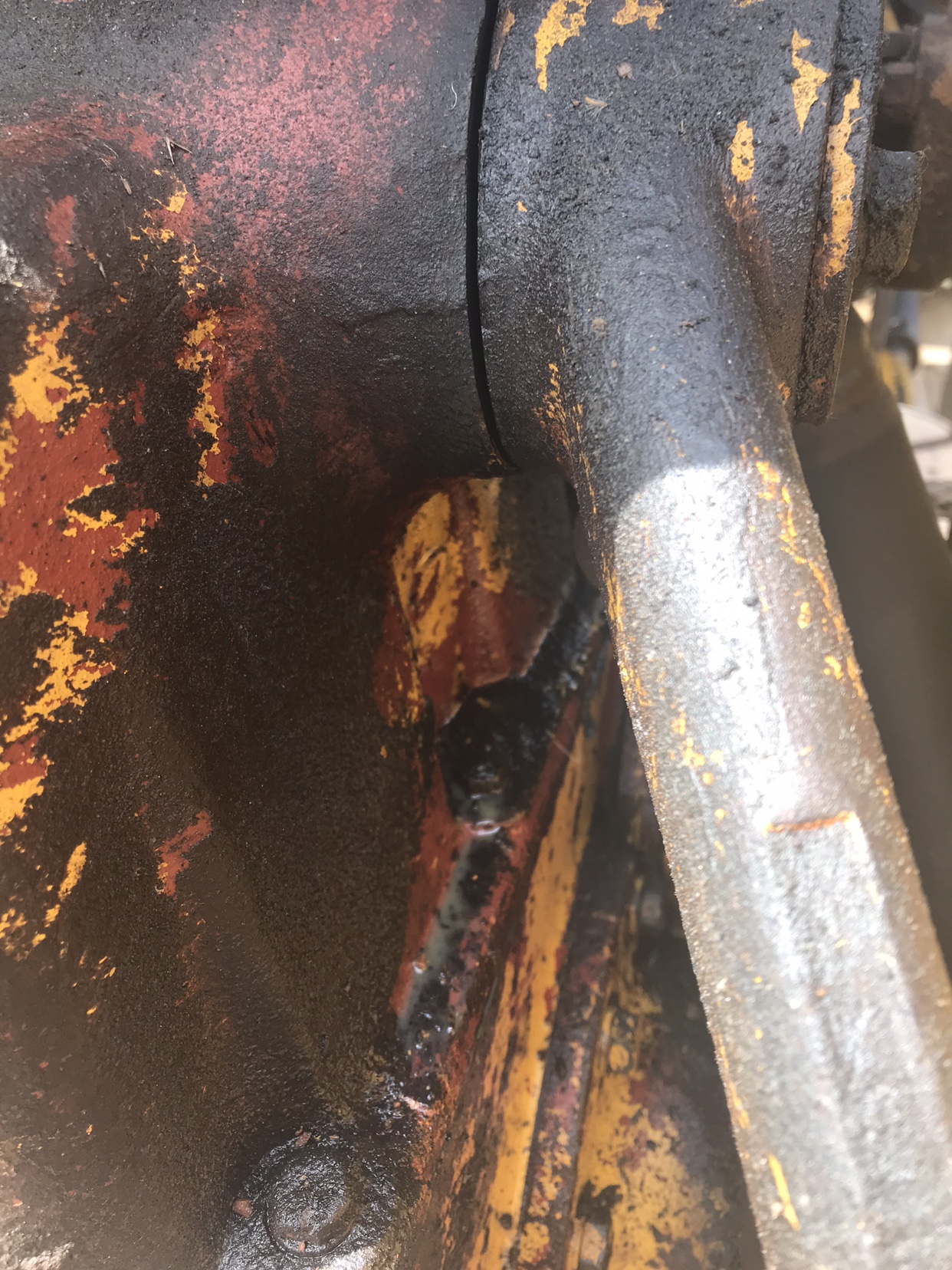

/ International 2444 hydraulics
It appears there is a substantial amount of fluid coming out of the rh lift arm. I will get this thing apart and go all through it. Replace any questionable o ring. Thank you for the help

/ International 2444 hydraulics #12
Take a look at the bushings. They are probably worn and the excess clearance damages the seals or O-ring. Hopefully the rock shaft isn't worn too.

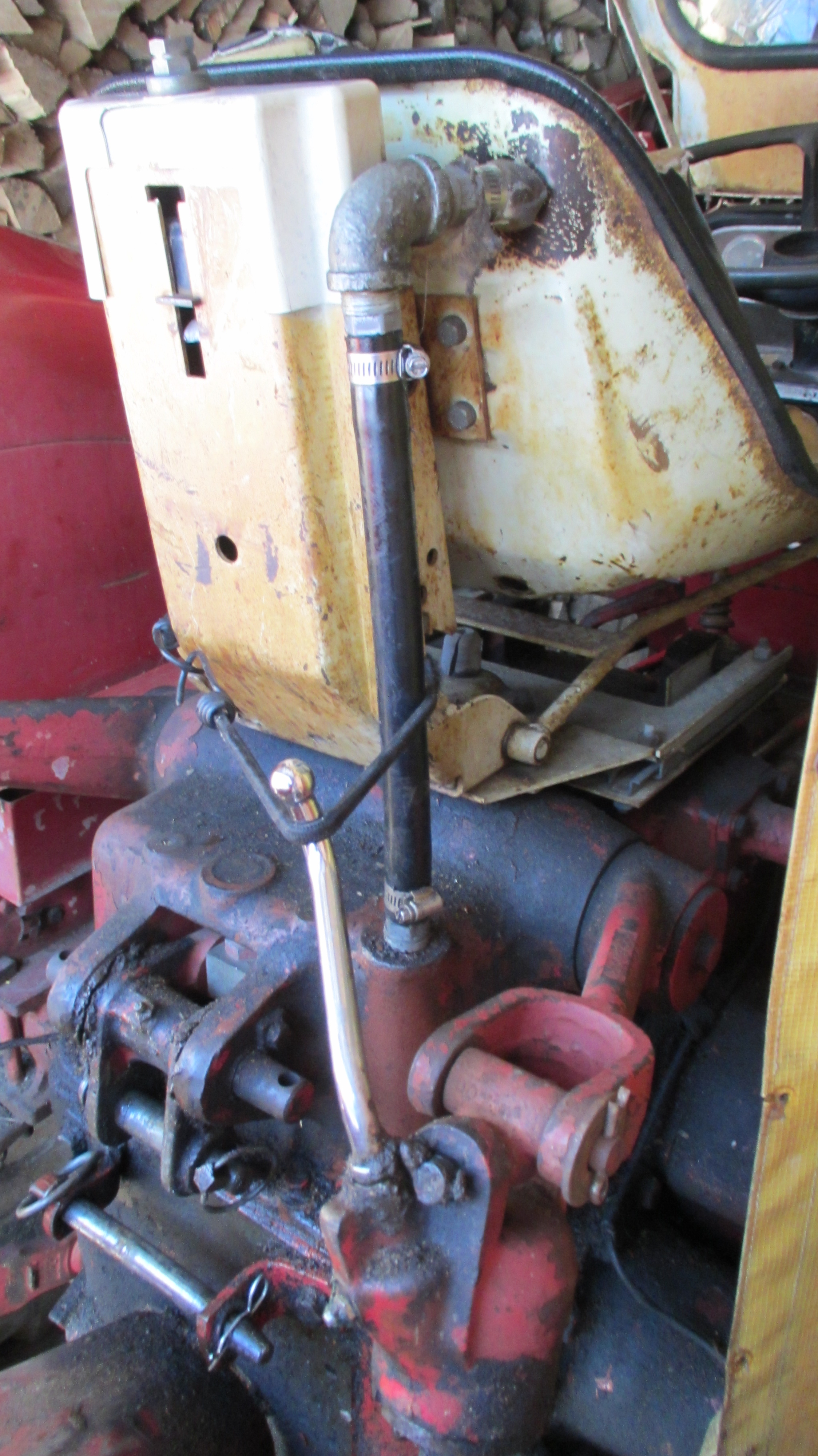

After you have gone through the hydraulics you might want to add a vent to the system. As far as I know there was no provision for venting in the original design. I don't know for sure but I think it is possible for some amount of pressure to build up in the hydraulic fluid reservoir which in turn could worsen any leakage.
/ International 2444 hydraulics #14
That is a great idea I had not thought of that. :thumbsup:
/ International 2444 hydraulics #15
This is what I did on mine. It is hard to see but I attached a piece of cloth on the end of the piping set-up.Tractor 005.JPG
