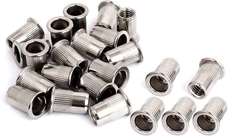

I have a tractor with a cab. I am getting older and it would be nice to have a grab handle when I get up out of the seat to get out. I really don't want to drill any holes. I have a flat surface. I was think something along the line of a big handle like on a sliding barn door. Is there any super adhesive that would hold it. Something like the adhesive on reflector strips you put on a trailer. (double sided super strong tape) any ideas?

Adhesives will eventually fail, you'll be lucky if you don't break anything. I'd trust a bolt any day

No adhesive will hold like a bolt, particularly in an environment that experiences wide variations in temperature and humidity (like a tractor cab). Last thing you need is for the handle to come off when you're pulling on it the hardest, which is when it's most likely to come off. Why are holes objectionable?

This is a better option: Rivnuts

I would drill/tap for 1/4-20 (if the 2 x 2 tube thickness is 1/4") or 1/4"-28 (if the 2 x 2 tube thickness is 1/8" - 3/16") and install a grab handle similar to what I have a link for below.
On my cab, I have 4 of these at the door frame area, 2 handles vertical, 2 handles horizontal, and these handles are back to back inside and outside.
