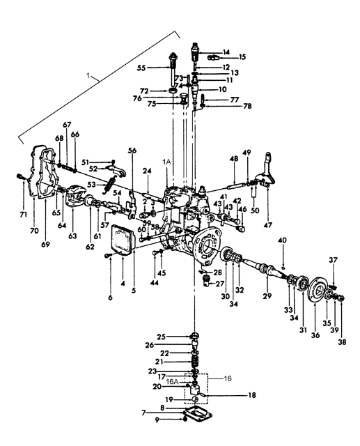

I just changed the engine oil in my 1710. The components are nearly identical except that my tractor doesn't have threaded plugs in the drain hole or level hole as indicated by this photo. The fill plug is the same but those (other two) spaces seem to be sealed from the factory. There are indentations but nothing indicates that these spots are meant to be serviced.
Any 1710 owners have this same plug on their injector pump?
Kent,
Take a close up picture of side front and rear of the injector and may be we can come up with some suggestion. On the one pictured above on post #20, even if you did not have the level and drain hole one can loosen the cover in the back (not all the way) and drain the oil with the cracked open plate on the bottom. Exactly 2 oz of oil from top and I can see oil is about to come our of the level hole with tractor parked on level ground.

Ken, there is a large hex plug on top of the pump to fill it (76). Two small plugs on the side; one for checking level(44), in the middle and one at the bottom for draining. See the image.
