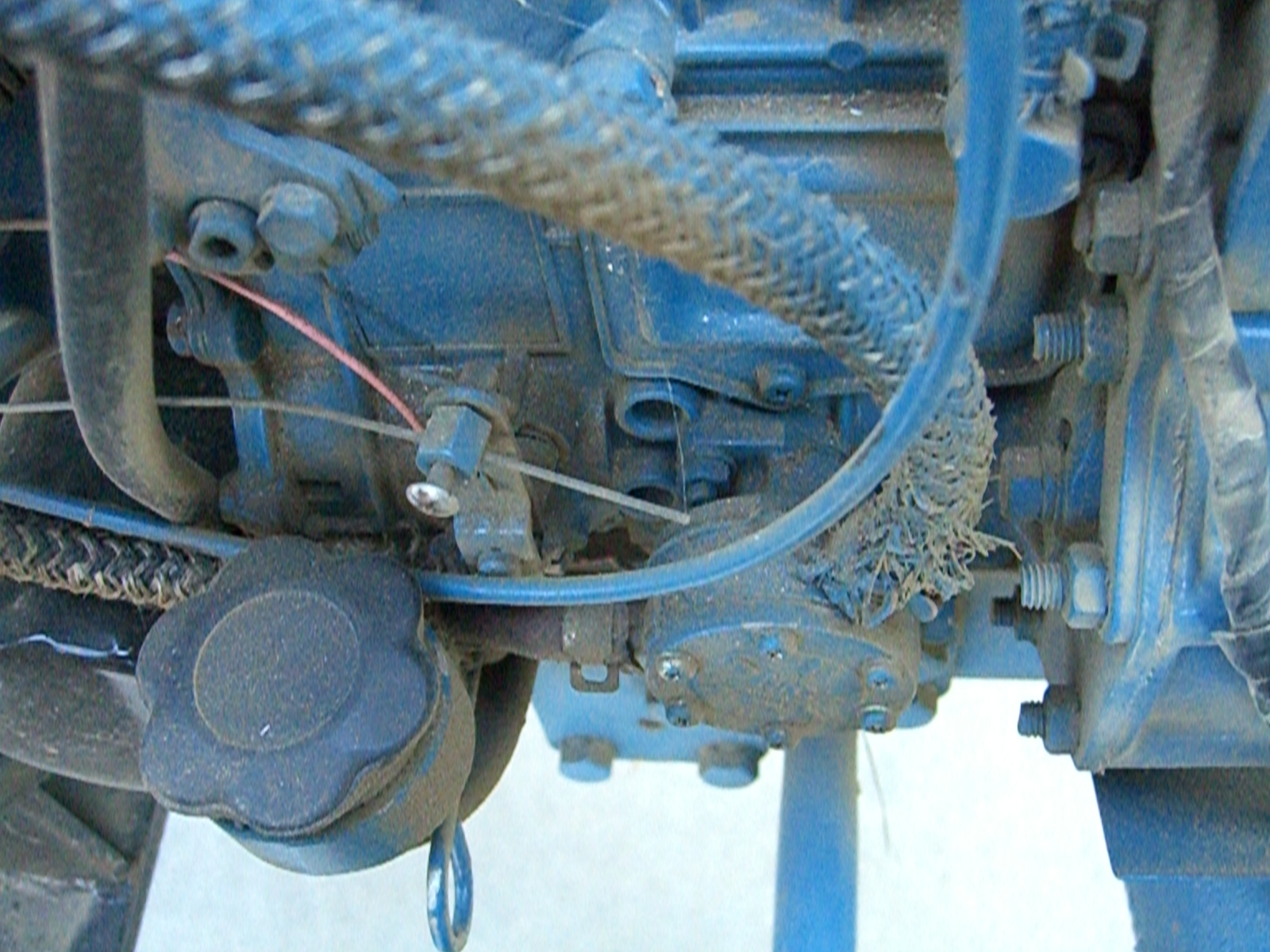

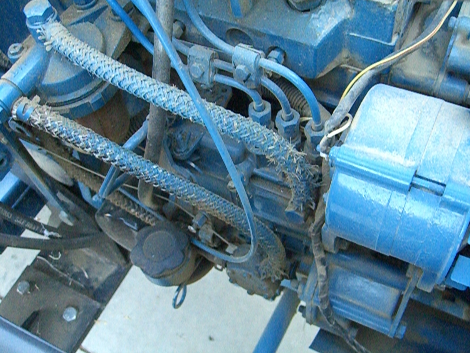

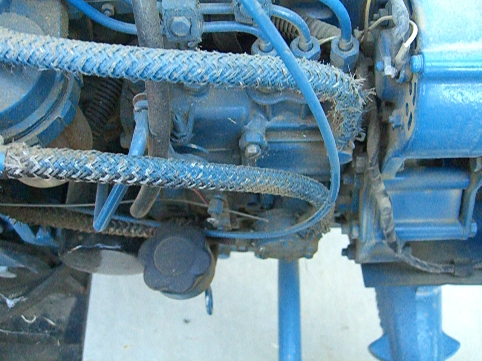

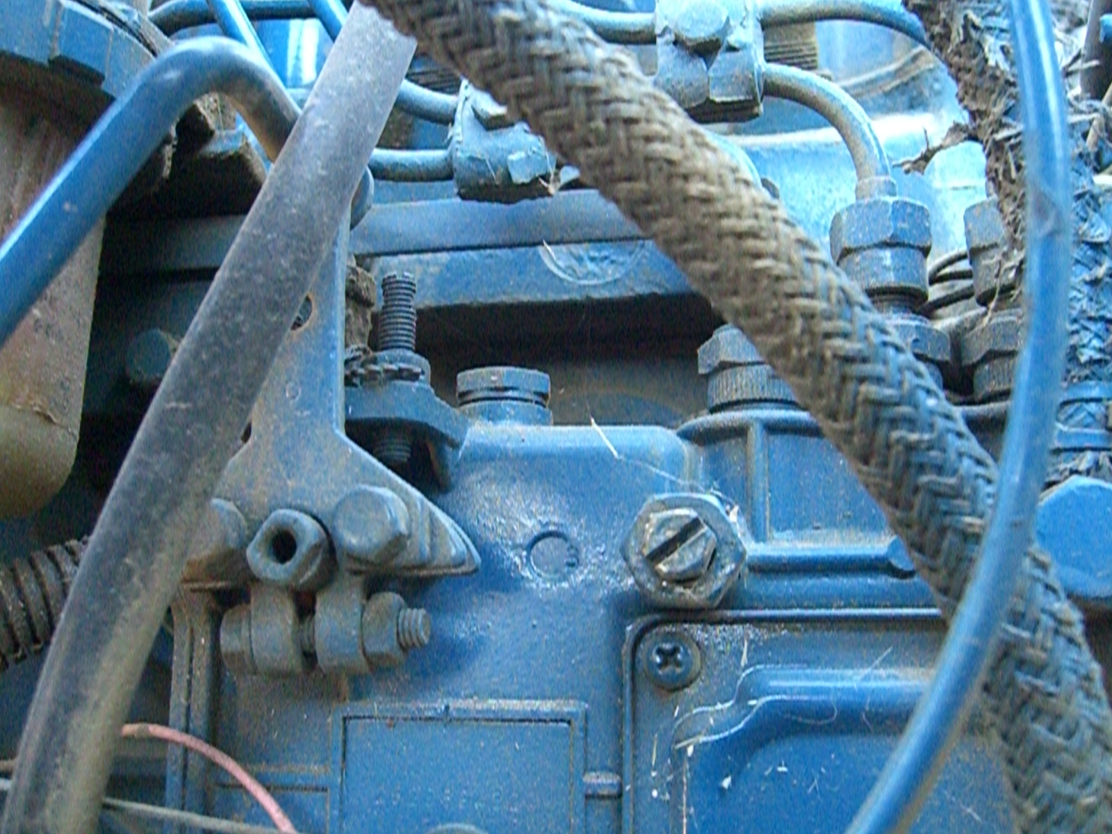

I'm mechanically inclined but new to tractors. I bought a 1700 and the injector pump is gear type positive displacement type of a pump. It puts out about 2000 Psi @ some flow?? to injectors. The governor Assembly is on the pump shaft and the pump mechanism is in a oil bath, same as crankcase. All Sihbuara SP? tractor with mechanical injector pump, there is a fill cap on top, drain on the bottom and a level hole in the middle. You Drain the oil by opening the bottom screw and then opening the top fill. when you're done , you then close the bottom hole and fill from top till oil comes out of the level hole. pretty simple. my oil was bit dirty but not at all as bad as crankcase. I think they recommend changing it every 300 hrs. my tractor has 900 hrs and I reckon never it was changed. You certainly don't want the pump run dry, would be same as engine running with no crankcase oil.
[/URL][/IMG]
Looking for help on this. I have a Shibaura SD1843 and the injector pump looks very similar to the picture above. On mine, where the picture above shows the drain and level screws, there are bosses in the case but they are not drilled all the way through and not threaded (no screw/plugs). Does anyone know if the injector pump on mine uses the oil from the engine? I want to change the oil if it does not use the engine oil. I have no manual on this tractor which is a 3 cyl and have not been able to find info doing searches on here.
Thanks for your help!

You might also see if there is any physical connection to the block for oil passage way. The pics don't show that clearly. That excludes how the injector is attached to the timing gear cover. Without a tapped hole the back plate of the injector (90 degrees to the block) can be opened up a crack to empty the oil content short of drilling and tapping hole. On my 1700 it takes exactly 2 oz of oil to fill it properly.

Jones - thanks so much for the link, sure is strange how some have the drain plug and others don't??? As soon as I get a chance, I am going to try the straw down the fill hole to see if there is any oil in there.
JC - I will look for any way the oil might get to the pump, will take more pics if I can get the camera in there, loader brackets are in the way.

I just changed the engine oil in my 1710. The components are nearly identical except that my tractor doesn't have threaded plugs in the drain hole or level hole as indicated by this photo. The fill plug is the same but those (other two) spaces seem to be sealed from the factory. There are indentations but nothing indicates that these spots are meant to be serviced.
Any 1710 owners have this same plug on their injector pump?
Found the solution. I just needed to read more of the thread. I ended up loosening the screws on the back plate. Black oil came out. I went ahead and removed the plate to take a peek. No gum and no damage to the gasket. Yeah me. It would have been easier when I had the filter off. I'll know next time. The plug in the level port won't budge so I will opt of the 2 ounces method of replacement.
Next comes the fuel filter.
