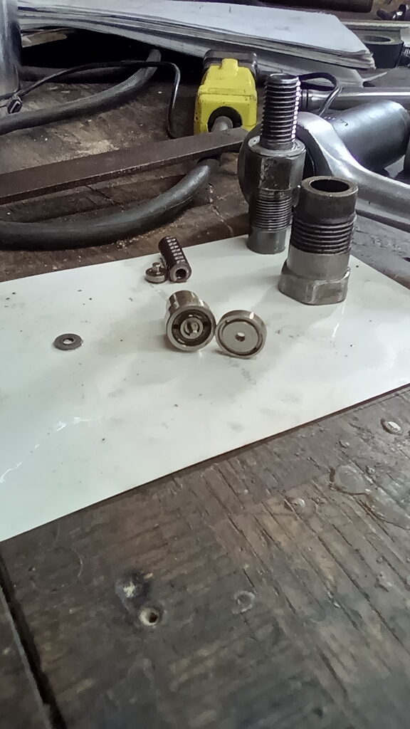

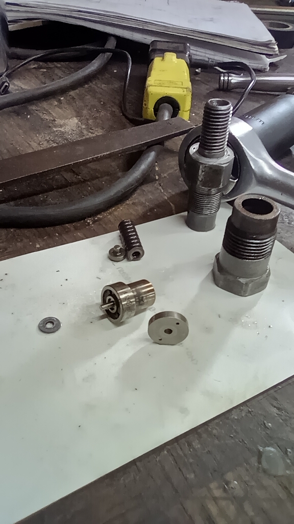

I'm hoping someone can help me with this. I took injectors apart and I'm not sure about reassembly. I didn't pay close enough attention when I took them apart. The nozzle body has a race groove and the matching disc that mates to it also has a race on one side and smooth on the other side.. Should these races be together or should the smooth side face the race on the nozzle body.Thanks

Smooth side to the nozzle..
U took the time to take it out of the engine, clean it up, take it apart, buy new gaskets and NOT replace the nozzle.?!!
Nozzles are like spark plugs.. to find the GOOD ONE, throw them in a bucket of water, the good ones will float..
In other words, u took all that time.. replace the nozzles..
