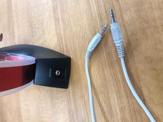

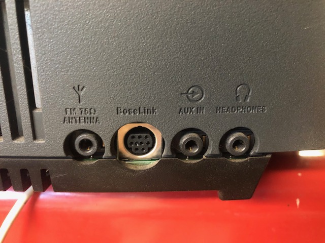

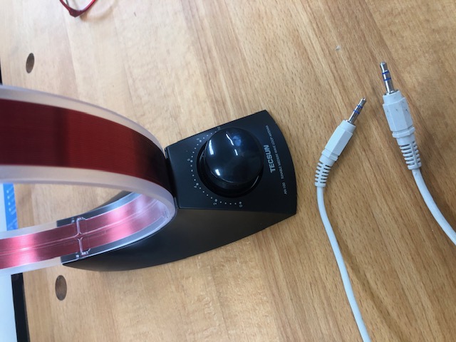

Okay, this topic was recently broached somewhere here but after a couple minutes of digging, I decided to start a thread on the subject.
I have an AM/FM/CD portable radio in my shop. The AM reception sucks. We live quite aways from the stations so lots of static.
Replaced the fluorescent fixtures with LED 4ft fixtures (not just the light bulbs). The RF issues are gone now, at least it is far better than before. Turning on/off the LEDs do not result in any change of static like the fluorescent fixtures.
I bought an AM antenna...
Amazon.com: Kaito AN-1 Tunable Passive AM Radio Loop Antenna for All Brands Like Kaito,Sony,Panasonic,Grundig and More: Home Audio & Theater
and that is not doing a bloody thing good or bad, but I am plugging into the FM antenna jack. No AM terminals on the back.
Any suggestions on how to McGyver it? Do I need to break into the radio case?

First thing is to send back that so called AM enhanced antenna thingy if you can.
Then break into the radio and see if you can find the ferrite loopstick antenna. Wrap a few turns of small diameter wire around the loopstick. and then hook to more wire you run either inside or preferably outside. Use insulated wire, and preferably and end insulator. Run as much wire as you can conveniently. Try 20 or 30 foot, but do't be afraid of 100 or 200 feet.
This will be inductive coupling, don't try to hook to any of them funny littel wires. ideally what I would do is bring out a machine screw to the back of the plastic radio case for my permanant connection and then would be free to try different lengths and positioning of the outside wire at will.
Call me on the phone if you need personal one on one assistance.
