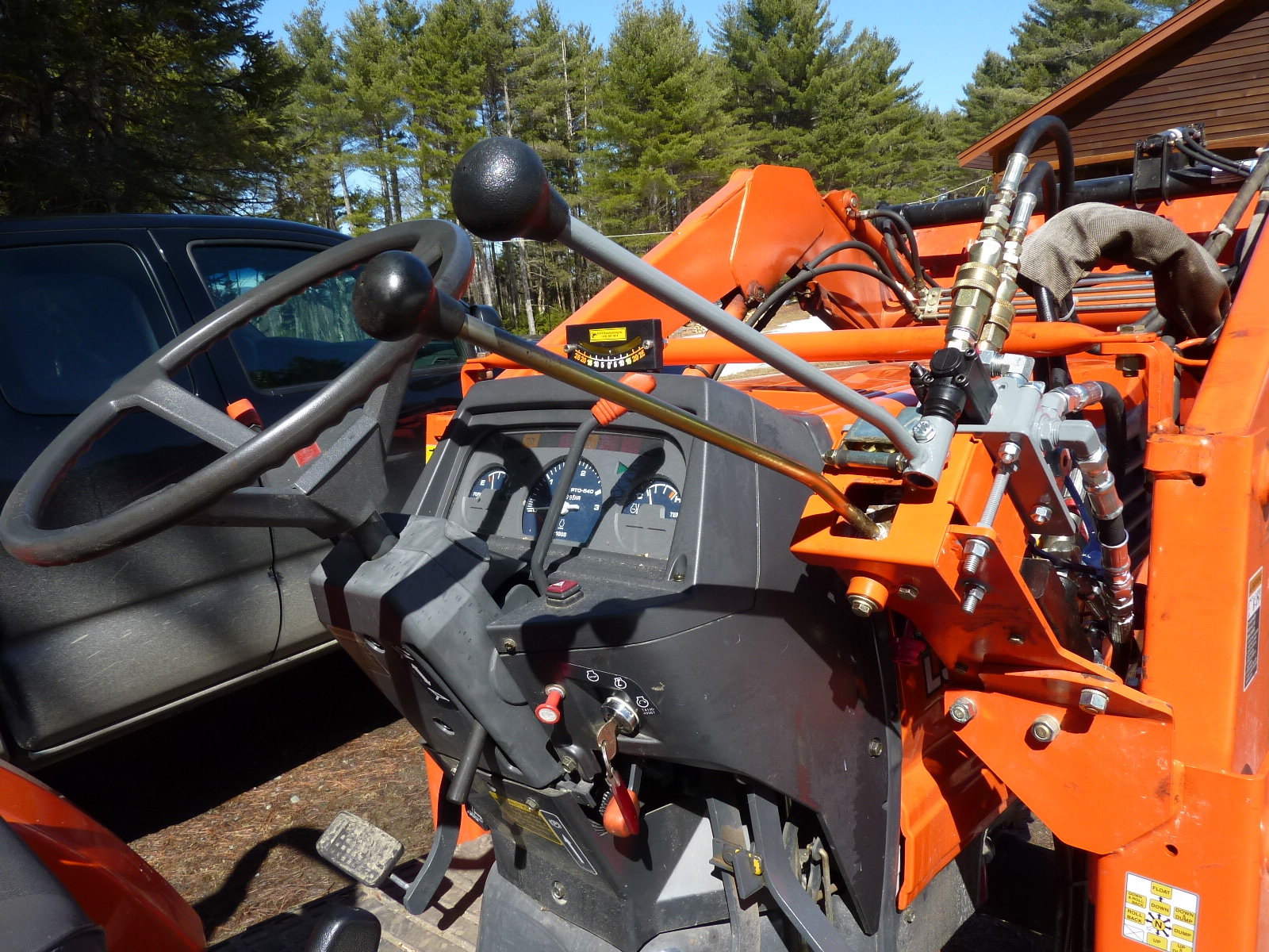

Yesterday I got a call from one of my neighbors that the ruts in front of their house had become so deep that they couldn't get their 'summer' car (Mustang) out due to the bottom dragging on the road, they didn't have any issues with their Forester. I was able to cut down the crown and fill in the ruts some, enough for them to get their car out. But it also taught me that there is going to be a bit of a learning curve to get this done right. I used my old Mark 1 eyeball when I did this, it looked good from the tractor but when I walked it later.. not so much. I can also see making some extensions for the levers for the remotes to make it easier to control the TNT on the fly.
