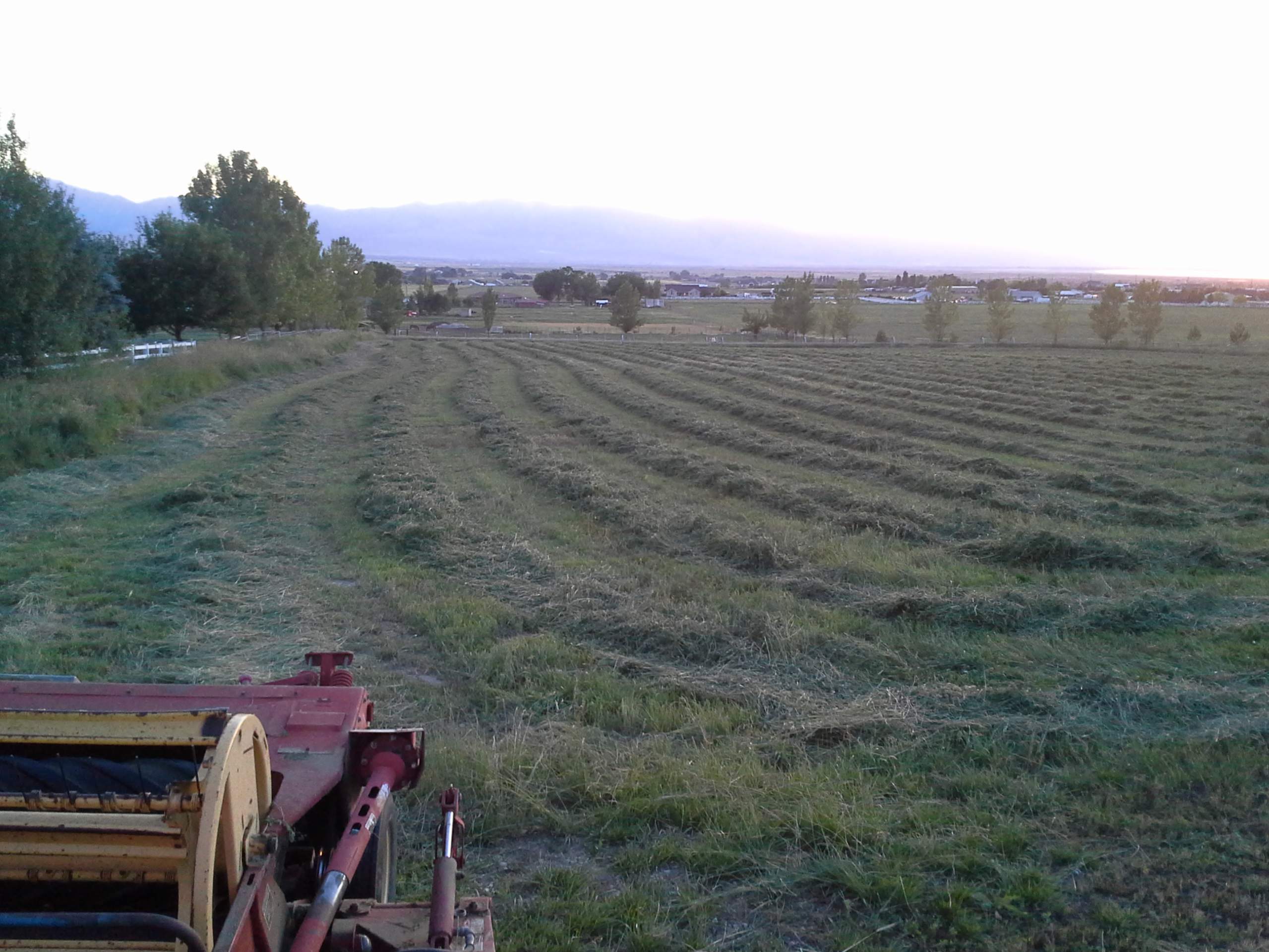

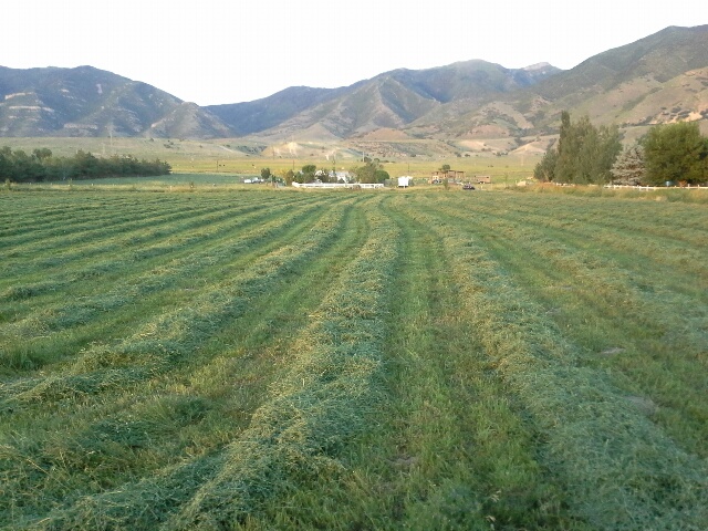

Hi Dave, I just come across this thread and find it very interesting. I have an older NH 488 haybine, it works good but more costly repairs are certain to come. I will be looking into a drum mower within a few years. Here is a picture of a field I cut last night. It was very thick, but I cut 5 acres in 3 hours. 20150615_190110.jpg20150616_205234_resized.jpg20150616_210110.jpg

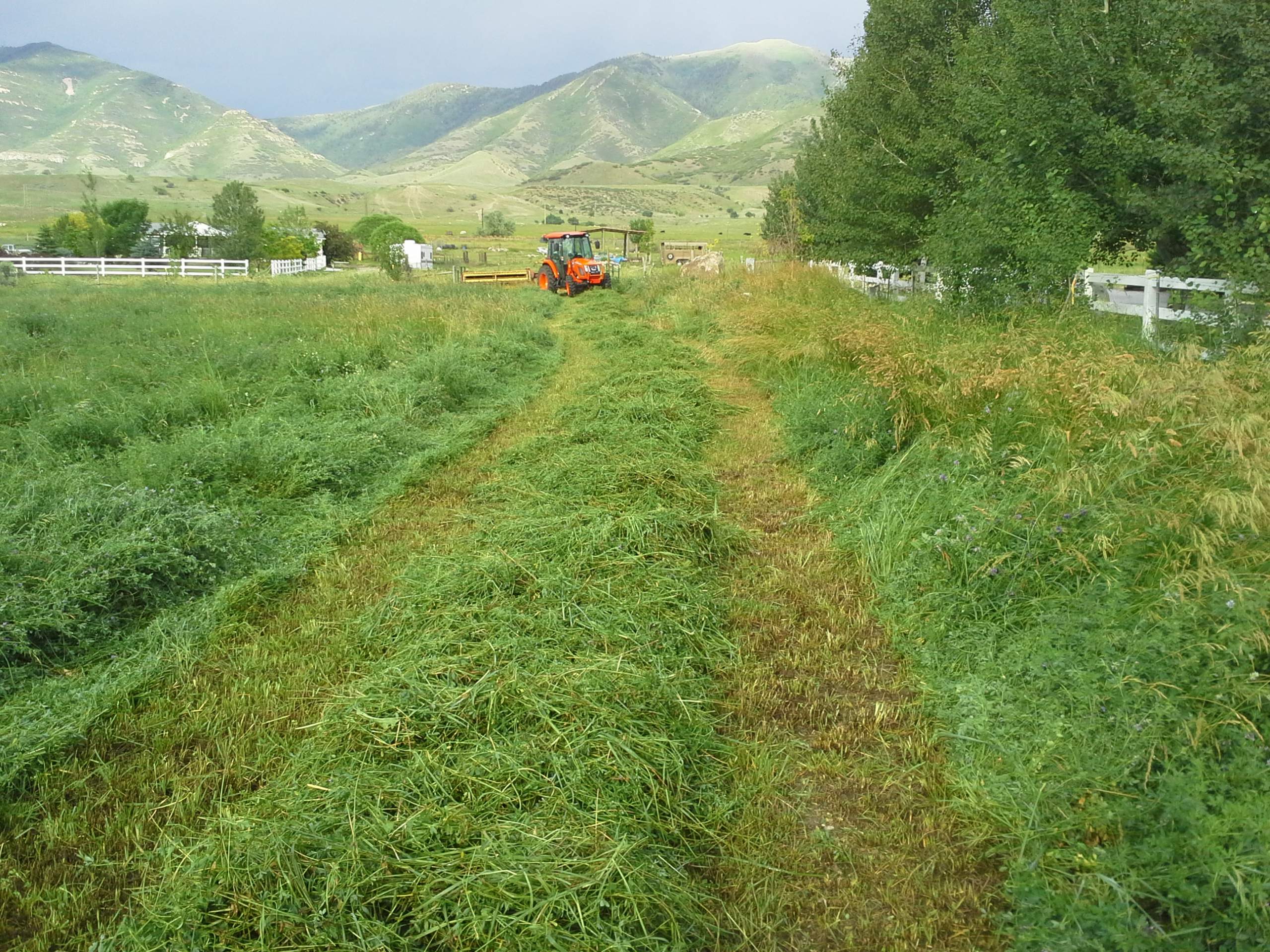

The picture you posted to start the thread was picture perfect, awesome field.
