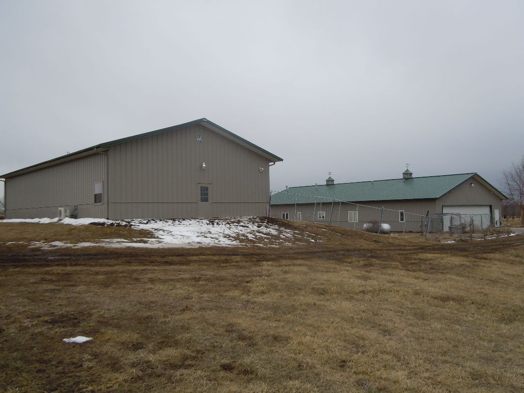

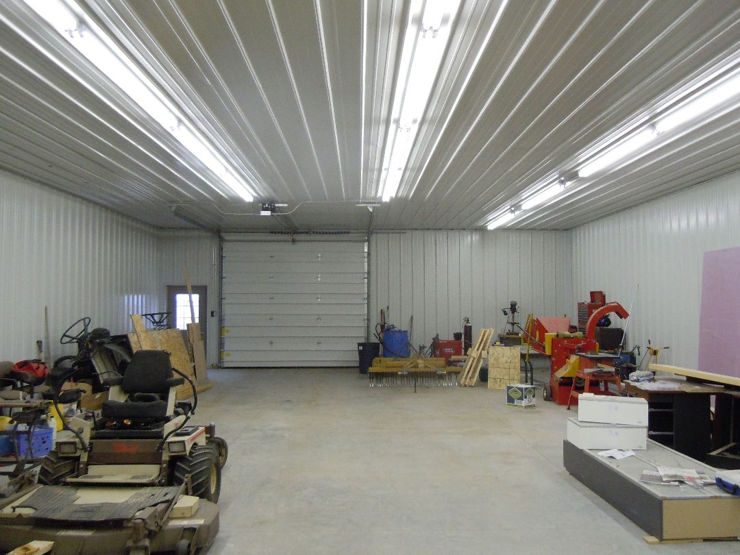

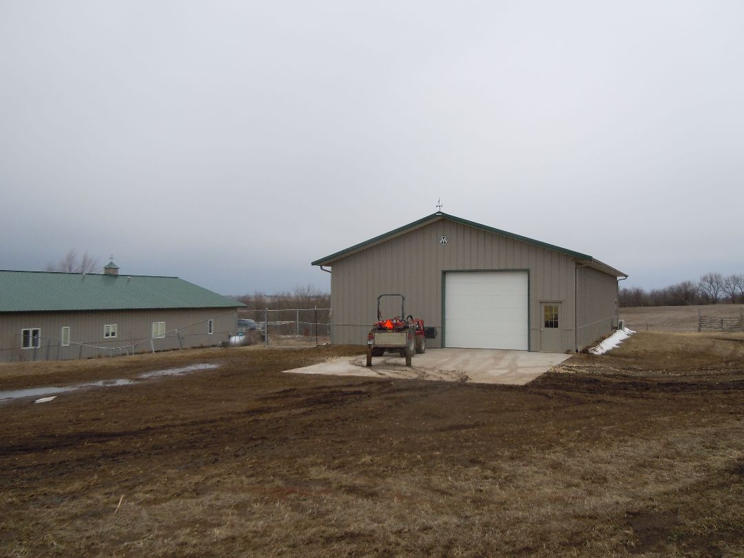

Your shop sounds great... any pictures?
Here are some. I and my wife constructed the inside walls, hired a guy to do the drywall and then we finshed the guest room. When it gets warm we will tile the bathroom and finish my office.
