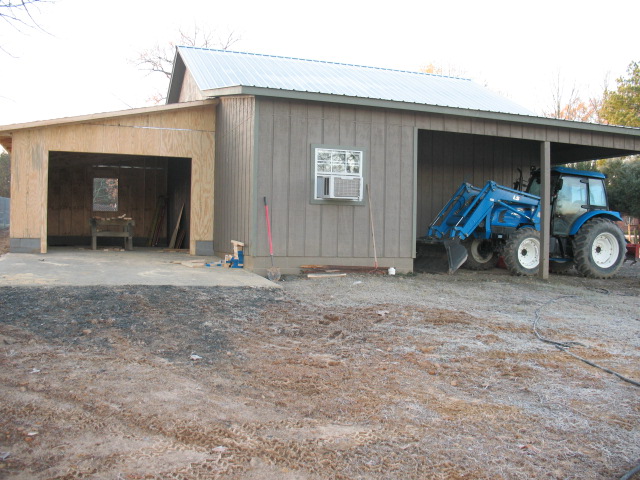

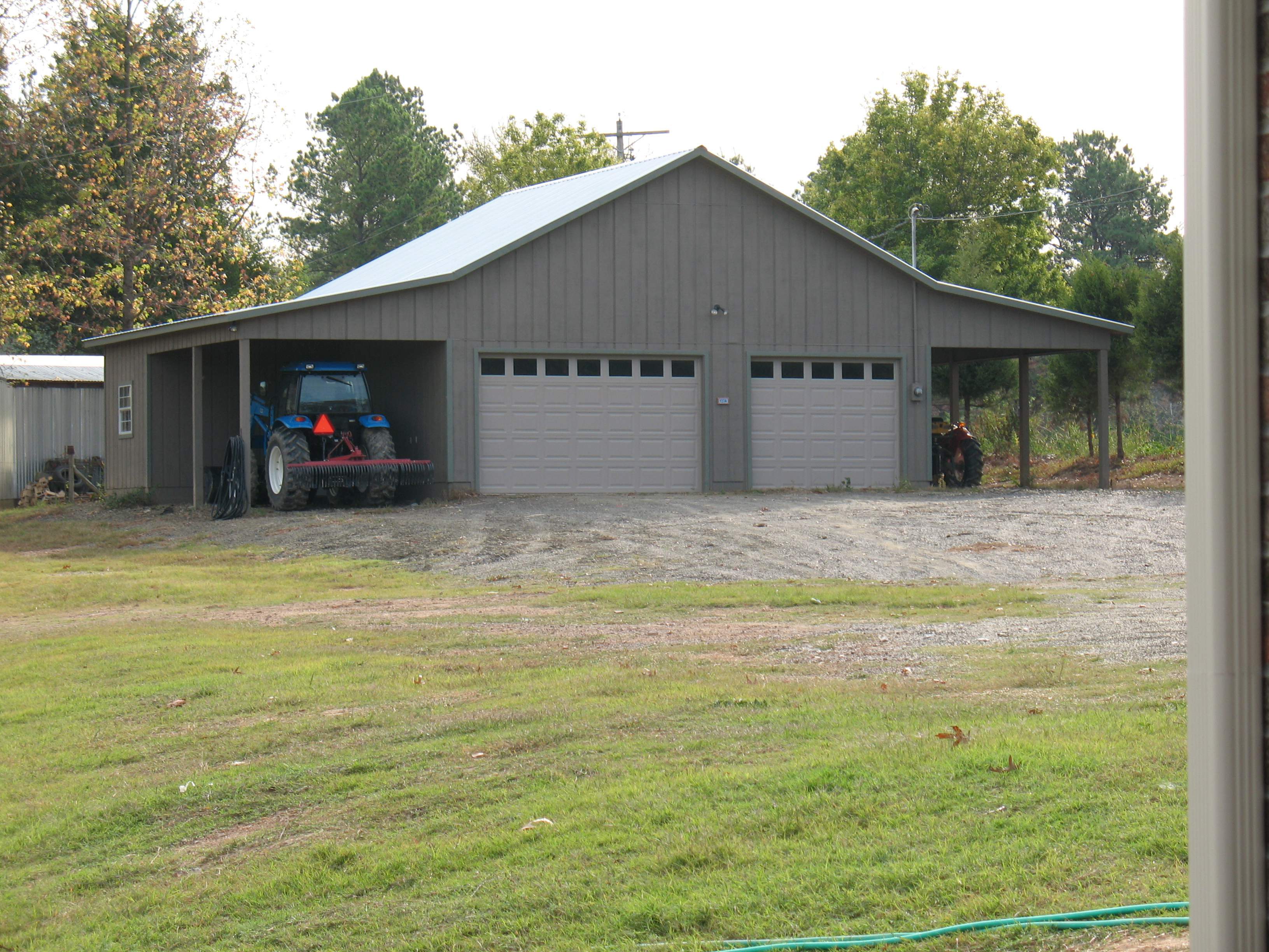

I built mine 30'x50'x14' on a 40'x50' pad. Two 12' rollup doors and 2 walkthroughs. Cost was just under 30k. The extra 10' on the side is for the next part of the building and that's where the horse stalls will go. Not on the concrete that's for access. The main building is done the horse area and the equipment area come this summer. Did most of the labor myself. The completed pictures haven't made it to this computer.

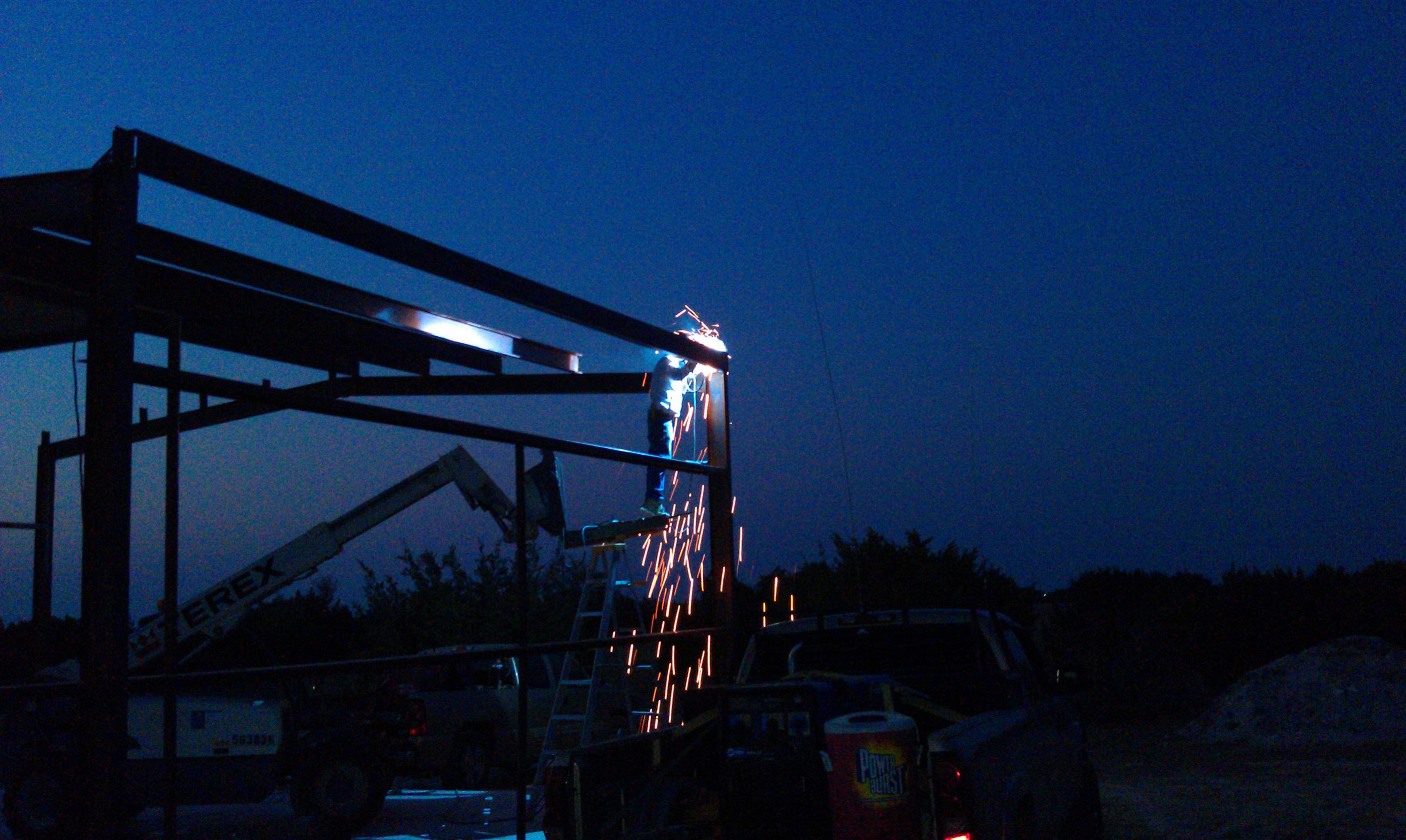

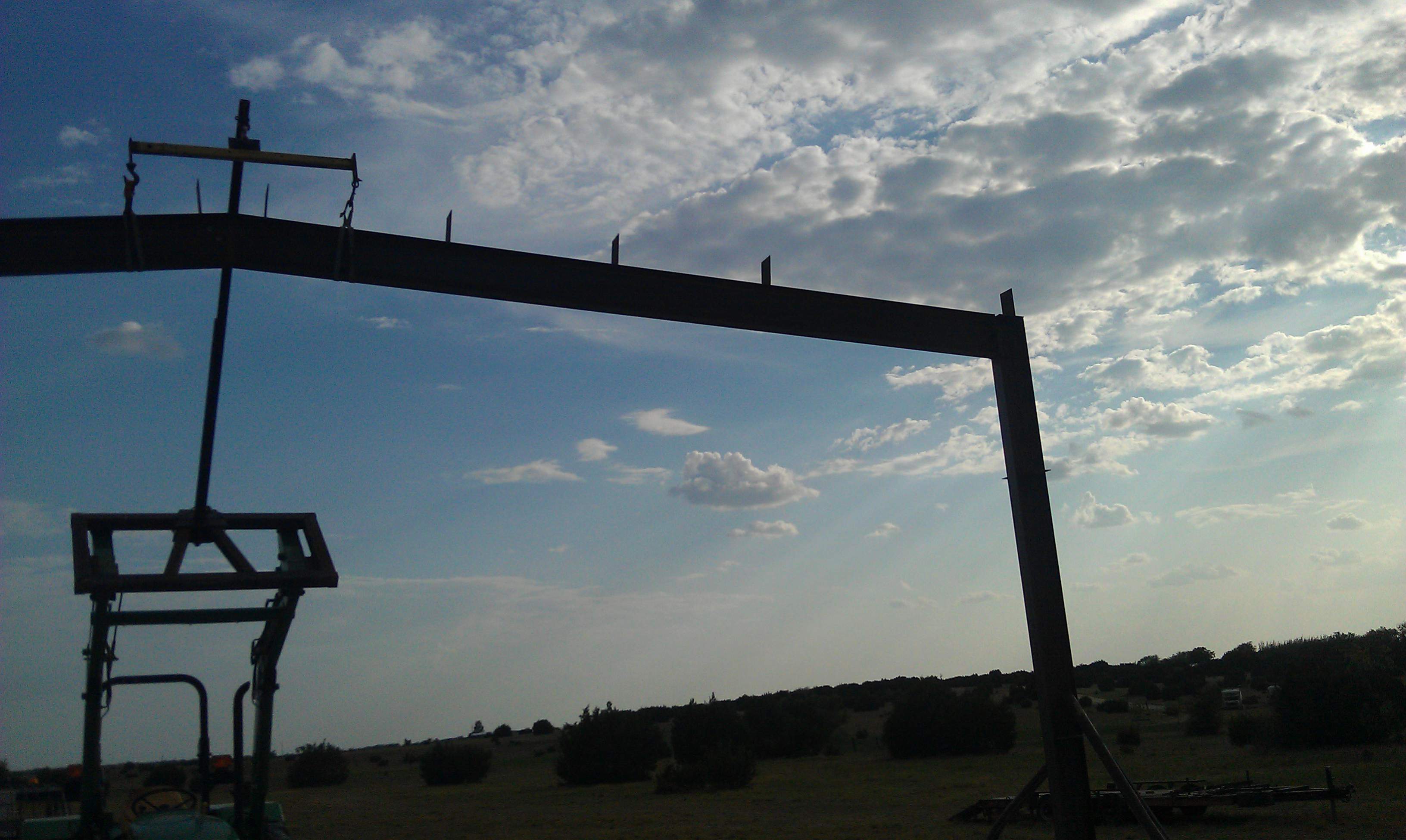

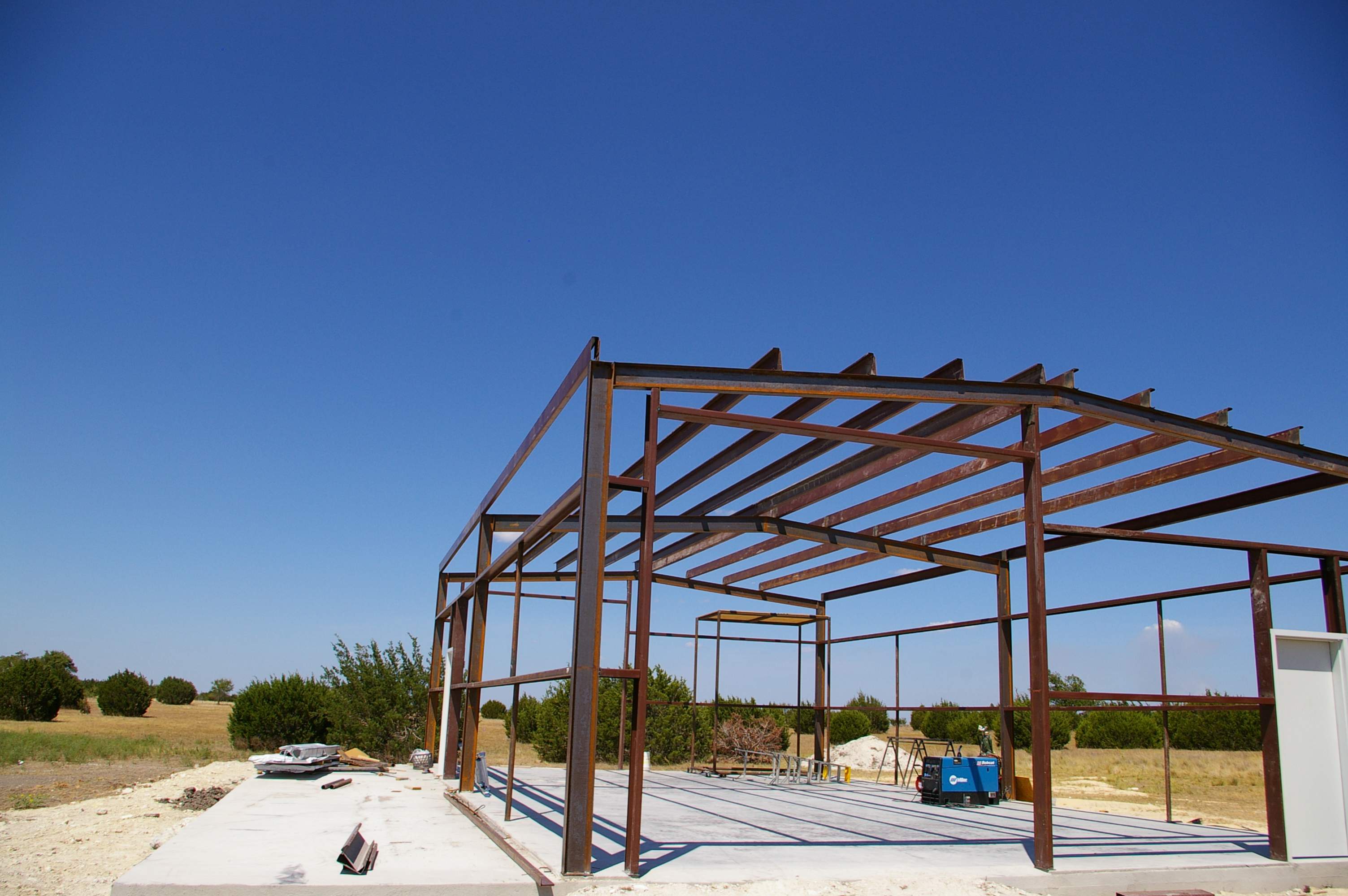

I built my 24' X 36' back in 2003. I did all the site prep, dug the footers, put in the re bar, vapor barrier and formed up for the slab. Pouring the slab I had help from friends and family. Building the steel structure I designed and built the shop out of 2" sq steel tubing and also 4" sq tubing. I did all the welding and stood the shop up by myself. I then installed the sheetmetal roof and skylights. I then installed all the siding. For the doors I built barn style doors. I wouldn't go with the barn style door now, just because the wind blows them around to much when I have them open. I too am looking at building a new shop hopefully a 40'x60'x14'. I think if you do at least the steel work you can do it for under 30K. I would highly recommend a full slab and then after it cures, to paint it with concrete epoxy paint. I painted my shop floor and it makes it so nice.
