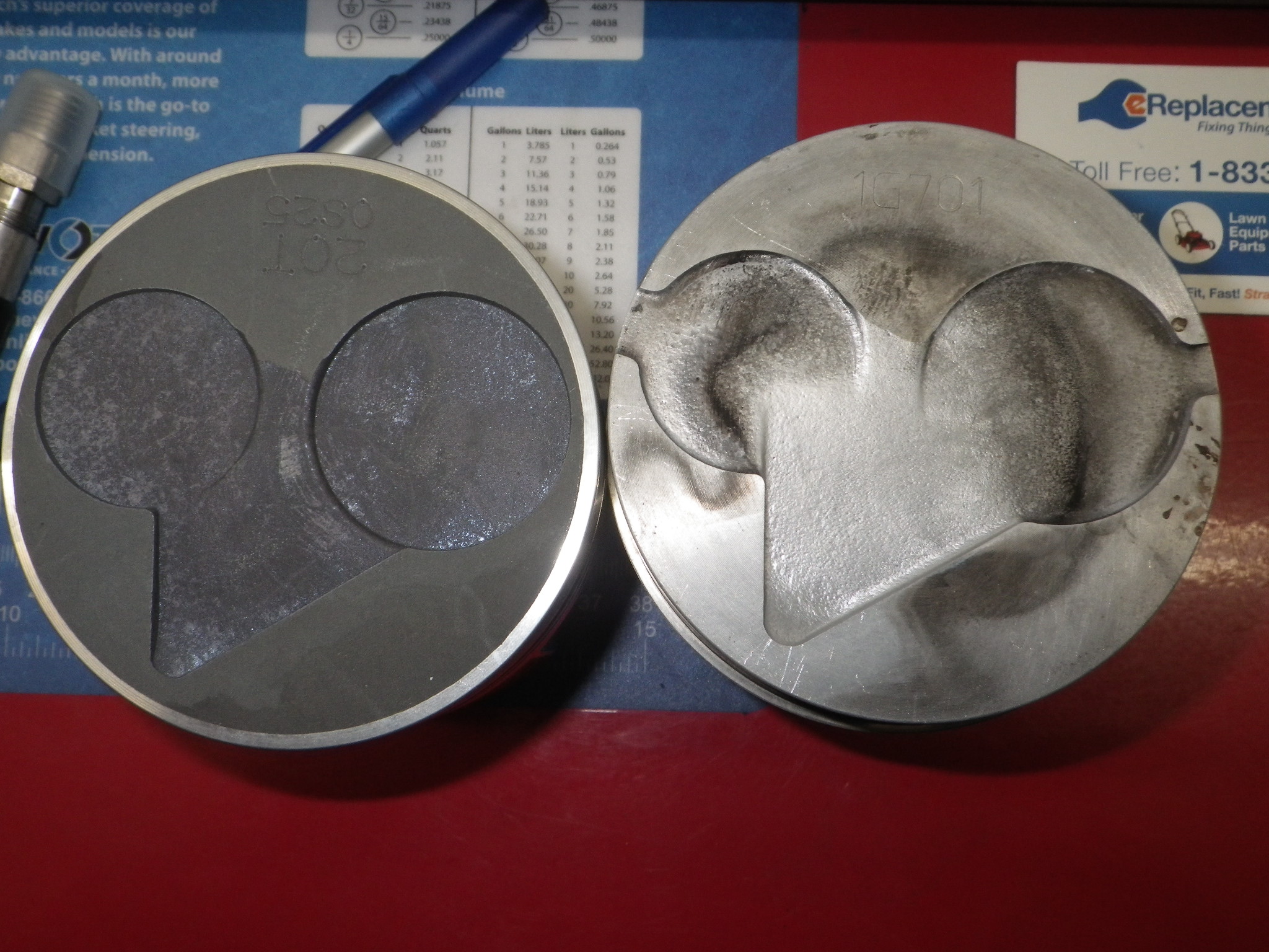

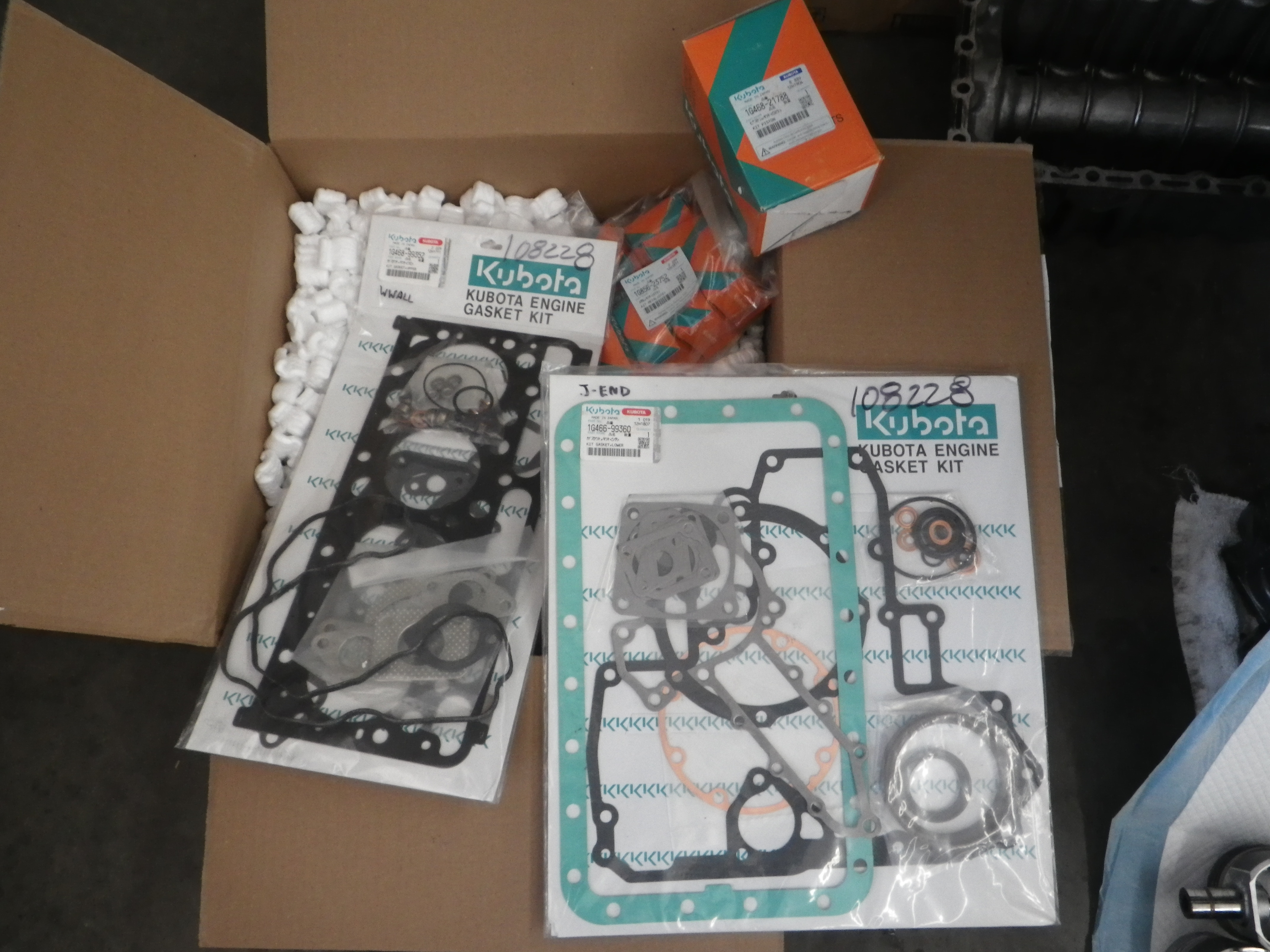

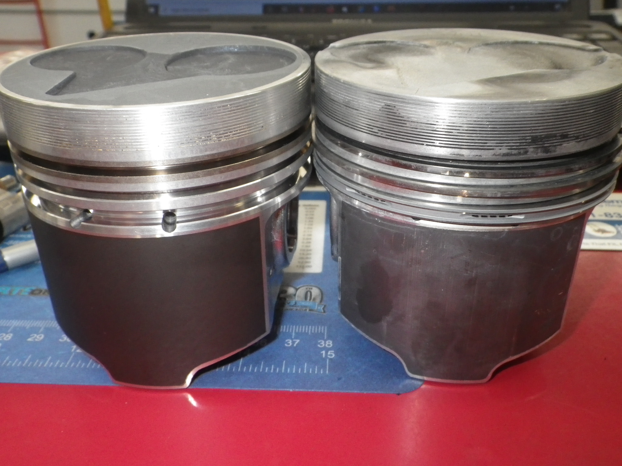

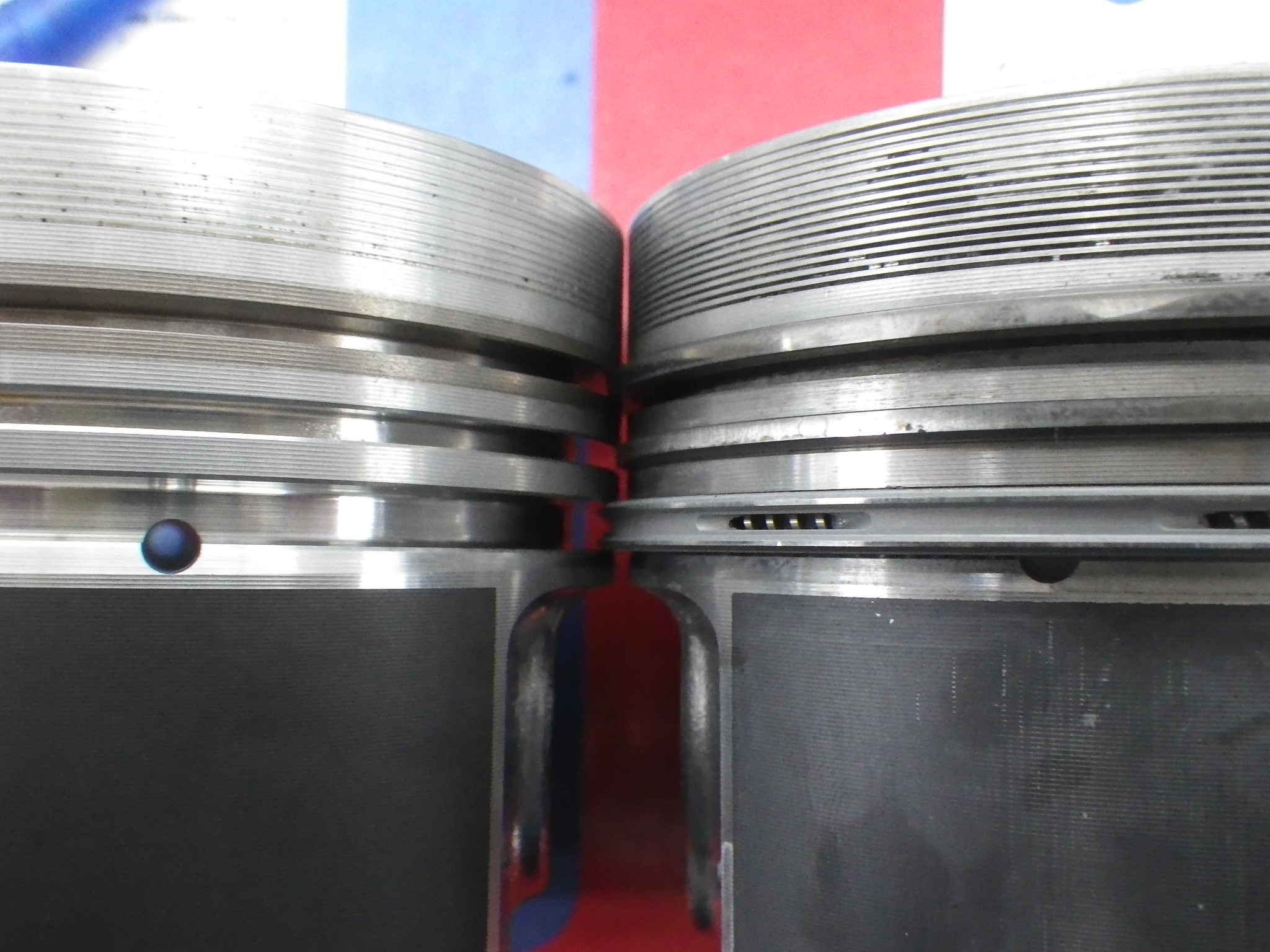

Kit came today, all pistons, Bearings, seals to rebuild this thing.
Turbo pistons have a different top and the upper ring land is steel or hardened whatever. View attachment 637520View attachment 637519View attachment 637518View attachment 637521
Looks like the turbo goes back on this lemon. I had no idea one can purchase the whole kit quite a stretch cheaper then buying just pistons and gaskets from a tractor dealer. What an eye opener.
Wow, Fred what a bummer on the aftermarket replacement pistons,
Glad you found someone that's in the know... with access to correct full factory kit for the turbo version.
Looking at the pics,
Yeah the new Kubota pistons look like not only is the ring land steel supported, it also (appears) like the piston crown is actually all steel to??
Wondering if you could check that with a magnet?
If I am reading the pic correctly?? Kubotas piston for turbo engines not only employs a steel ring land cast into the piston but also the entire center of the crown. makes a lot of sense in that it should mimic all steel pistons with reduced dimensional change when put under boost /heat.
If it is not a steel crown center- is that possibly a thermal barrier coating, - another way to reduce crown and overall piston temperature.
Following with interest. and Maybe just me, but Great to see the Turbo going back on.:thumbsup:

Neither the ring land or piston crown are magnetic.
I have a new Audi 2 liter piston here also with a steel ring land, that one isn't magnetic either.
The Kubota piston does look like the crown is a different alloy.
