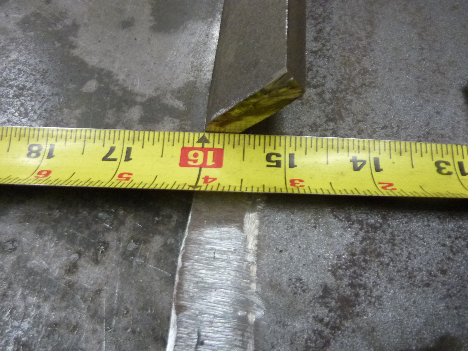

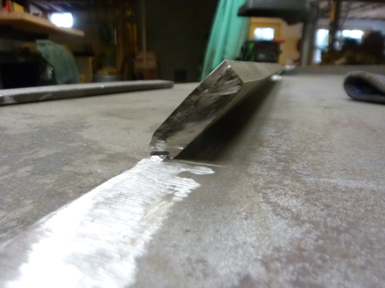

I thought about sending it back but the way I see it I have little to gain. It would be on principle and a hassle. And if they are as bad as jmc says who knows what the next one would be like. I am not really out much money if any as I couldn't buy the steel to make one for any less than I paid. I have learned my lesson on Titon w/o any hard feelings.

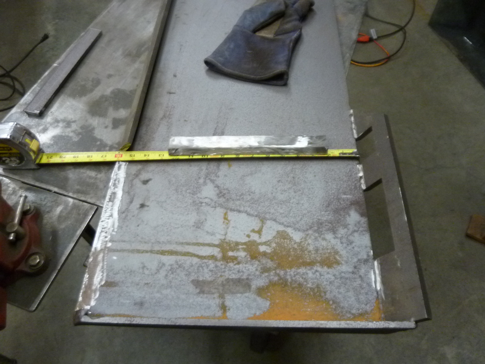

So I put the grinding wheel on the right angle grinder upside down and went at the back side of that top pocket on each end where the loader pads sit. I took off 50 or 60 thou and a little more on the edge to open the angle a bit. When I mounted the plate the bottom pins locked properly w/o any force on the plate so I gained some but the loader pad faces were still not in contact with the back of the plate. I could see I wasn't going to get there with my grinding scheme unless I took off a whole lot more. So I will cut out two 10" sections from the top and do it right by welding in what I need.
On a side note RE: the 16" dimension on the drawings DownSizing provided I took a very thin machinist's scale and measured from the inside apex point of the angle on top down to the end of the flat on the bottom on 3 different plates
1) Kubota bucket measured 15-13/16" - fits fine
2) FrostBite log grapple measured 15-11/16" - also fits fine
3) Titan 5/16" SSQA plate measured a weak 15-5/8" - would not fit properly even after grinding almost a 1/16"
So it would seem that 16" dimension doesn't mean much to mfgrs. On my tractor going that big might make for a sloppy fit as my bucket has the slightest wiggle to it if you use a bar.

Looks like they were 1/2" to long from that thread. Now they are about a 1/2" to short, mine anyway :mad:
The angle is right on 45* and there is no weld bead up in the point of it so that is good
But the plate is only 16" and they took up about a 1/2" with the angled 3/8" lip. Makes the 16" mount dimension opening a tad tight.
As you can see I am in the process of fixing mine. I would be done but I need to come up with some 3/8" flat bar.

Just got replacement mount for Titan and have not been able to check to be sure it fits but two things right off: it does measure the overall height is is suppose to be of 18.5 inches and this one is not welded top and bottom but is a looks like a computer cut piece of metal for the total mount with the top, bottom and sides all being bent. Quick look in fading light only see welds on the four corners.
Unless there is something we missed with tape measure very pleased with the way Titan has handled this. I called them last Wednesday, Jan 2nd and replacement arrived about 5:15 PM. Pleased me very well. Nothing yet on how to return the defective mount to them. Obvious two different designs in the two mounts.
