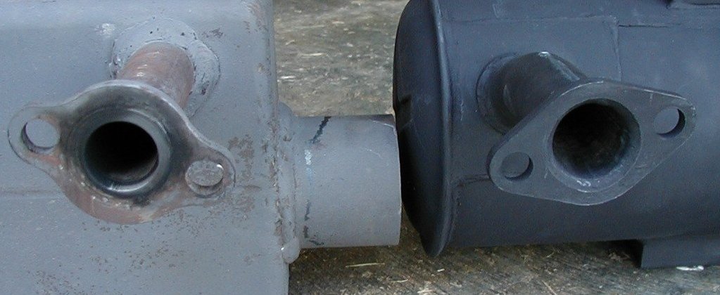

I have been concerned for some time that the Power Trac built muffler had back pressure problems, resulting in the engine running hotter than it otherwise would. Originally, I was going to rig a setup to measure the back pressure and see if it was within limits or not, but I never got around to it, and with the summer heat rapidly approaching, I decided not to risk taking the time to do it.
After running the machine for a month with the new muffler, here is what I have found.
1. It's slightly noisier with a bit sharper tone. I actually prefer it, since I can sense the engine RPM better through the shooting muffs I wear when mowing. It is certainly not objectionably loud.
2. Power seems to have improved slightly, but only slightly. I am a little puzzled by this, considering the other results.
3. Fuel consumption has dropped dramatically. One particular regular mowing job used to take about 4/5 of a tank. It has dropped to a consistent 2/3 of a tank, roughly a 20% improvement.
4. Run-on is no more. Before, no matter what throttle setting we used, we got significant run-on at shut down, unless we let it idle for at least 30 seconds. Even then, we often got it, especially on a hot day. Now we get none, even if we just shut down immediately. Yesterday I mowed for three straight hours in 96 degree temperatures and still go no run-on at shut down.
5. The under the hood temperature seems no higher, and the battery isn't any hotter than before.
6. The hydraulic cooler air flow isn't any hotter, but the flow seems to have a little more volume. Perhaps this is due to the round muffler disrupting the air flow less than the boxy PT muffler.

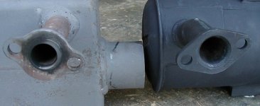

The attached photo shows the manifold openings of the two mufflers. The PT muffler is on the left. You can see that the Kohler muffler has larger, smoother openings. The PT muffler is under sized, apparently to use a standard pipe size.
It's a little hard to tell in the photo, but the PT muffler's welding is sloppy and the pipe isn't centered in the flange properly.

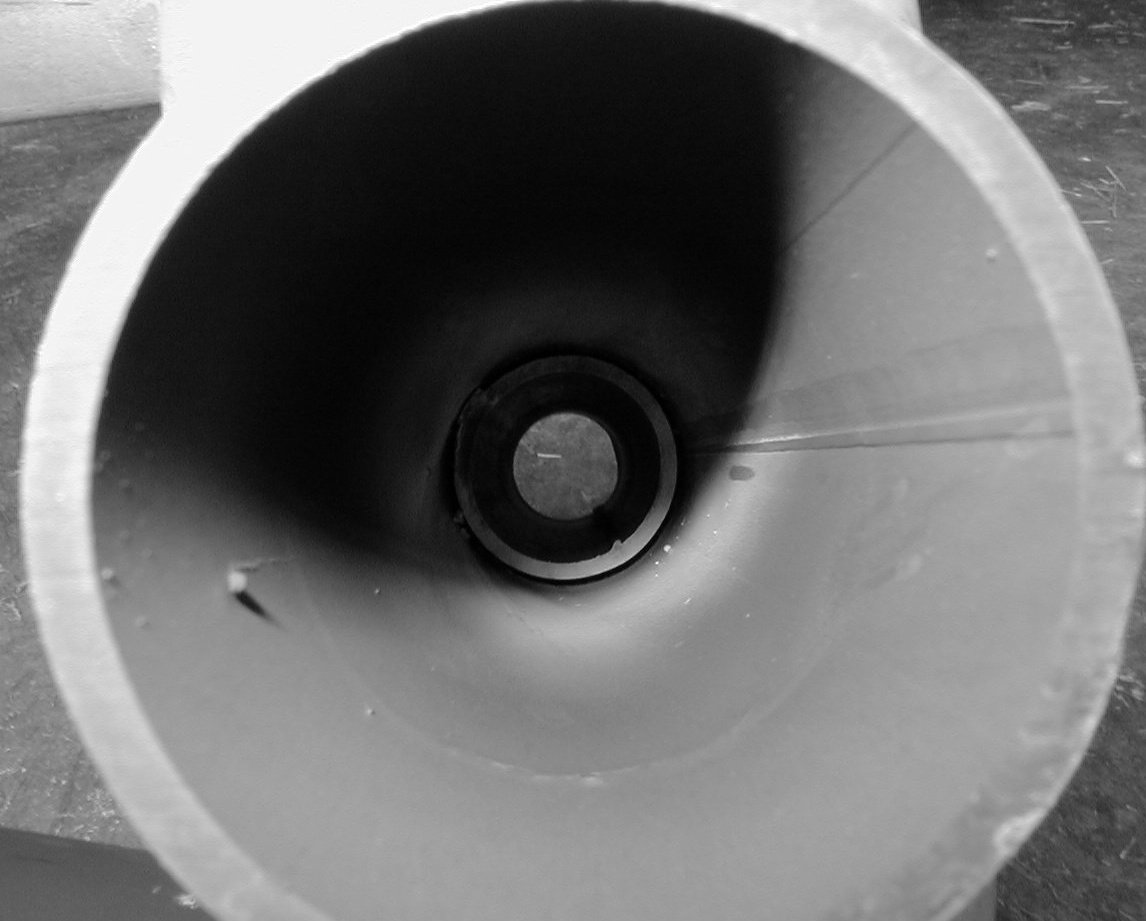

The attached photo is looking into the exhaust pipe. The bright spot in the center is the intake air opening. The exhaust gasses are forced through the ring opening comprised of the outside of the air intake pipe and the inside of the exhaust pipe.
Note that it is really quite a small opening. Also note that the muffler was welded up with the inner pipe not quite concentric to the outer pipe, as it should have been. Sadly, whomever built it did not bother to clean up the pipe cut. You can see a large bit of flash left over from the cut in the upper left hand corner. /forums/images/graemlins/mad.gif
There is also some sort of detritus lodged between the walls of the two pipes. There is also some carbon build up that doesn't show in the photo. All of this has led to an opening that is more restricted than the designer probably intended.
Some day, when I get the time, I will probably take a torch to the muffler to see what the rest of the guts look like. I may see if I can modify it to lower the back pressure. I think that will require replacing the manifold pipes with a pair of the right size and smooth shape. Fortunately they are available from Kohler--for a price of course.
