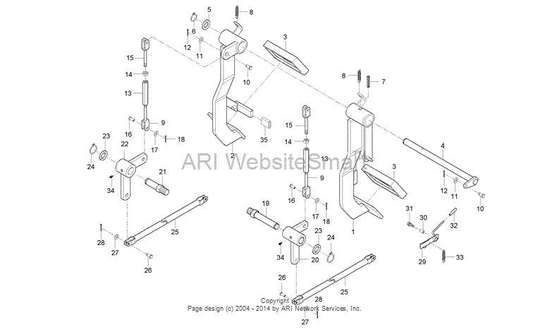

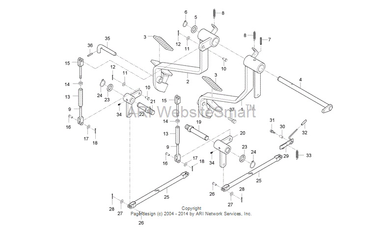

Here's a schematic to the two types of pedals listed for the CK35.
   / I Feel Like an Idiot... #12
Deerherd, is part # 35 the coupler that locks the pedals together? From Tony's description, this doesn't sound like what he has.
   / I Feel Like an Idiot... #13
I updated my post and put up the two types listed for the CK35

You should be able to do this without any tools. Can you just unscrew part #35?
   / I Feel Like an Idiot... #17
I would not do anything to split them . Our ck 30 HST is like Diag. 2 . I tried the 2-foot turn and it just doesn't work ! If you ask me their should be 1- peddle .
#18

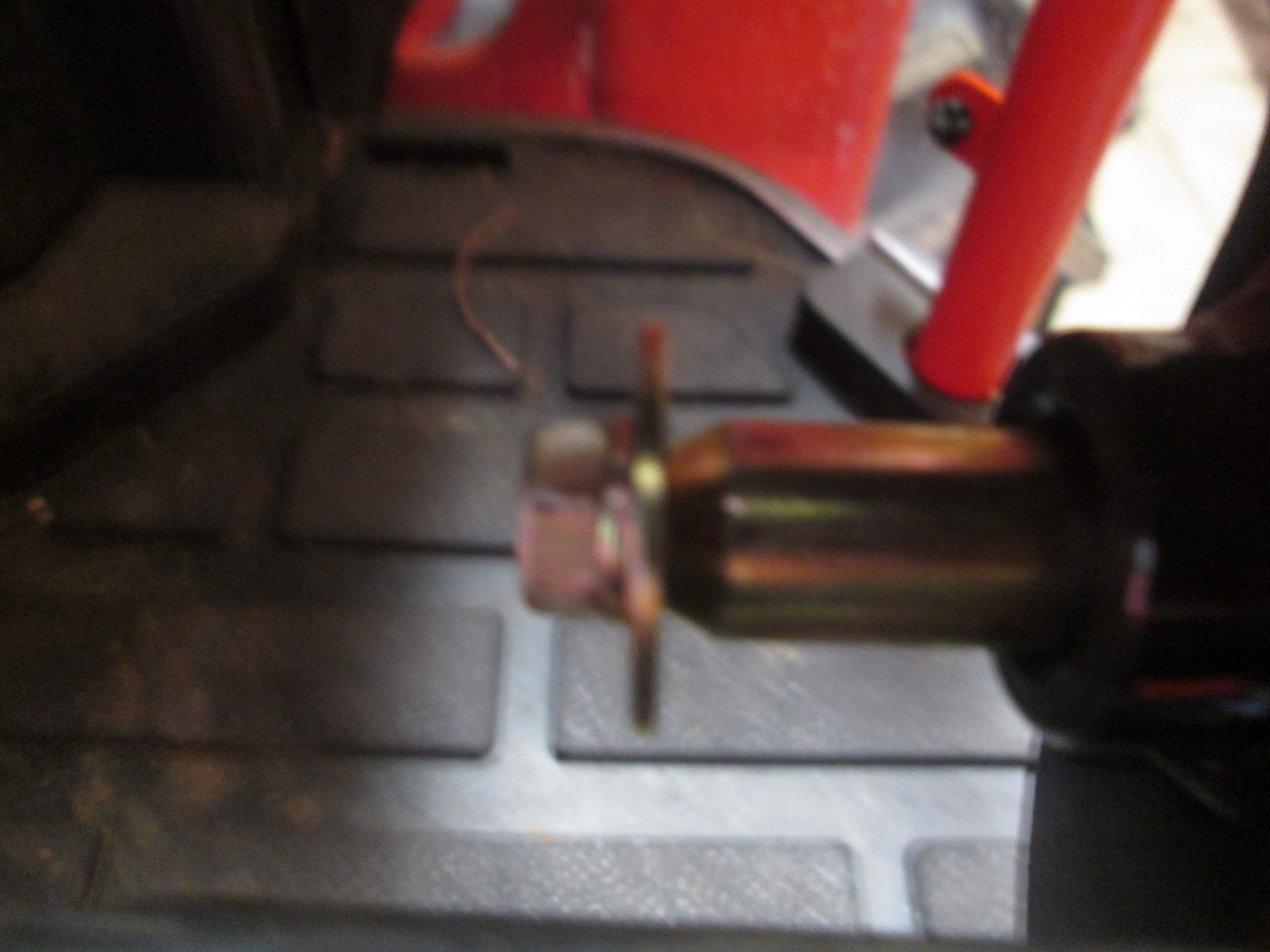

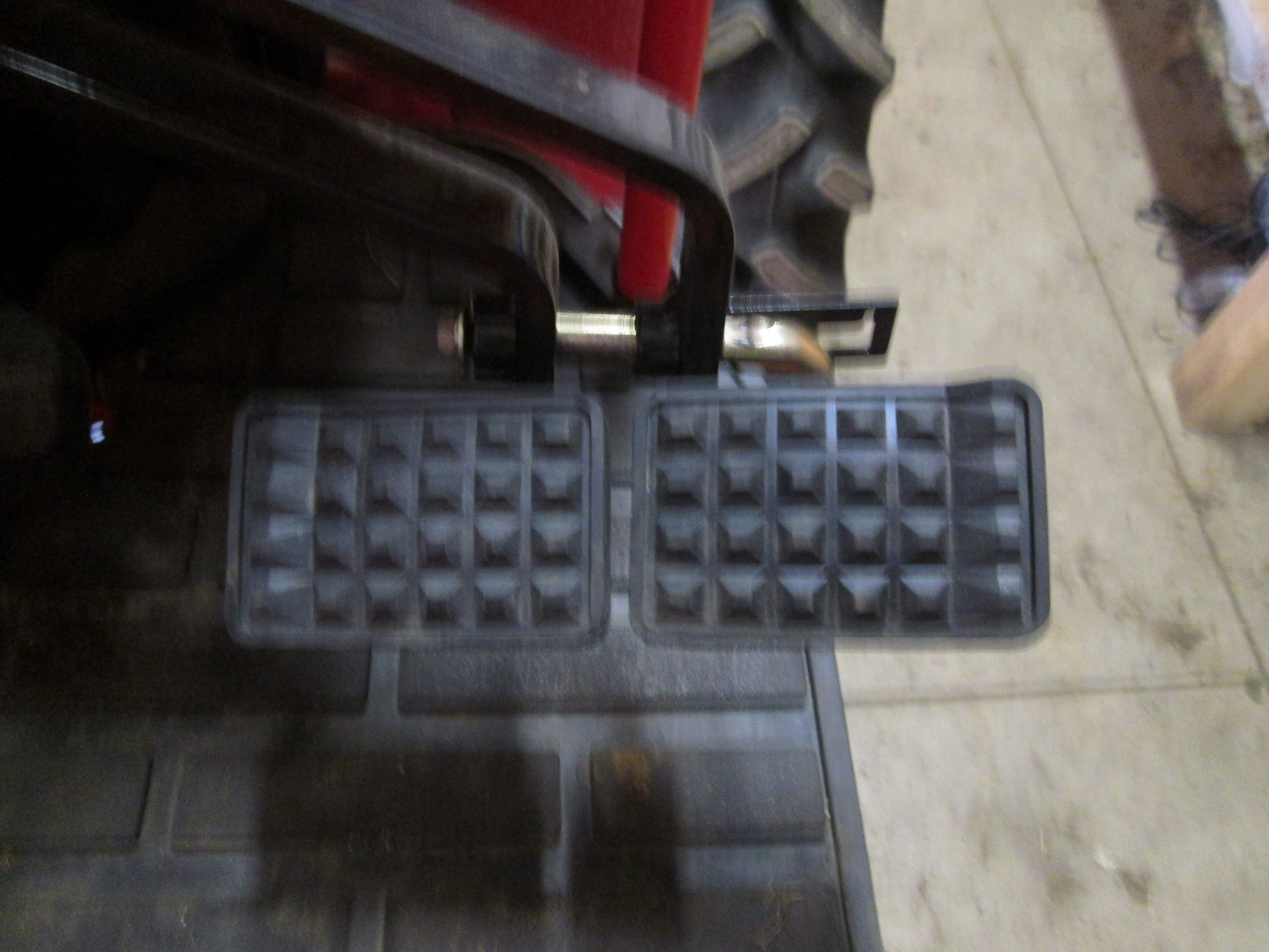

No, the bolt (Part #37) is what is holding the rod (#35) from sliding, and I can not get it to budge. I know that in practicality I'll almost never use split brakes, but I want to be able to do it.
OK, here are the pics.
The first is a close up of the problem bolt (#37) where it attaches to the rod (#35). The 2nd is the whole assembly with the rod slid inboard, the 3rd is the rod slid outboard as far as it will go.
Hope this will lead to some answers
   / I Feel Like an Idiot... #19
PB Blaster or Kroil would be my weapon. Supposedly there's one better but I have not found it again.
