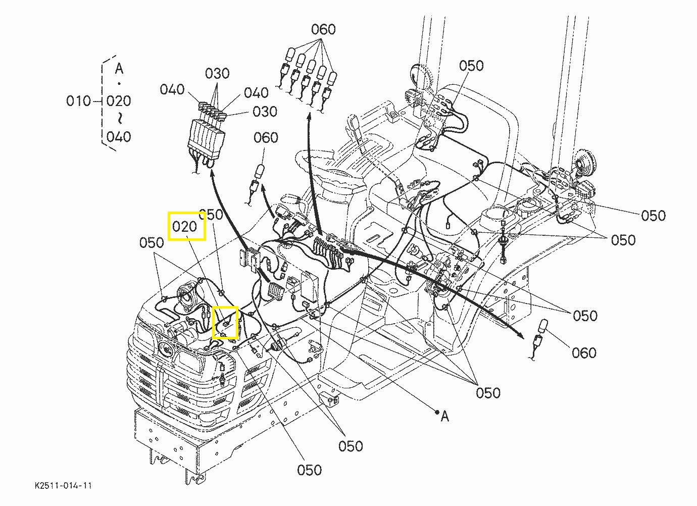

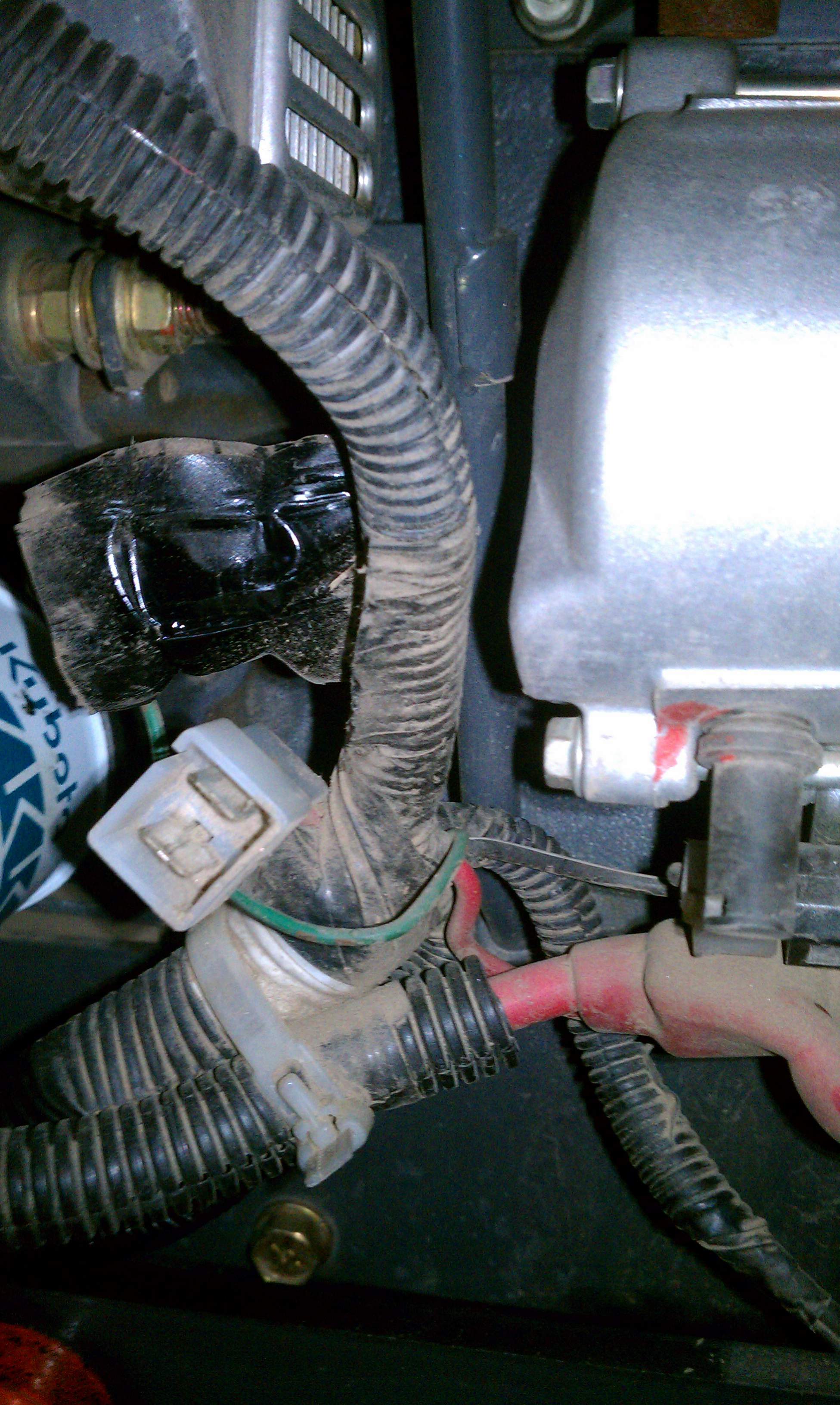

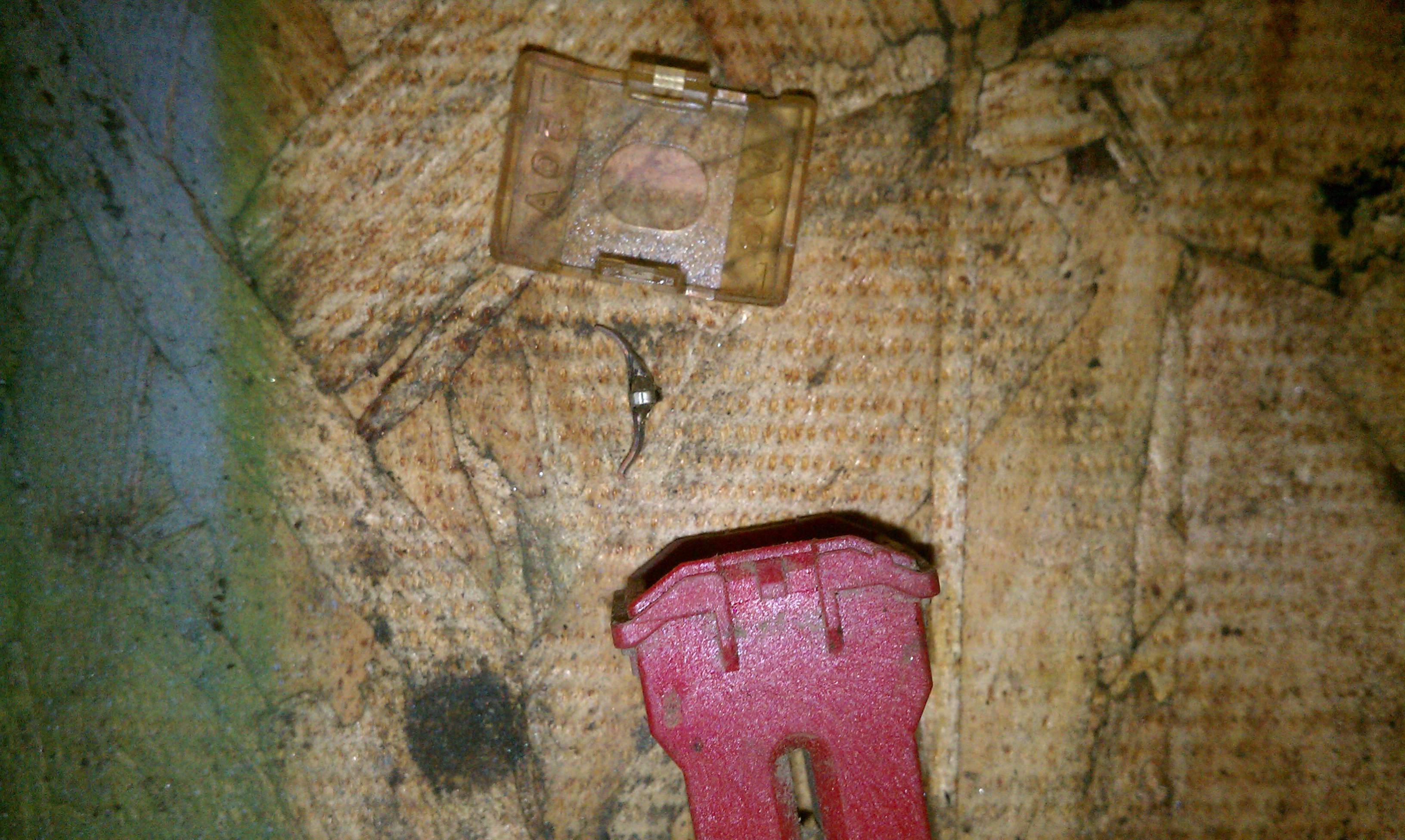

Alright fellas, I appreciate all of the responses. They have been helpful in providing a starting point for me. That said, I think I'm on to something. I began tracing the start-run circuit this evening with my multimeter and noticed a 30amp fuse that was rattling when I removed it. I don't want to jinx myself but I think this may be the problem.
View attachment 337353View attachment 337352
On the cover in the 1st pic it looks like it says 50A. Also, the parts looks more like a diode than a fuse. Glad you got it going.
   / I did a bad (dumb) thing...
#36
Pretty good eye. When I zoom in it does look like it says 50amp. That said, here is the replacement part name and part number as described on the Messicks website. 51950-29320 Item 020 30amp Don't think I have anything on my little Kubota that would require 50 amp protection
