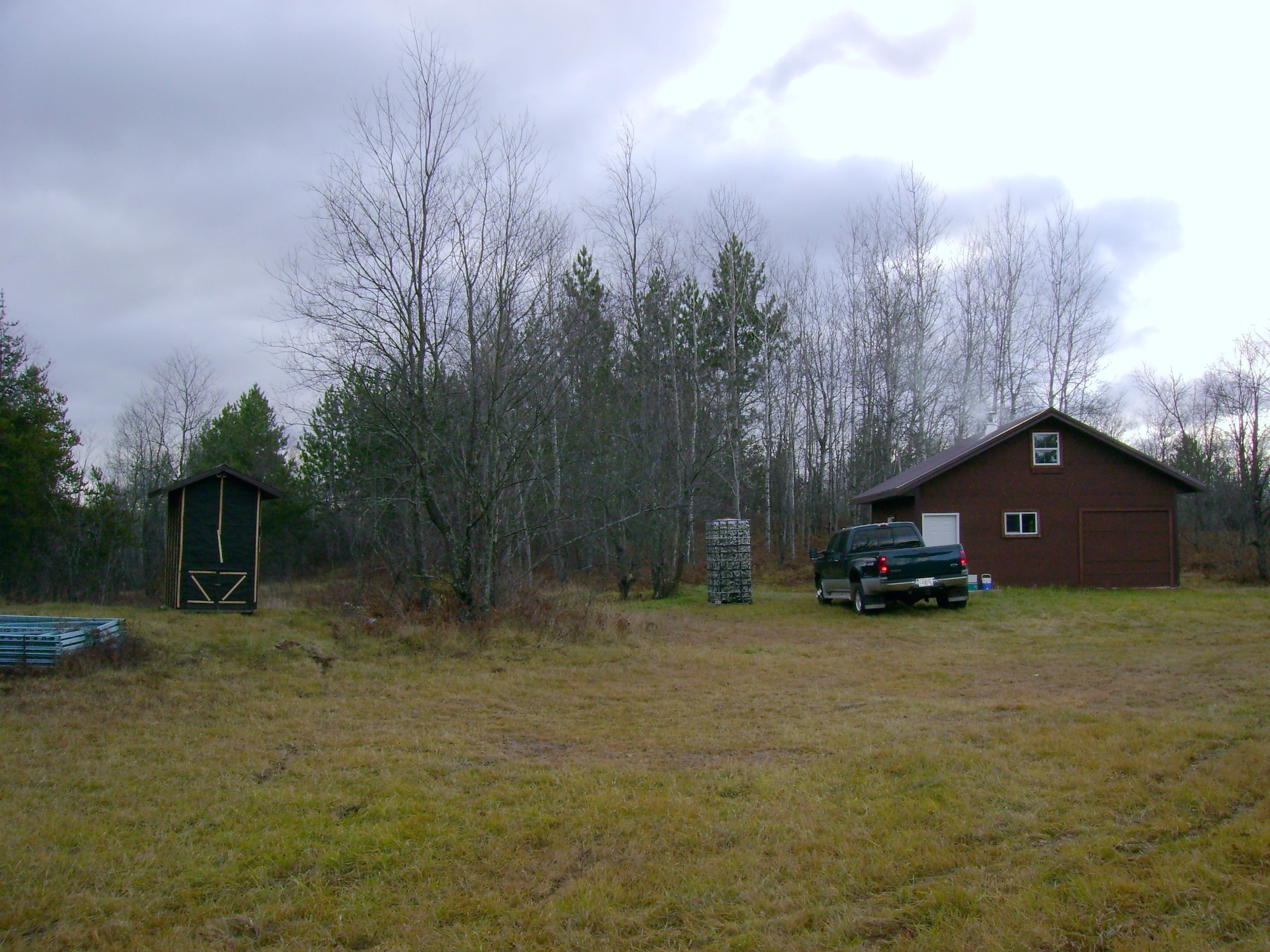

Skip the hydro or solar. Go buy a Honda 2000 watt generator. It's very quiet, reasonably priced at about $1,000 and very reliable.
I went through the same thing about 7 years ago when I built my hunting cabin. Save yourself the time and money. I'm 1,800 feet from utilities and the cost to bring in power was over $11,000.
