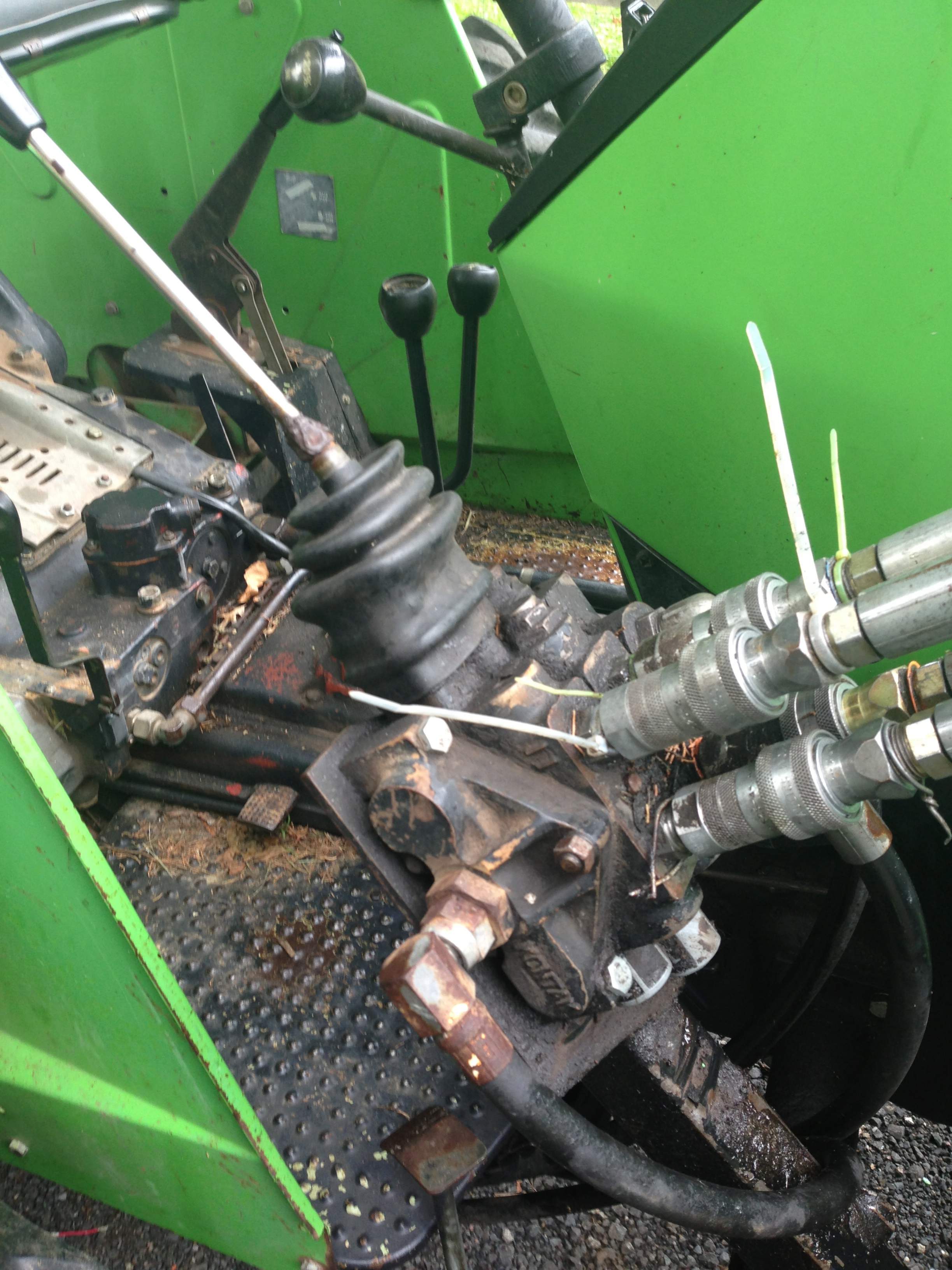

Hello,
I have a deutz allis 6240 with a loader. I took the loader off in the spring to do some mowing. It was off for a month maybe two and I put it back on, since then it has been acting very poorly, like air is in the system. This can affect the 3 point and even the steering. I checked the fluid, I actually had it overfilled after I burst a steering line and replaced it. Today I drained it back down to the proper level. The problems are the same if not worse. The thing is if I disconnect the loader everything works fine. The tree point lifts strong and smooth and the steering as it should. Could something be wrong with the loader itself? I really know nothing about hydraulics so any help would be appreciated.
Dan

Does the hyd for the loader come from the hyd block?
If the loader is disconnected, do you couple the hyd block in and out ports with a short hose?
With the loader installed, the PB from the loader valve goes back to the hyd block.
The OUT hose goes to the return.
The hyd block pressure OUT goes to the IN port of the loader valve.

Hello,
I have really cleaned the quick connects with no luck the thing acts the same. Someone on another thread had a similar problem (different tractor) and cleaned the pressure bypass valve and it fixed it. I will try to do that soon, I need to get a socket big enough to remove it. All the lines run right from the pump to the valve. Their are three of them, I don't really know what is sending and what is a return. I am attaching pictures. I will need to get a pressure gauge i guess unless this clears up. Here are pictures of the pump and the valve to give people a better idea.
/ Hydraulics messed up ONLY when loader is on tractor #9
That block that has the three hoses coming out is a hyd block.
The pump feeds the hyd block and the hyd block probably feeds the loader valve.
The hyd block probably has a pressure port , a PB port, and an OUT/tank return port.
How do you connect the hoses when you remove the valve and loader?
Did you perhaps switch the input and PB hoses at one time?
You can test which port is the pressure feed port by placing that port hose in a bucket and see if fluid is flowing when you start the tractor.
Are there any markings on the hyd block or the loader valve? Do you have 6 or 7 hoses coming off the loader valve? Seven hoses indicate that you have a PB port.

Ok I have messed around with it some more and can say that this thing totally acts differently with the loader attached vs not attached. So the hydraulics are working great, attach the lines. Still working great. Move the bucket, things still seem okay. Lift the loader --- things go haywire. They will stay this way, but if I put the bucket down take off the lines to the bucket, the steering and 3 point return to normal. So there is something when I lift the bucket that messes it up. So that basically three things.
What do you think;
1. Something wrong with loader, its lines or one of the cylinders.
2. Something wrong with valve (this stays on tractor when I take the loader off)
3. Something wrong with one of the quick connects -- even though to my best knowledge they are working.
Guesses? How would I check? I am convinced it one of the three things listed.
