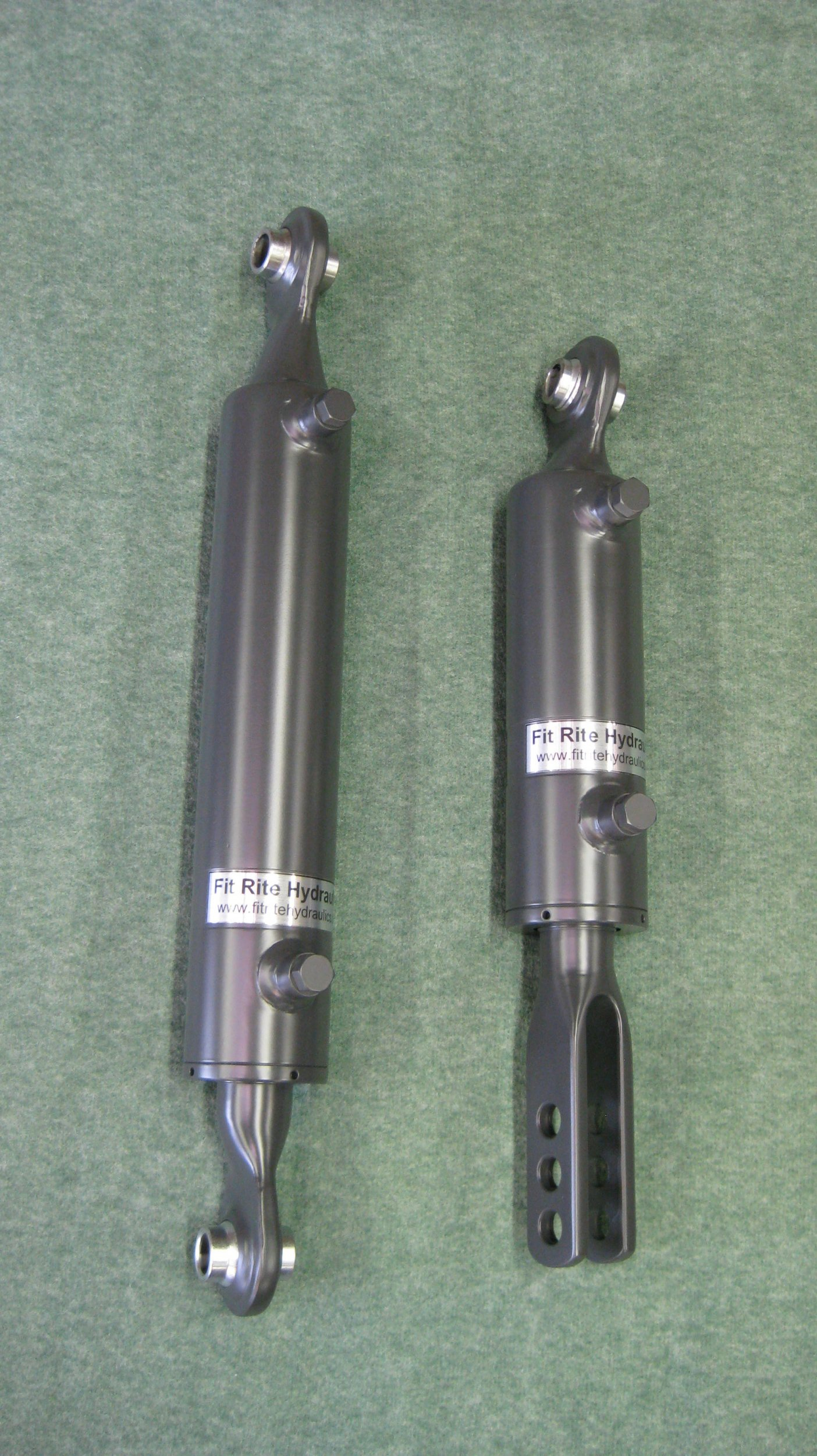

Want to get a hydraulic top link for my L4630. Any suggestions on where to look. What diameter and length should I be looking for?
Typically I would recommend a cat 1 top link built with a 2 1/2" dia cylinder and a 10" stroke having a 21"-31" working length for this model. Similar to the unit on the left in the picture.
   / Hydraulic top link for L4630 GSTC

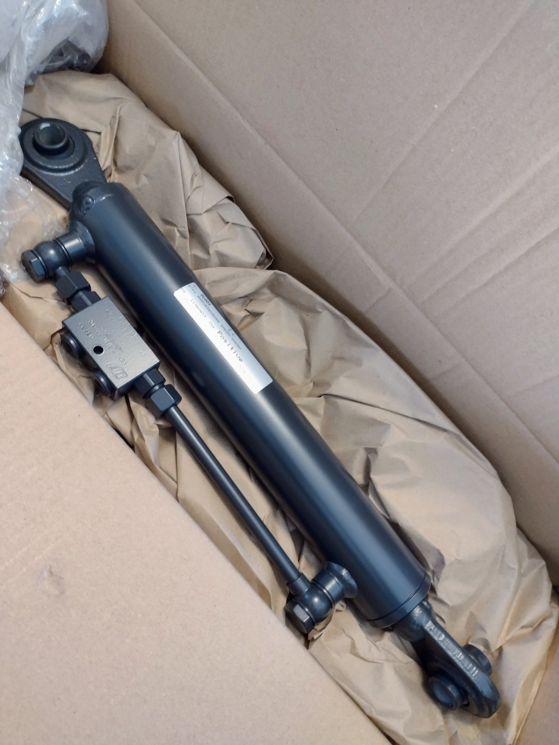

I just bought from AgriStore USA. One day free delivery. Italian made. Tractor Time With Tim did a video on these cylinders. Take a look!
This is a 21-31” stroke. With hoses, shipped, it was about $310

Thus one is made in Italy, sold by Agristore

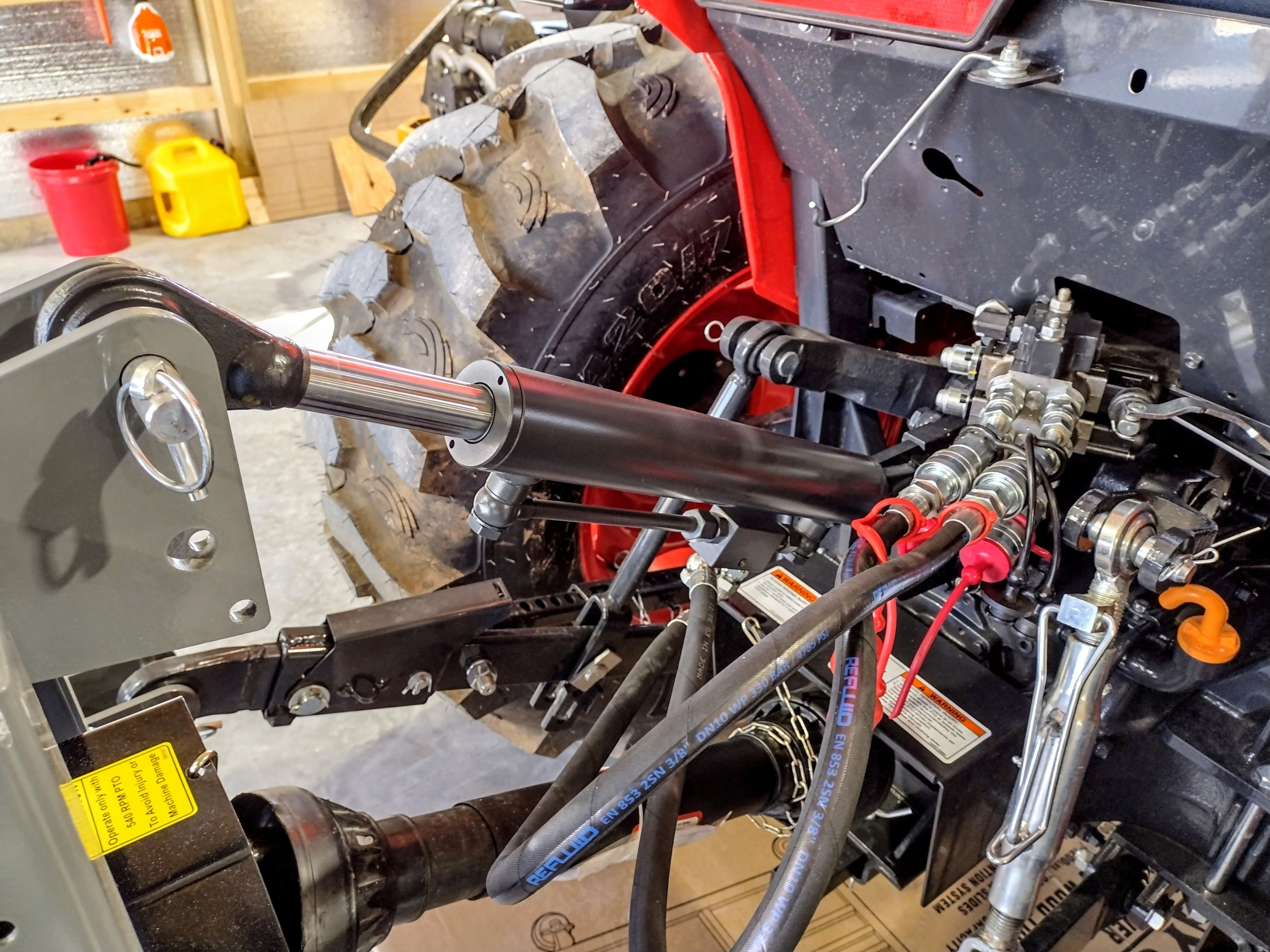

I have a very similar model with the pilot operated check valves. I just never thought of it but I have mine with the valves on top. I guess one of us has their top link upside down. any particular reason why you put yours with the tube and valves down.
I put mine up so that I can rest it on the pto shield when it is getting hooked up without causing damage to fittings or tubes, but I have a quick hitch so that is rare.
Just so every one is aware you cannot float the top link with those check valves on. I like it because it doesn't drift even when the hoses are disconnected.
