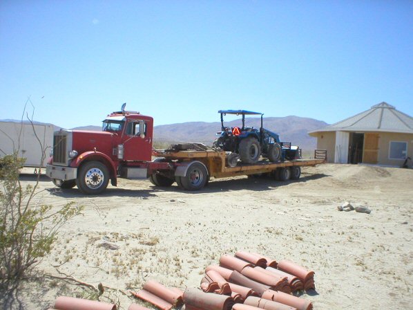

We have a 44' semi pulled trailer and the back 32' tilt down to a 4' stationary section with an 8' upper deck. I don't think that I would ever even consider anything other than a tilt bed after using ours for the last 10 years.
