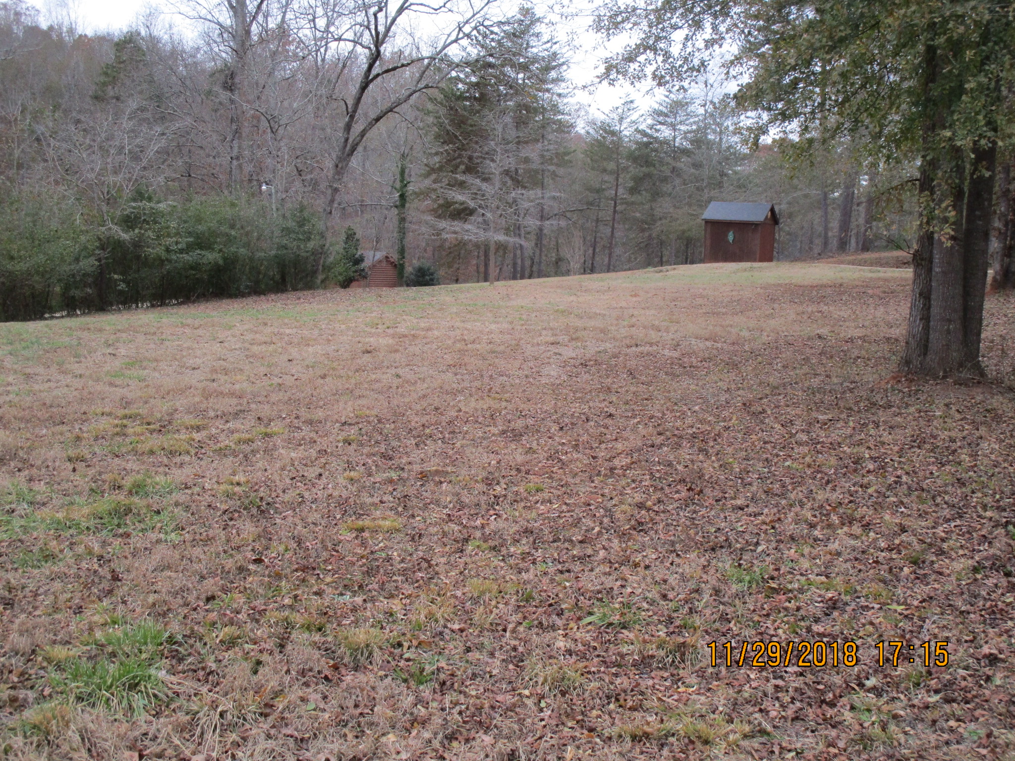

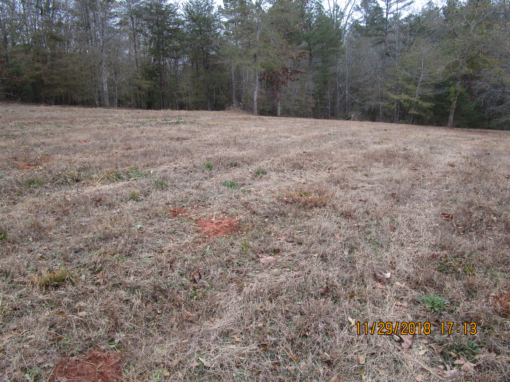

A follow-up after a good bit of work with the Bush Hog. It is dead smooth. I can't tell the PTO is engaged until it snags some good sized brush or it bottoms on a dirt mound. I welded up some splits and cracked welds that I have accumulated over the years. The cut is almost finish mower smooth. I believe I may have gotten away with this after all!
